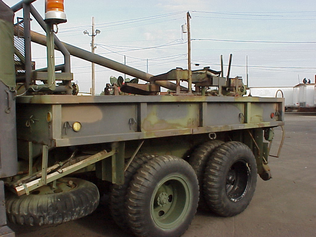

You can see some good pics below:
Pioneer Tool Rack and Tools
The problem with the pioneer tools is that the racks were designed for US spec dimensions and a lot of tools now are made in China, and are not the correct measurements. You can put whatever tools you want in the rack since nothing is brand specific, but...
