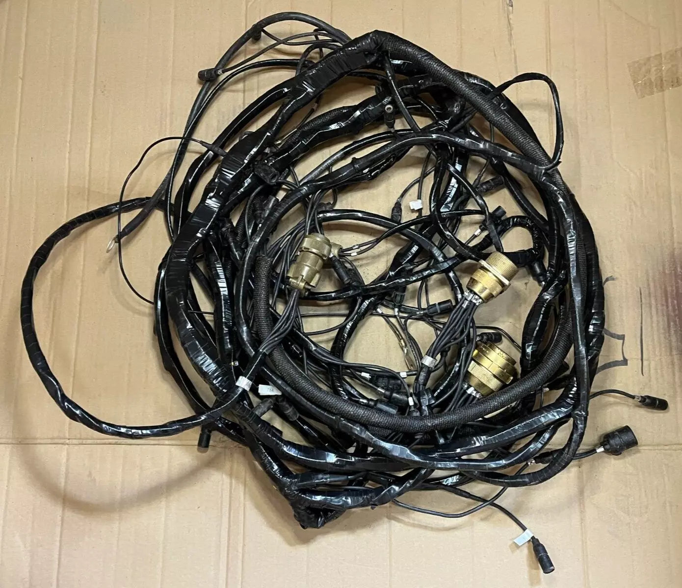

So this is what it looked like before I completely took it apart. The portion of the harness going into the plug that screws onto the back of the signal controller is what I need to rewire. I found on Big Mikes page he mentions making a repair harness for the blinker controller but I don't see it on his site yet. If I can find a used plug with the wires still attached I think that would make things easier. See the pic with the controller i found on eBay. I found a thread on here where a company is making harnesses for 1500.00 but wow.
I poked around on the Classifieds parts for sale and came up empty. Can't help but wonder if you put a "parts wanted" listing. Almost wonder if a complete parts truck couldn't be had for less than the ePay listing that you found...
Hopefully somebody besides me is looking - and has a better idea.

Do you like isometric exercises? Once you find a front wiring harness you will hate isometric exercises. Because to change out the harness you have to remove all the wire holders from the frame that have a bolt and a nut on them. That means you will be under the truck hugging the frame with your shoulders about 1 foot off the ground. There are a lot of those wire holders.
Here is where I got mine 4 years ago:
It is still listed so maybe he has one.

Wow! That beats the heck out of the ePay listing for more than twice the money!!
Great find @Barrman

Yeah that doesn't sound fun at all but at some point I think its going to be a requirement. Have done/ had some much done to this truck in the short time I have had it. Drove it home yesterday from the shop and now it won't start. Waiting on a starter relay to come and hopefully that's it and not the starter. Big Mikes emailed me back with an option and I am going to try that. He has a partial harness with the plugs and wires with the number codes I can splice onto mine. Thank you very much for the link, I haven't seen this company yet. I went ahead and ordered the harness so we will see if it ships. Even if I don't use Im sure it won't be hard to get rid of. I appreciate everyones time as I am still new here and just want to safely put this thing on the road.

And another thing. Be sure to take lots of pic of the existing harness routing and clamping especially at the branches and behind the dash. When you pull the clamps loose put them back on the bolt/stud. If you are replacing them be sure to get them beforehand and replace them as you take one off.

If you plan to keep this truck for a while, replacing the harness will be time and money well spent. You probably know by now that all the wires have an aluminum tag on them. I saw them in your third picture. All M series vehicles use the same numbering plan for the lights and turn signals etc. you could use the wiring diagram for an M37 to trace the turn signal wires on your truck.
The solid State flasher unit (black box on fire wall with three wire plug) is prone to failure without notice. They cost about $50 to replace. I have a stack of bad ones on the shelf. I don’t use them any more. Buy a two wire flasher at the auto parts store (I found one one that is loud when it flashes) ,connect the 24 volt supply wire (will have 24 volts when you turn the signal left or right) to the “X” connection, connect the other wire ( not the ground) to the “L” connection. The third wire is ground, you don’t connect it to anything. Now you have a $12 flasher that you can buy anywhere.

Very good info, thank you
