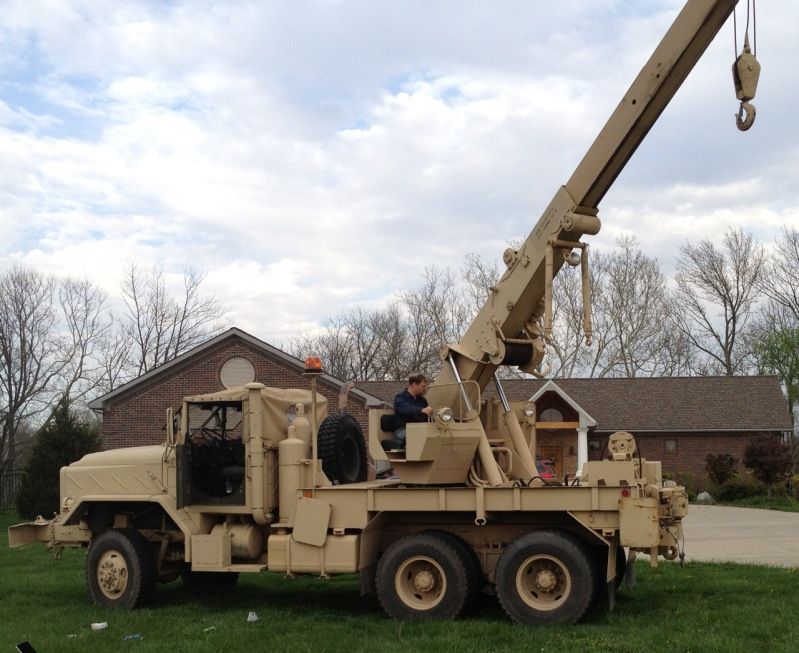

Hey all!
Thanks for all your help and input... we made it up to Lansing about 10:15, saw the truck, checked fluids, got a jump, and she started right up. Drove home couple hundred miles... and she ran like a champ. THIS THING WAS FULL OF STUFF, even had a radio antenna, 3 hammers, HUGE bottle jack, massive chains, tire chains, tow bar, and lots of rigging pulleys etc. Tom up in Lansing was a great help too...
Got her home and checked systems... only two things... middle boom spot light doesn't light (bulb?), and we can't seem to get her in low range? We're reading the book to see if we're not doing something right...
Thanks again... NOW to find some single rims to move up to super singles....
Thanks!
