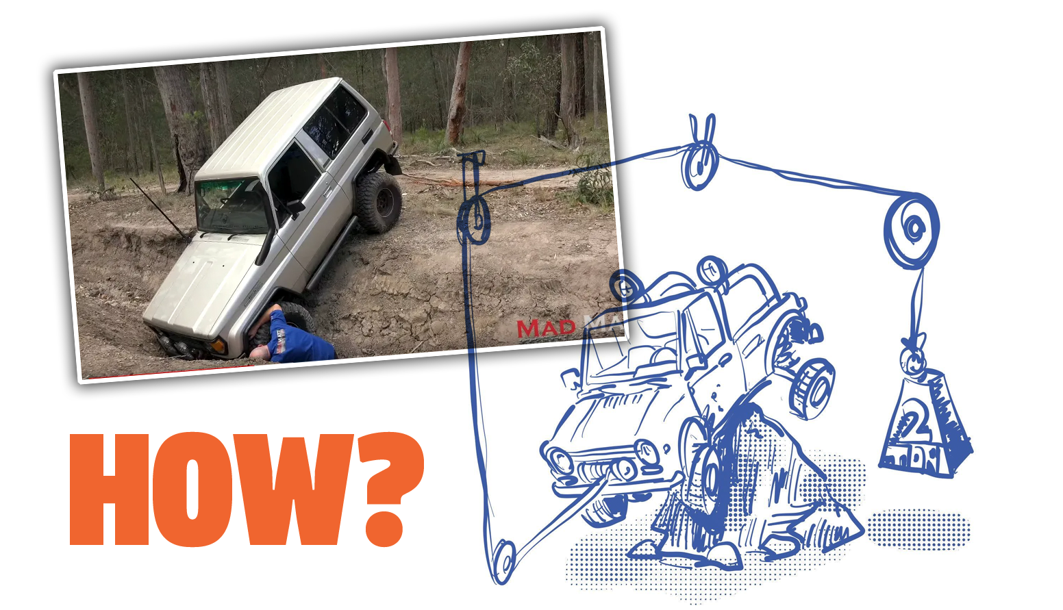

If you carry enough pulleys and some spare winch line, you can usually find a way to winch yourself out in any direction (provided you have something to hook your winch line to.)
of course, most of my driving is in the forest, so plenty of trees to use if I need to hook up to something, but biggest thing is I never go out by myself.
example:
