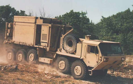

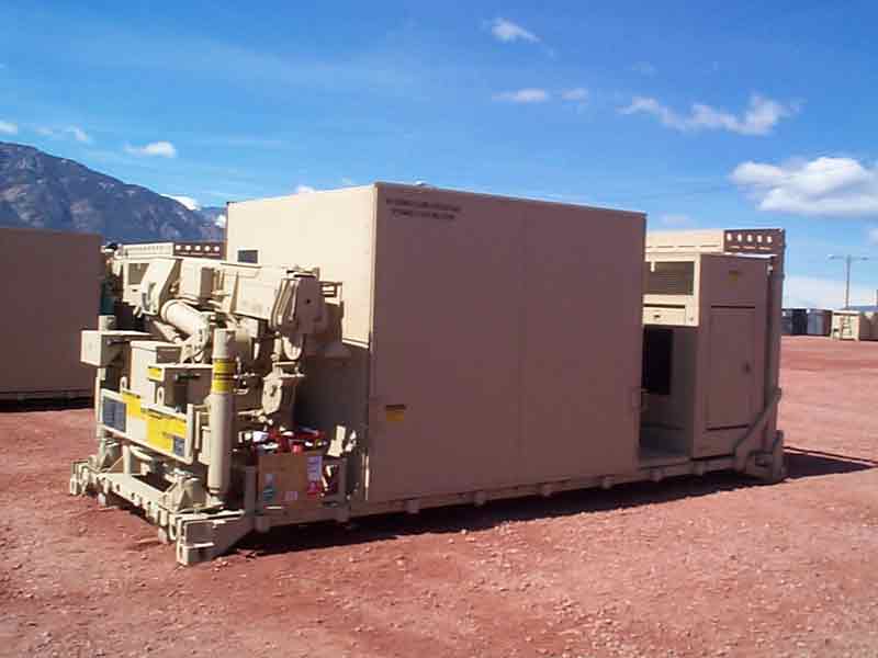

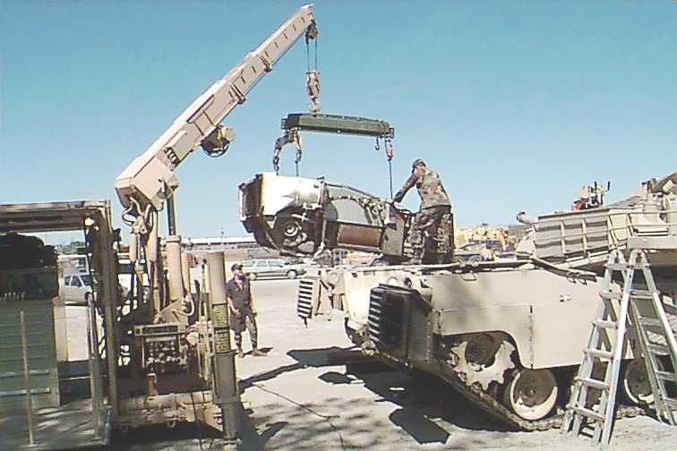

Then there was the FRS Tool kit.
An Expando trailer,
The FRS (Forward Repair System) is a maintenance shop on wheels. With its on-board crane, air compressor, 30 kilowatt (TQG) tactical quiet generator, welder, and full compliment of diagnostic and hand tools, the FRS's two person crew will be equipped for almost any maintenance task. The FRS Technical Manual is TM 9-4940-568-10.
The FRS can replace a power pack with ease and get it back in the battle, quickly. No need to drag the vehicle back to the unit collection point.
Carried by a PLS (Palletized Load System), the FRS will go where the M1 tank goes. The PLS has the power and speed to keep up with the pack.
The FRS is built on a PLS flatrack and can be on the ground and operational within 5 minutes of arrival.
(Information taken from the Picatinny Arsenal's FRS page.)
