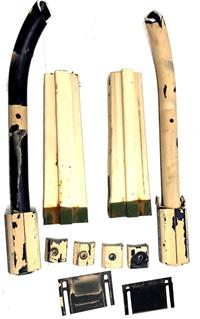

I am missing the blocks with the bolts for the tubes to hold the seatbelt to the tube

Ok need help with sponson questions
My passenger side is nos, what do I do about this gap? I had made a gasket from rubber but it's thin 20210227_124134.jpgnext question same sponson, is this small hole below the tube 20210227_124349.jpgsupposed to line up with something, this is a later sponson with the seatbelt bracket already built in
