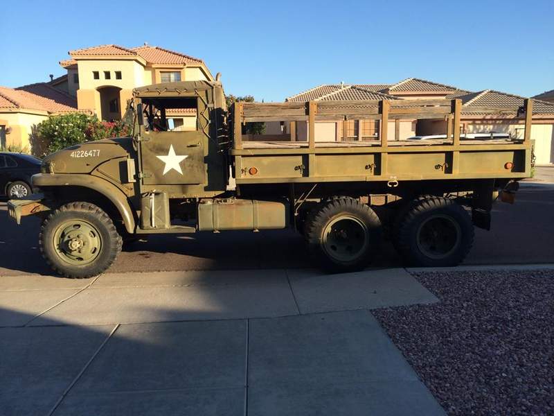

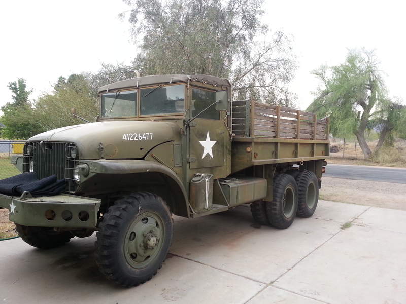

I've been wanting a Deuce for years and I have a buddy that works liquidating estates. A few months ago he comes over and tells me he has an estate to work on with an old Army truck stuck in the pasture but he only had 3 days left to inventory the estate and move everything to the warehouse.
We drove out to the property and sure enough there was the big old MV sitting in the pasture sunk a foot into the desert soil from 10+ years of sitting though monsoons and wind. To add insult to injury the truck was in a position where we couldn't get the trailer or a tow truck close enough to her. She was going to have to get herself out of the mess and climb up onto the trailer under her own power or at least get close enough to put the winch on her.
I checked her out bumper to bumper and everything was there, I couldn't see anything that would stop her from running. I went home, called work and took vacation, read nearly every thread on this site, downloaded the TM's to my notebook, grabbed the wife along with every tool I could carry, and off we went to get the big truck started.
Day one, we cleaned up the fuel system, installed the batteries, checked all her fluids, got her to crank over but no start. External fuel pump bolted on the frame rail wasn't working and by then it was dark so we called it for the day and went home worried and disappoint.
Day two, we got their early with fuel pump in hand and got it installed but still no start. I went through all the systems and started to get a little frustrated, I had compression, fuel, air, and spark but still she wouldn't light up and I mean not a backfire.. Nothing.
I will never live this next part down... My loving wife had been reading the TM's while I worked her and said did you read the book? It tells you how to start it... I barked at her.. something about I don't need a @#$% book to tell my how to start a truck. WELL.... She pulled the choke 3/4 of an inch, gave the throttle knob a pull out a couple clicks as instructed by the TM and wouldn't you know it black smoke came puffing out the exhaust and she was coughing as sputtering like an old man (me) waking up in the morning. I rushed over and gave her a short squirt of starting fluid and that's all she needed to get back on her feet.
Now when ever I'm heading out to take her for a drive my wife pops off, "Do you need me to start her up for you"
The Lesson: Read the TM's cover to cover because you can never underestimate the curiosity of a women when it comes to these trucks.

cool truck , looks like the sheet metal is in nice shape . I think the wife is going to be a LITTLE hard to live with after that !!!! LOL , some things they NEVER forget ! good luck on the ride , I think you got a deal and a half ! bob k

That is a super dry and unmolested looking truck. Lots of congrats to you. Did you happen to take a pic of it as it sat for 10 years? It's first move in 10 years would have made one heck of a video.
