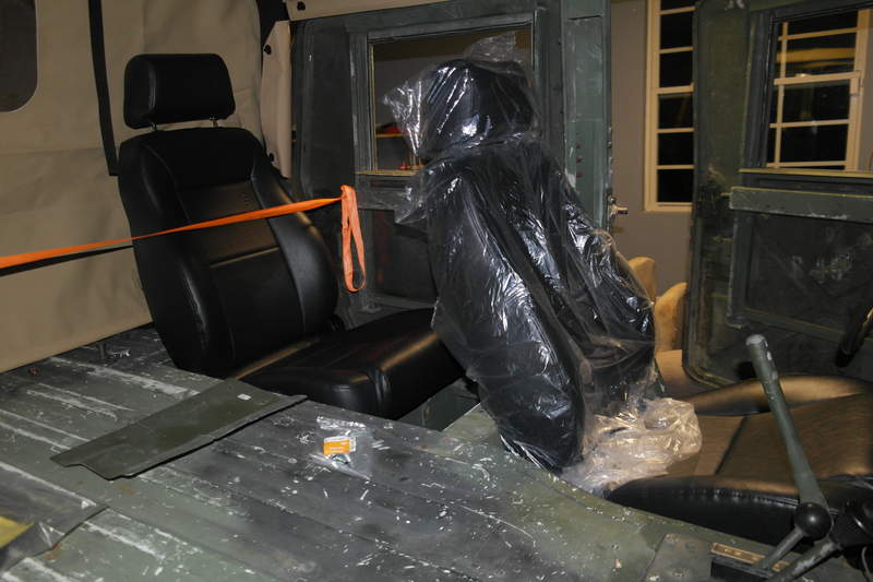

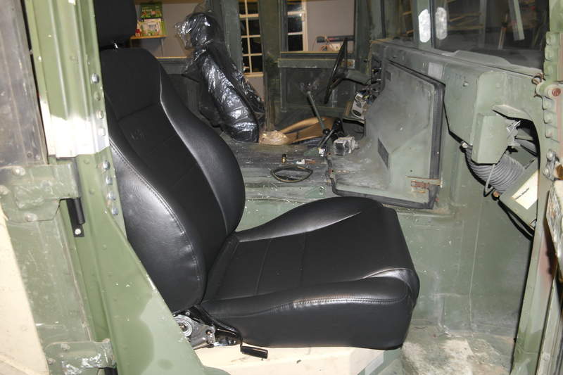

Got the truck a few months back and so far made a minor comfort upgrade and got some things done on the truck, if anyone has run into an issue with too much white smoke put your two cents in the jar, new glow plugs so I'm thinking injectors or advanced timing?

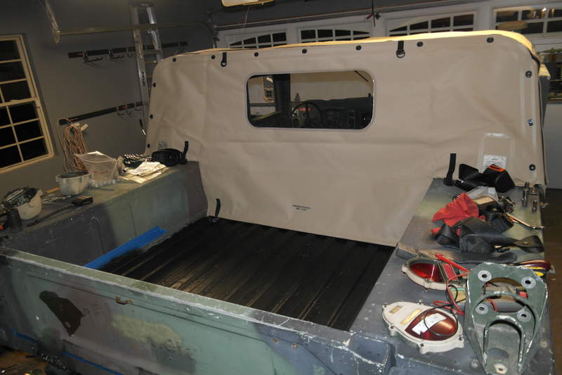

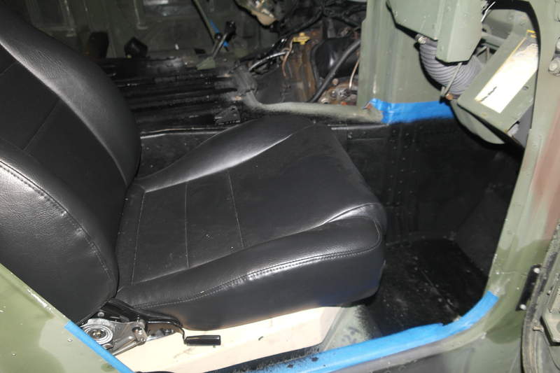

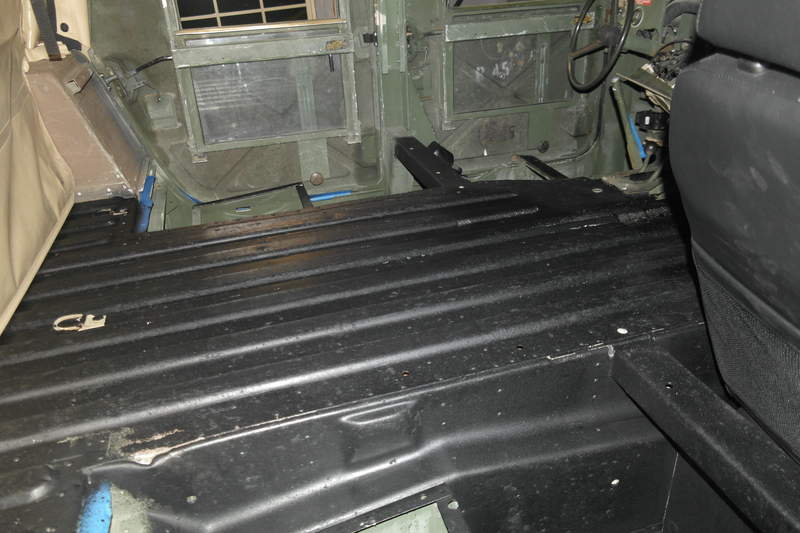

Laid down some bedliner on the inside and the bed, got all the injectors changed out smokes a lot less but still has too much smoke in my opinion at normal temps. I think next I will look into injection timing
