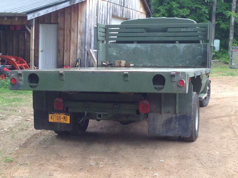

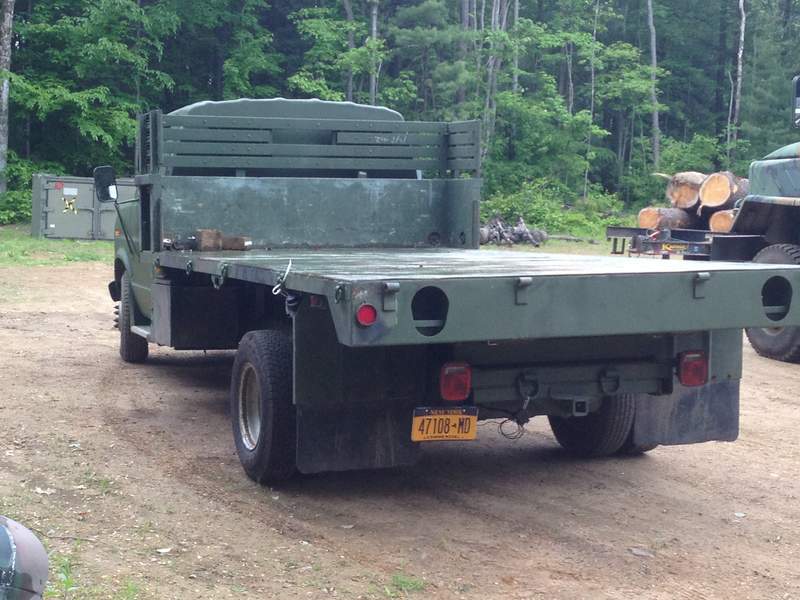

So over the last couple days, I got the new Catalytic Converter in, made a HUGE difference. Also got it registered, weighed (7550 lbs empty!), and first run to NAPA; gotta break it in right :-D
Also got the OE mudflaps mounted, I think they look awesome!

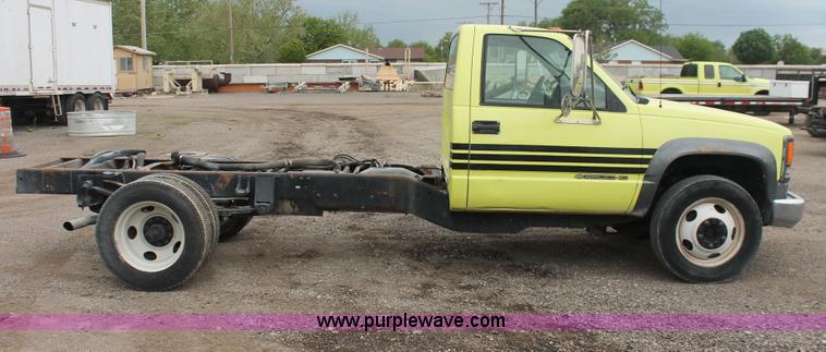

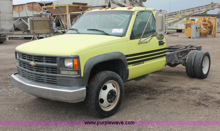

Hey Wheels, what is the lenght of the 923 bed? Any triming on the bed or frame to make it fit?
wheelspinner
3,754
1,539
North Carolina - FINALLY !
No mod at all to the 14 ft bed except removing the sides. This was originally a 178" WB truck so that might impact the project for someone else. Also this truck had 44" frame rail width so I had to install the cross bunks to come into the width of the bed rails. Overall a really easy project for the most part. Thinking of one?

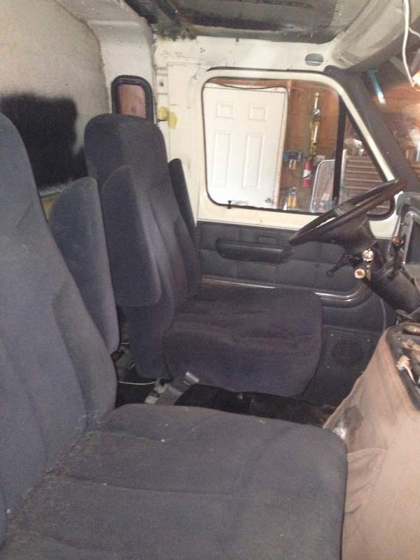

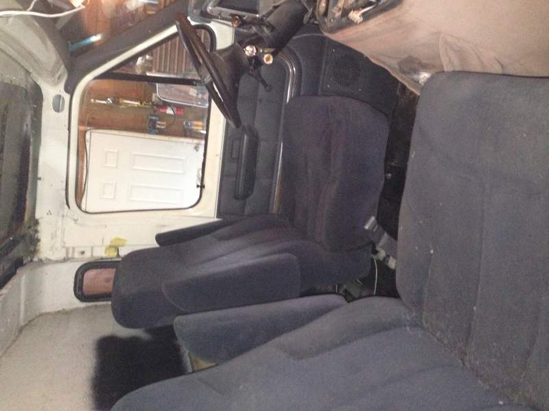

Seats.jpgWell got the new to me seats in and raised them up about 1 1/2 inches. They are much more comfortable then the old RV couch chairs and look a little better. Double special bonus today was I got the heater blowers working and the AC blows nice and cold also! Good day today.
edit: Fixed the pic but can't delete the sideways one......
