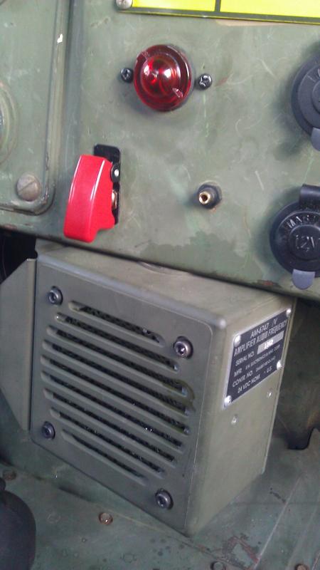

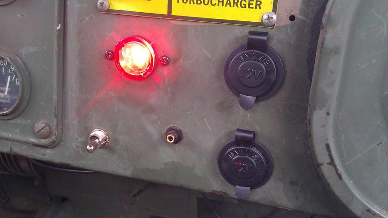

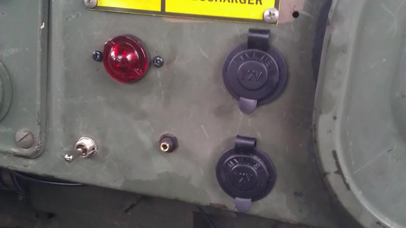

Added another 12v outlet and a power indicator light for auxilary electrical
Ordered an N.O.S. dash light from eBay and installed it in my dash with a clear red lens to use as a "power on" indicator light. JUst an extra safety precaution to be sure I don't accidentally leave the toggle switch on and drain my battery.

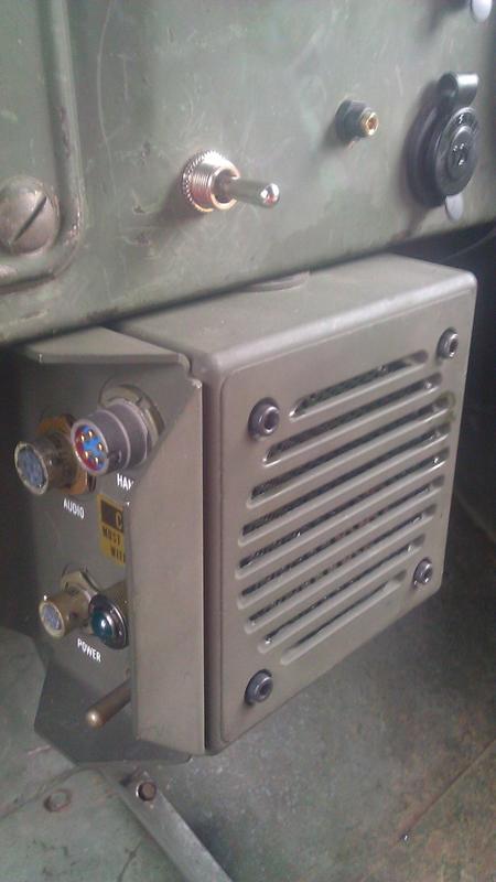

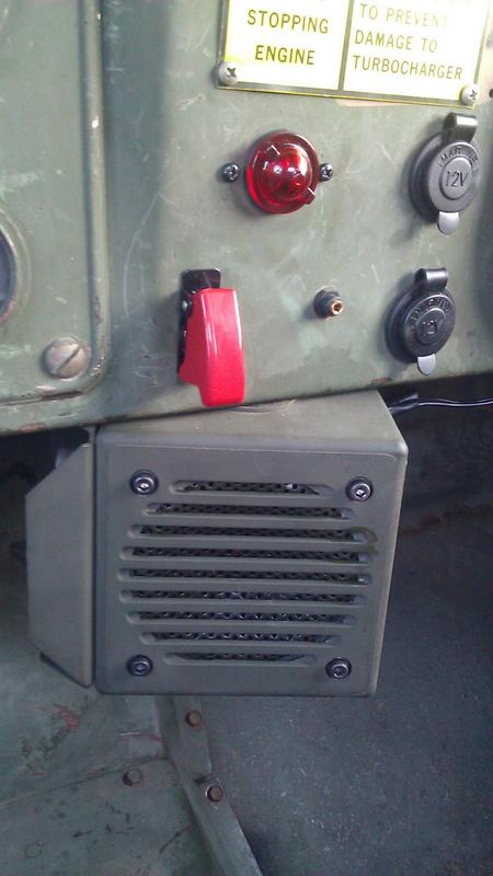

I modified an AM-6747/U loudspeaker to use with my iPod module
Ripped out the guts and replacem with a new 4 1/2" Pioneer 2-way speaker. Working on turning a large ammo can into a speaker box with two 6 1/2" Infinity speakers now. Also, thinking about adding annother AM-6747 under the dash.

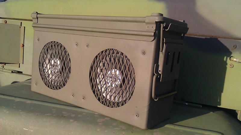

Ammo can speaker box is complete!
I just added a new speaker box behind the passenger seat. I modified an ammo can with two 6.5" speakers and expanded steel speaker grills. This box fits perfectly behind the passenger seat in my M35A2 after unbolting the seat from the floor to get the box under the rear seatframe. The seat frame actually holds the box in place against the back wall of the cab, preventing the box from bouncing around or being stolen.

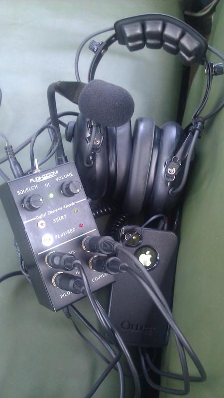

Flightcom aviation intercom for the Deuce
I picked up a used Flightcom brand aviation intercom to use in my Deuce, so I can actually have a conversation with a passenger at highway speeds. This portable unit accepts general aviation headsets, runs off 9 volt batteries or a 12v power outlet, let's my play my iPod, and will event let me take calls from my cell phone. Highly recommended option for anyone interested in an intercom system for thei Deuce!!!

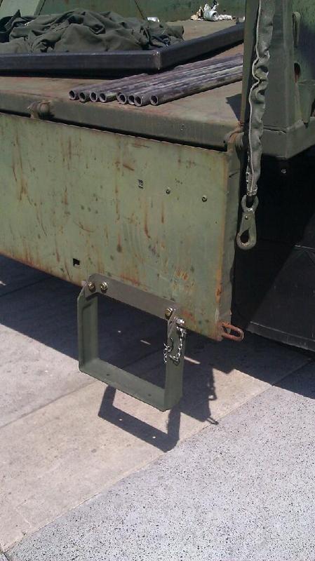

Hoop step on tailgate of my M105 trailer bed
Added a folding hoop step to the tailgate of the M105 trailer bed on my bobber. Drilled and tapped the tailgate, and then bolted it right up. Really helps with climbing into the back of the truck, and folds away neatly when not it use...
