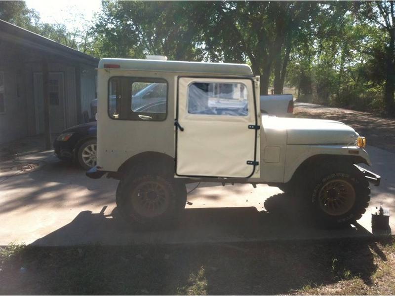

I'll check to see if I also have a pair of rear soft skin doors. Take the rear half of the rear door and mate it to the front half of a front door and you should have a hole pre-bent tube door in need or a little fabric work.
Copy and past the rear door up to the side of the jeep as well please to see if my thoughts hold water.

Just a suggestion - check the dimensions of a M151 soft skin door and compare it to the door opening you have on your Jeep. The MUTT door might work for you, but you'd have to modify the driver's side to eliminate the opening for the fuel tank neck.

yep doors were one of the big problems i had. now i think i may have that solved. i have decided to keep it left hand drive so that makes the list shorter to finishing the project. i will be trying to find a 1/4 ton trailer when i get done but that is a while down the road. trying to decide if i want to keep the current rear lights or change them over to M series tail lights. was going to start doing some of the rust repair but my sears wire feed welder died. time to upgrade maybe. like any other project lots of stuff to do and decisions to make. thanks for the help and God bless

the m151 mutt doors are too short. the m151 has a lip at the floor board that the dj5 does not. i could put in a panel at the bottom to match but it would make it difficult to get into the jeep. its taller to the floor now . i had looked at that but the hmmwv doors are a closer fit due to the lack of the side panel on the floor board

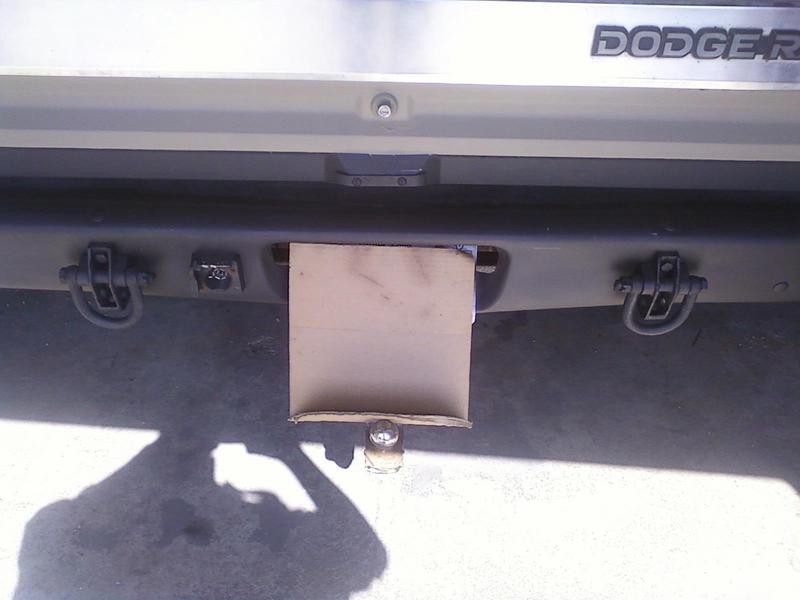

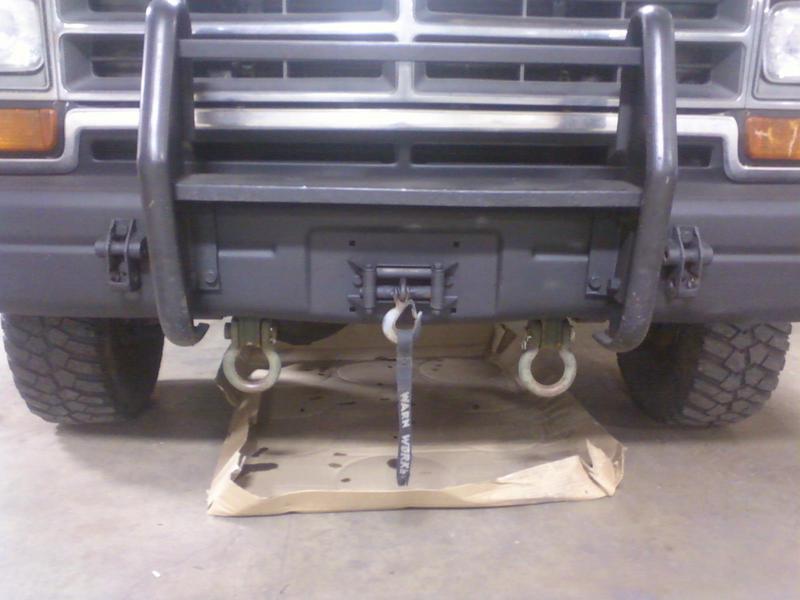

You going to do bolt on shackle mounts light the ones in picture one, or weld on ones? I have a few pairs of hummv front and rear shackle mounts left if your interested. Those are the hummv mounts with shackles in the picture, bolted to the bumpers on the xm889.

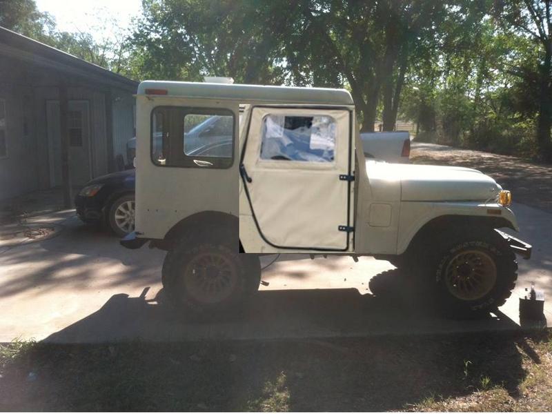

Cool project! Have you thought about a pair of CJ7 doors? They are basiclly welded rods covered in vinyl. You could reshape them to fit and have canvas covers made for them. They also just lift off if you don't want or need them on. Not too spendy at swap meets or ebay. If memory serves, the latches are also just plastic paddles and don't require any hardware on the body. Good luck with it, post some pics when you're done.:beer:

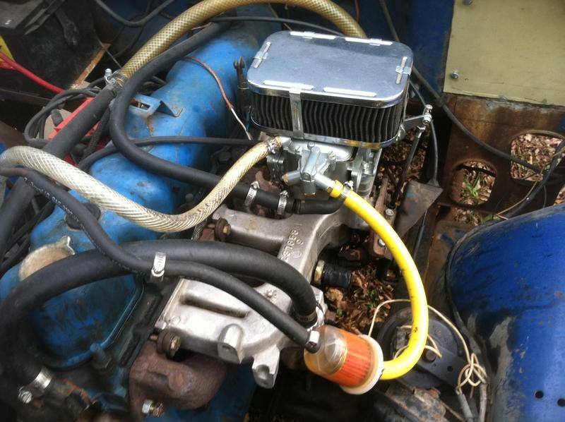

time to update the post a bit. I have a new carb installed on the jeep 258 2 bbl manifold, as well as a HEI distributor. you can see in the corner of one pic i have taken out the old heater and am preping to put in a NOS military jeep heater. have not had time to fix the doors but will before spring. next is the steering box. i have a Mercedes OM617 that has been offered to me and i plan to put in the jeep this spring. I am going to put a 700r4 trans behind it. If all goes well i will have it to the auto body guy this spring.
