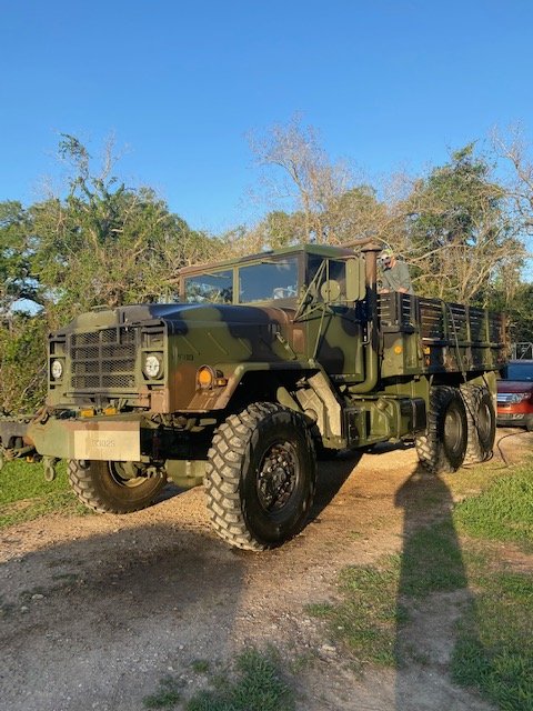

THANKS for adding me!! Picked up this rig a week ago. 1990 M925A2. Overhauled in 2010. Had 70Hrs and 1395mi. Came with issued items that I know of still new in tool boxes, plus all bows and canvas bed cover. Also got the M105 trailer with top and bows. It made the 100 mile trip home but have a few bugs I need to work out with the air system and/or CTIS system.

First place to start troubleshooting would be to crank the truck, let it build air - then listen from under the truck. If you happen to have a shop air compressor, attaching a glad hand and air line to the front driver's side will air up the truck with no noise. If you don't hear air leaking then you need to break out a spray bottle of soapy water. The CTIS hoses (possibly behind the "hub caps") need to be sprayed. All those hoses under the truck may need your attention too...

First thing it was doing is not building air at idle. was only getting 50psi at the compressor. Pulled the head and resurfaced it at work, cleaned up the unloader, lubed the soft parts and made some new gaskets. Works great now!
My next problem is all my tires aired down to about 20psi while driving. I posted about it in the 5 ton section.

One small thing... You had your lights on - Right? The light switch seems to be tied to CTIS and that is how that system is energized. You might want to look at the Spicer troubleshooting guide or the military CTIS diagnostics are in TM9-2320-272-23-1

I did have the lights on, I figured out the hard way that there are no brake lights or blinkers without the switch on stop lights or headlights. I did not know the CTIS was tied to it. 10-4 on the troubleshooting guide. I will be reading up on it. Thanks

Sure a nice looking truck! When I saw it the very first thing I thought about was the CTIS and what a PIA they can be, then read your post and was not surprised in any way! Take your time on it and be thorough in troubleshooting then when you get tired of all the messing around there is a CTIS delete kit that you can buy and troubles are over!
Fine looking truck though!
