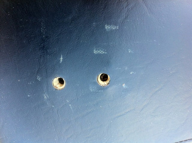

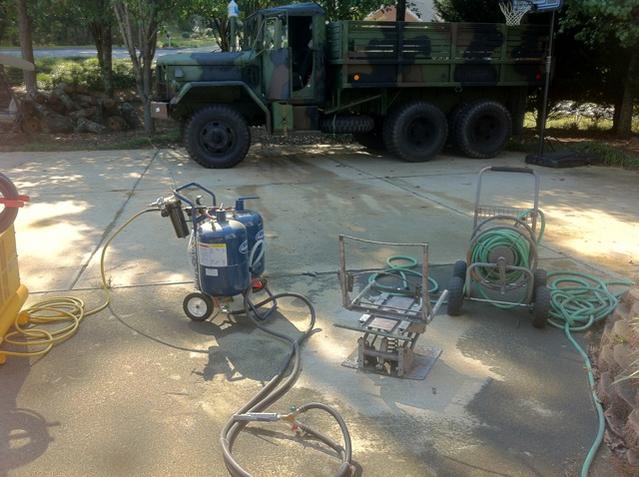

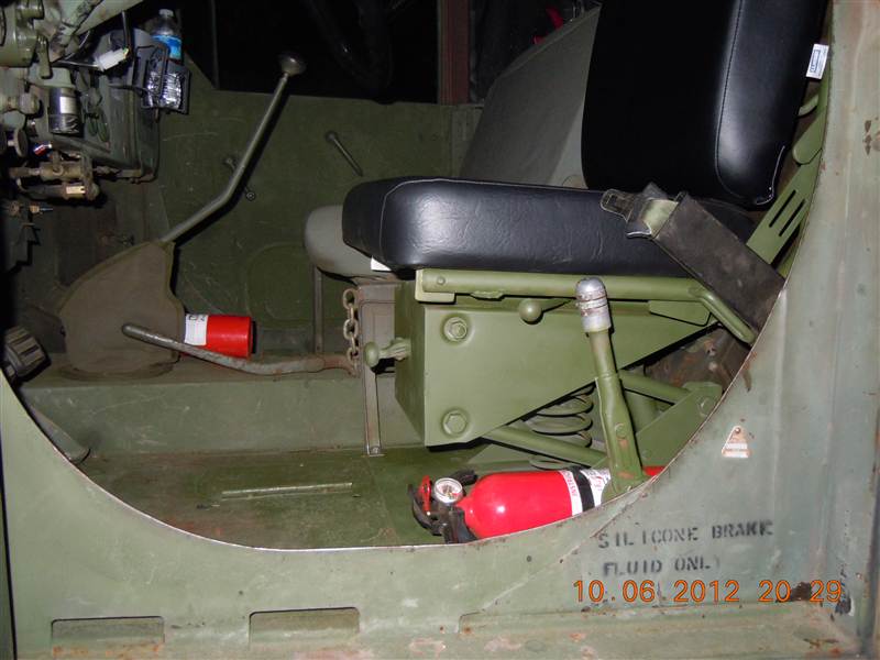

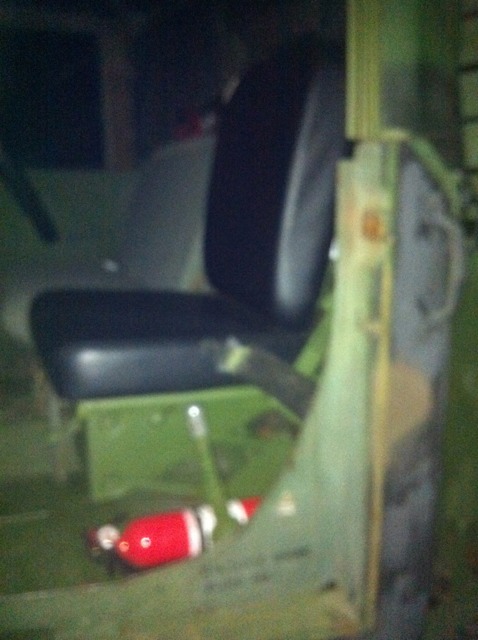

The new springer seat cushions that I ordered from Memphis arrived on Friday. They weren't straight replacements so I had to do a few modifications to make them work. I decided to go ahead and sandblast the springer seat base and repaint it while it was out. It turned into a long day but I like the results. It's a big improvement over the worn out old seat cushions that I had. ImageUploadedByTapatalk1349568462.759650.jpg
I had to add these 5/16" brass inserts to mate up with the frame back.
My iPhone crappy photo of the completed job. I also blasted and painted the cab floor under the seat frame to eliminate some rust there.

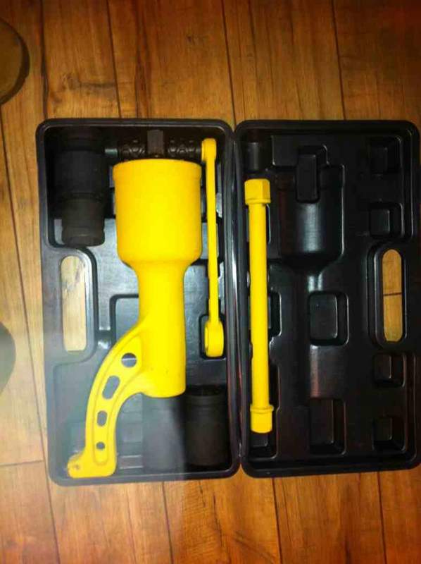

I bought one of these 1:78 geared lug wrenches a few days ago. I had my doubts, but I tried it out on a couple of lugs on my deuce this evening and it worked like magic.
The shop that did my tire change must have used a King Kong impact wrench. My 1" pneumatic impact wrench wouldn't even begin to spin them off. This geared lug wrench with only moderate effort popped them loose. No sweat.
If it proves to be durable, I'll be very happy with it. It seems solid and well made. I'm hoping that the internal parts and gears holds up to the hard use I'll subject it to.
