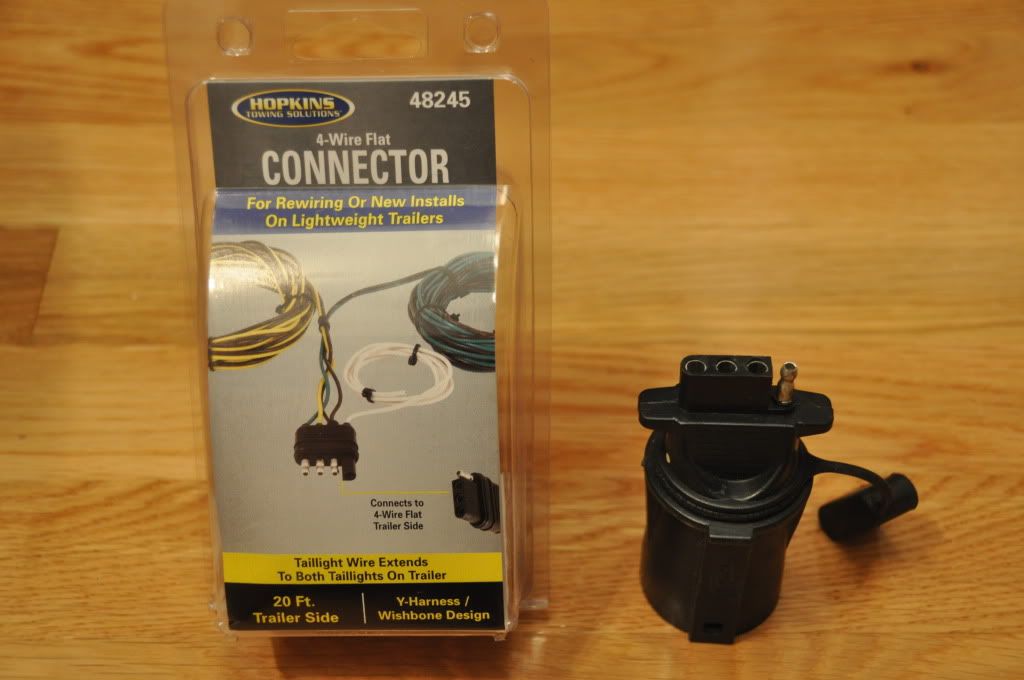

Yes, I could/should do it on site, but I wanted to be somewhat prepared before I get there. Here is what I came up with. The Explorer actually has a 7 conductor round connector (for electric brake pop-up camper that I have) and I have a "7 round to a 4 flat adapter". I purchased a trailer rewire kit at Wal-Mart and cut the wires to around 6 foot length (hope that is long enough). I then crimped my Packard connectors (female) onto the end of the cables. Its easier to show you....
Here is the rewiring kit and the "7 round to 4 flat" adapter:

Looks good! What is the 5th connector for? FWIW, bullet connectors also interface with packards but lack the water tight seal. Should be plug and play once you get there. Bring something to clean off the metal tags with the wire numbers, they can get pretty funky.

Where did you get the adapter?
By seven conductor you do you mean one center conductor and six blades in a hexagonal pattern around it?
yellowrubicon
Montpelier, VA
Yes, exactly. Same connector that you would use if your trailer has electric brakes. I got the adapter at a towing specialty store that specializes in custom trailer hitches. Should be able to find them just about anywhere.

Adapter
That RV 7 plug to flat 4 adapter can also be picked up at Wally, Napa or any of the parts stores that sell towing gear. Run about $8 at the local wally-world.
