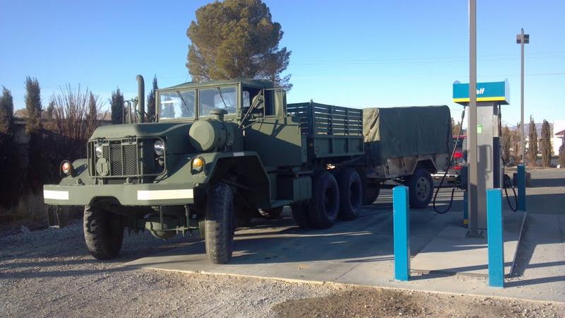

hannibals green twin.... i like all the mods you have done... gives me some ideas
:driver:[thumbzup]:grd: I take it that is one of Hundy's creations? Lookin' nice. Can't tell in the pics, but is that a solid green or 3 color camo soft top? I'm looking for a solid green and Erik's is out of stock and he doesn't know if he will get more.

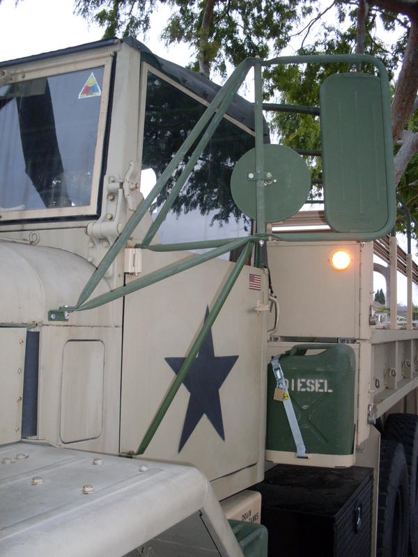

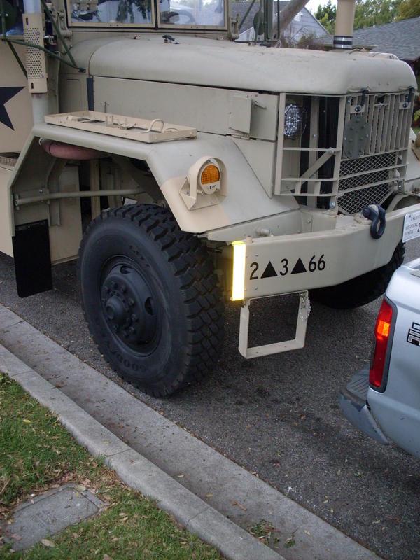

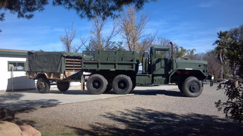

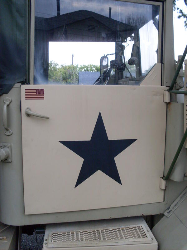

I finally had some free time to tie up some loose ends and take pics of my latest work...

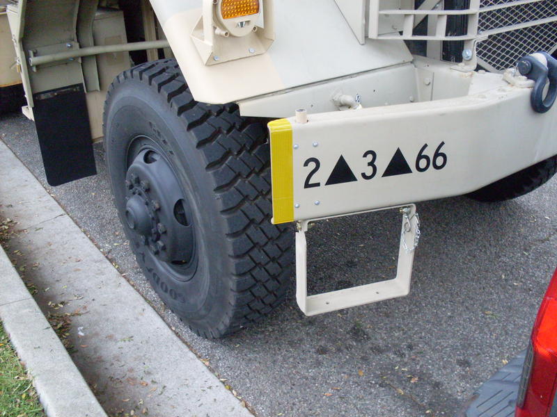

Pics 1 & 2: Brand new bumper step kit installed on right side...gives me one on each side now.

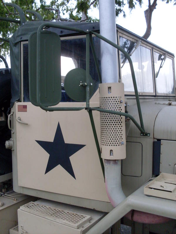

Pics 3 & 4: All new mirror kit installed on both sides.
Pic 5: New passenger side door to include a new window regulator.

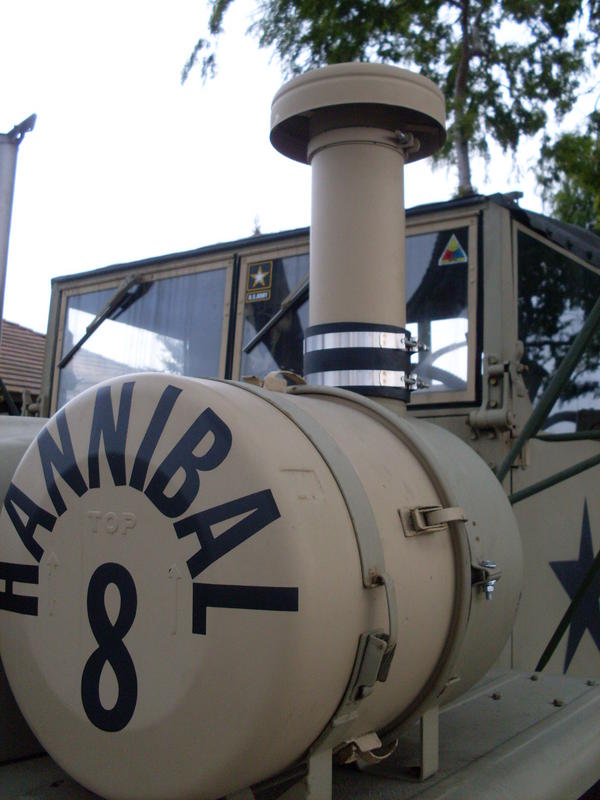

Pic 6: 12" extension and new Donaldson inlet cap on air cleaner assembly.

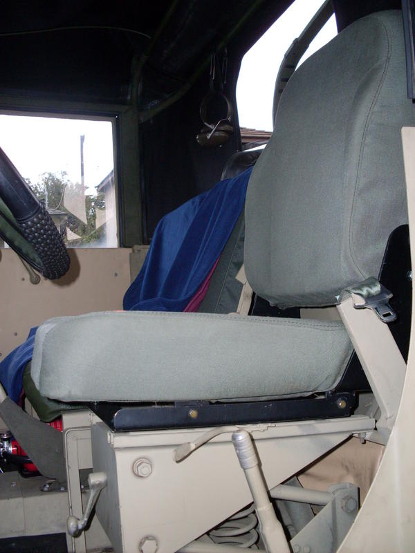

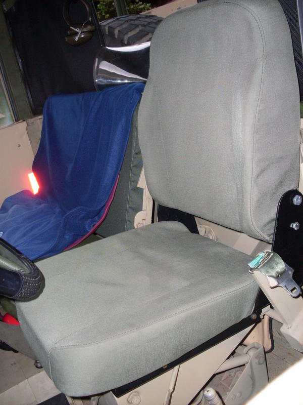

Pics 7 & 8: FMTV style seat installed on standard springer base...much more comfortable.

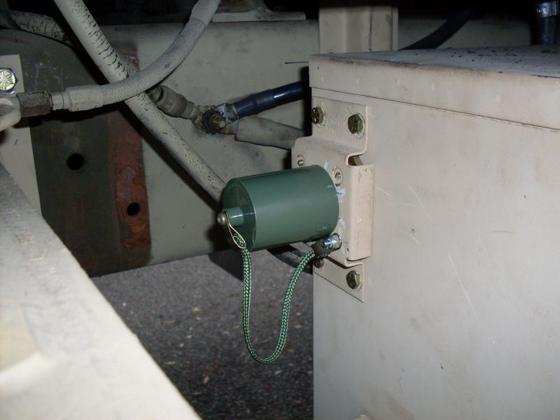

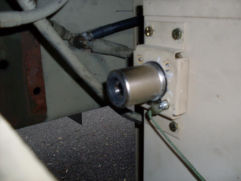

Pics 9 & 10: NATO Slave plug kit installed on new battery box.

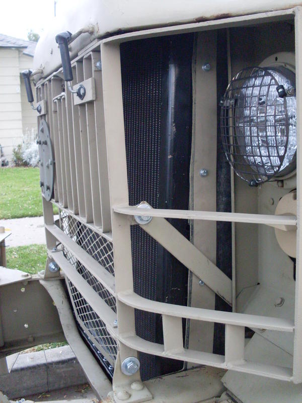

Pics 11 & 12: I had my radiator rebuilt, new core, new hardware and gaskets on both tanks and a quick coat of black paint...no more burning maple syrup;)
Enjoy...more to come soon....

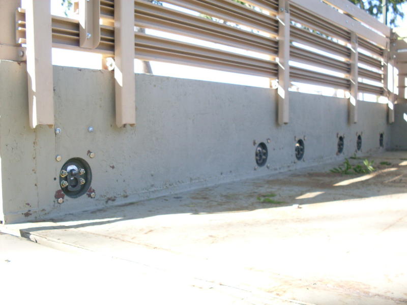

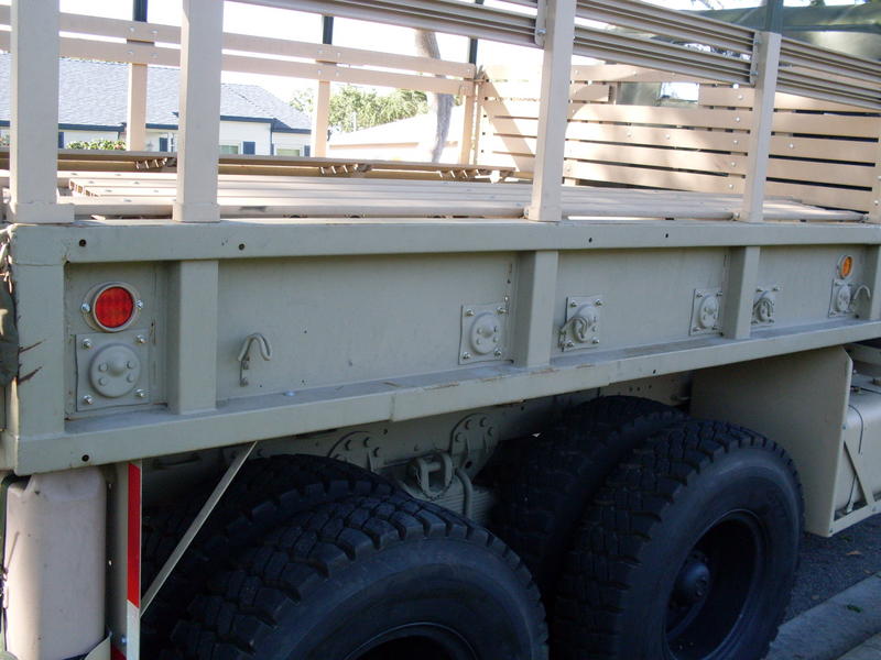

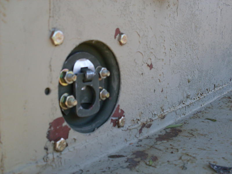

New Bed Tie-downs
On St. Patty's Day weekend I installed 12 recessed bed tie-downs. I bought two six packs of NOS tie-downs from Coleman's for $12.95 a pack. As I do not own any welding equipment and my skills are lacking, I attached the tie-downs with all Grade 8 hardware. I cut 12 4" holes with a hole saw to accommodate the tie-downs. The first cut went bad and tore up my hole saw. I cut into the weld that runs just above the bed floor:doh:. Well, I regrouped and made the rest of the cuts about 3/8" higher. No more problems. The only other thing I had to do was move the side reflectors up above the end tie-downs. All in all they came out nice and I like the new look.

Thumbs up Brian!:beer: Hopefully the neighbors didn't mind all the noise while cutting them holes.
The neighbors don't sweat me at all. I store the truck off site,
I just don't have the real estate to keep it home all the time. So, it's kind of a novelty when I have it home.
The hole saw sure made a heck of a racket even with the cutting wax I put on the blade.

Today I installed all new seat belts on the driver and companion seats to spec. The companion seat now has two individual seat belts. I was not satisfied with the original set-up.

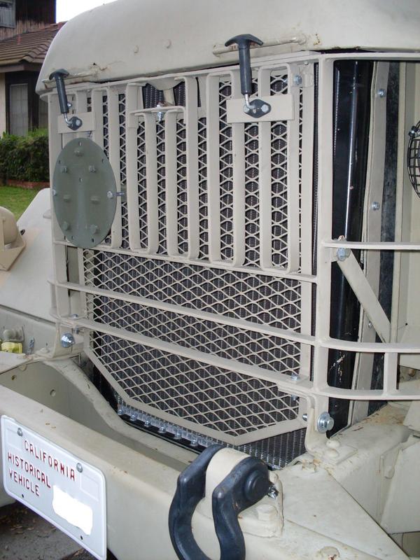

Tomorrow I am going to finish, and hopefully install, a front grille license plate holder I am fabricating from 1/4" aluminum plate stock.
