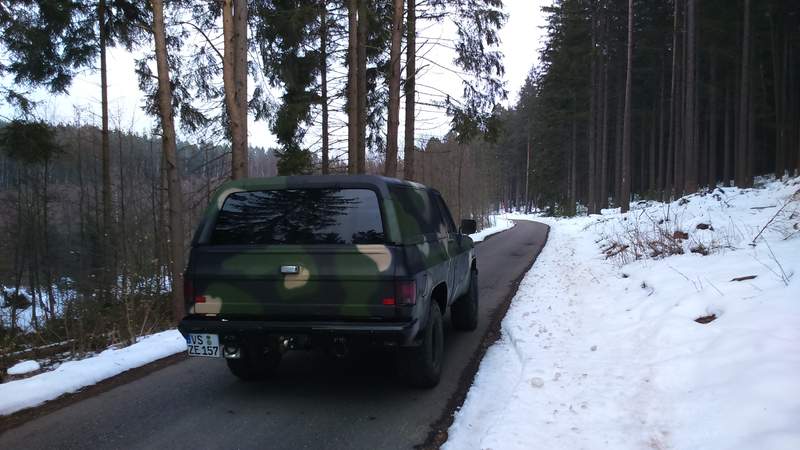

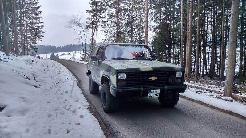

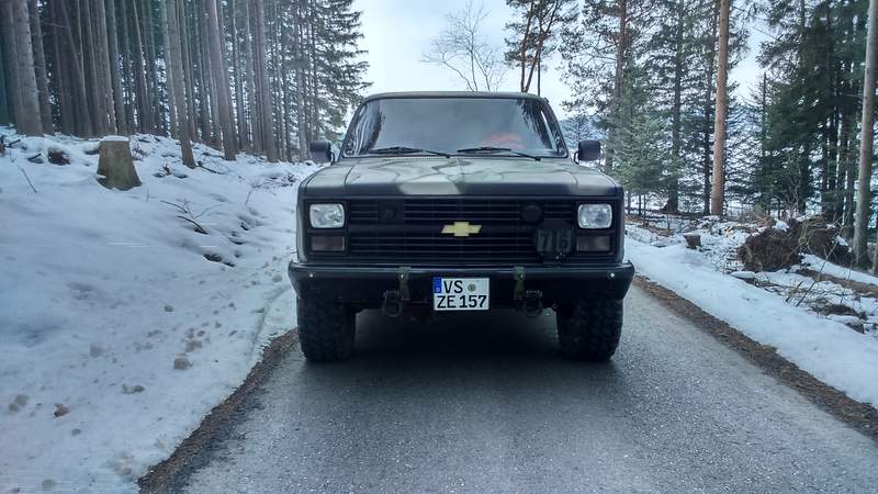

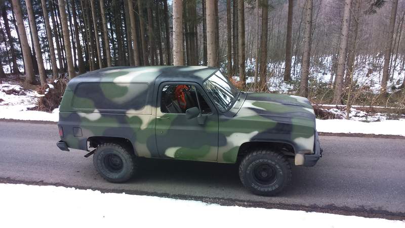

some new pics, just got new inspection (I was a bit late...but they didnt mention it so I got 1 free month lol...) eveything is better than it was. replaced shocks, brake prop. valve, brake pads, rotors, parking brake cable, 1 brake line, all brake hoses, remanufactured brake calipers,new master cylinder, new air cleaner, transmission fluid & filter + new pan with drain plug, new headlight bulbs, engine oil + filter (3 times since I have it) , 2 used Batteries (still good), a new glowplug relay, a new glowplug card (thanks to antennaclimber for making it possible to get a new one...the old one fried somehow), the doghead relay mod, new wheel bearings on the front axle, some rust removal & a new rattle-can paintjob, a new thermostat, flushed cooling system & refill - now safe for about -47°C, fresh differential oil, painted dashpad, sunvisors & door panels black and cleaned the inside.lol ... that must have been everything I did to it in the past... love that CUCV, cant wait until the salt is gone off the roads and make it the daylie again! Aaaaaaand not a single drip of anything under it for now !!! 8) ..and no, nothings empty! all fluid levels are correct! :mrgreen:
Another Ahab
18,140
4,943
Alexandria, VA
She's looking real sharp, Assel.
It sounds like you darn near rebuilt the whole vehicle. Is there anything on that rig that you haven' t replaced and ISN'T new!?
Assel
197
Germany Schwarzwald-Baar
the ol´bucket seats are still in (I plan on swapping a restored bench in it since there are 3 seats in the title), I need a new inner passenger side front fender and I have some rusty spots which I plan to eliminate this summer... also the rear brakes are untouched, still good. And im planning on putting a new timing chain in and maybe I should replace the rear main seal in the future... maybe I open the tailgate aswell and take a look in it, the window crank needs more and more force to move :D
oh and the brushguard comes back on....if I had it on maybe the inspector would have not let me pass inspection.
