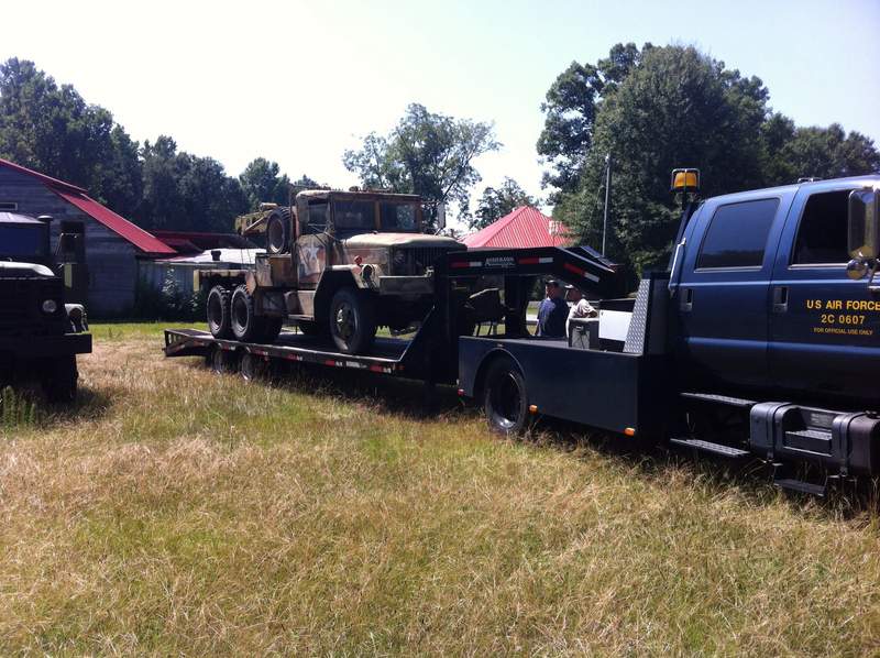

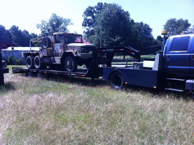

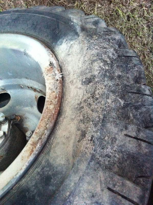

Yes on a trailer, it was thought that the tiers were not road worthy enough for a road march.

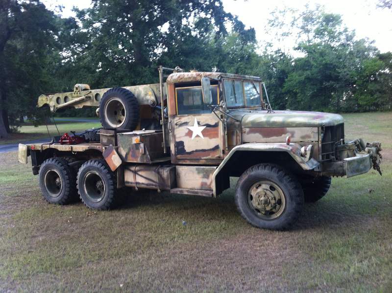

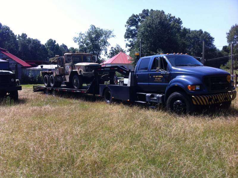

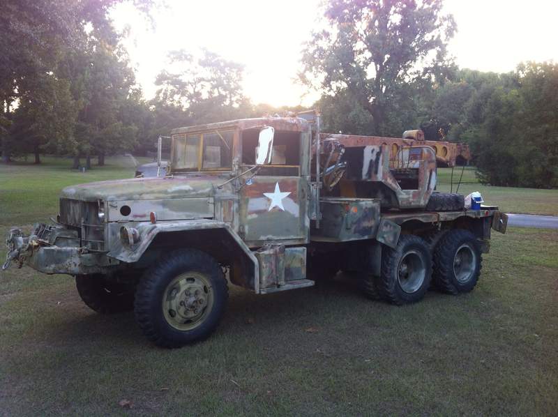

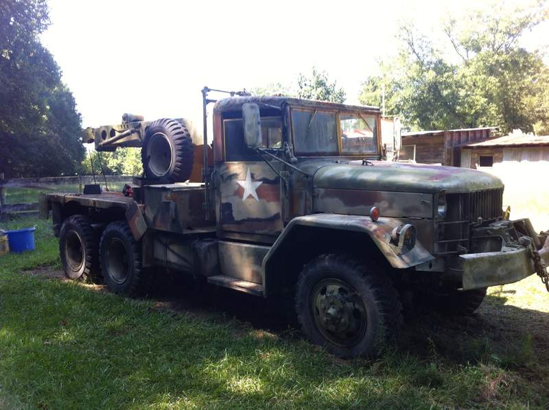

Ron aka 73m819. Did real solid favor today. Made the recovery a breeze. Brought his knock wrench and had the lug nuts loose before I could get the tire down to him. Great ground guide and even took point with a m923 to block 2 lanes of traffic so we could pull into the road. Invaluable help today

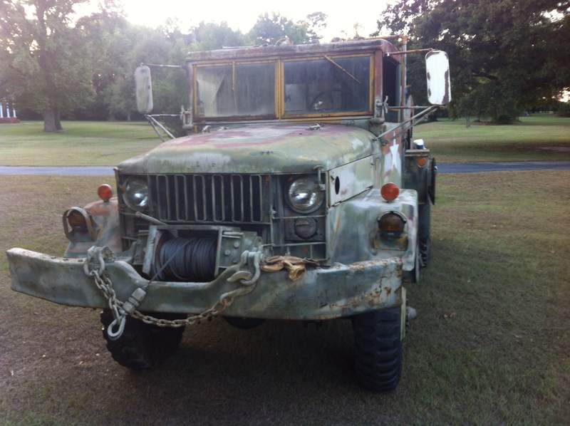

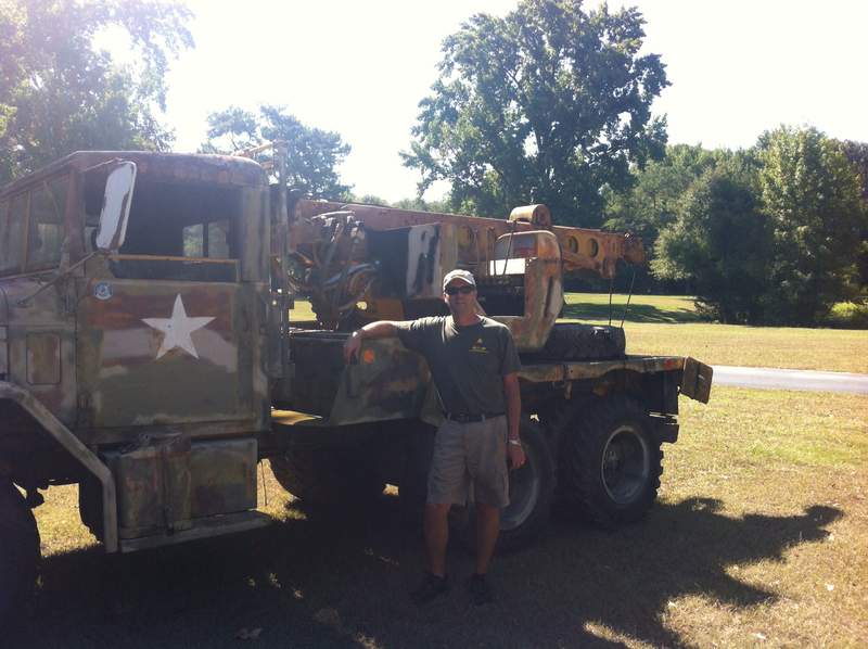

The recovery went as good as possible. Sunday fellow steelsoldiers hurricane48 and I made a recon trip to evaluate the property for possible egress. Also worked on the old m108 that had been sitting in place for at least 3.5 years but I think maybe much more. It had sunk down in the earth 5+ inches. All the way to the lip of the wheel/rim.
Anyhow we drained the old fuel, cleaned the plugs, squirted a little oil in the cylinders, new batteries, checked radiator, new gas, waited a bit and hit the starter button.........................to our complete surprise it fired on the first hit and settled down to a nice idle. Let run for maybe 30 minutes and shut her down to return another day for the actual recovery. Made no attempt to move it.
Ron met up with myself and hurricane48 aka Rocky today. Very uneventful stuff for the recovery itself. We changed one flat tire. Fired the old girl up and let her climb herself out of the 6 inch deep holes she had been in for so many years. Drove over to the trailer and loaded up. Easy peezy.
As mentioned earlier Ron led the way into traffic blocking both lanes for me. I had my strobes and wig wags operating and hauled this beautiful machine home about 150 miles with no issues. It could not have went any better!

I do like the truck quite a bit. It's in much better condition than I originally thought . I have not tried the crane. Hope to get to that this weekend. The motor seems to run well so it will stay a gasser for now. Can't see replacing something that works. I am looking for a parts deuce for spares. Need to find some ndt tires too. Really not sure what I may need.
any pointers on the crane? What do I need to check?
Recovry4x4
LLM/Member 785
34,012
1,814
GA Mountains
Hoses. TM says the hydraulic tank holds 50 gallons. More like 25. There is a return hose underneath that you should probably replace before you put big money in hydraulic oil in the tank. Lots of zerks that will likely need attention. The high pressure hoses are 1" but there are a few fittings made of unobtanium. Andy Bell in TN machined an adapter to use common fittings but never marketed them. Most folks just welded a different end on the hard lines to keep it running. Run the truck in 5th gear at around a thousand rpm with the transfer case in neutral and the PTO lever engaged and it should start working. Check that little driveshaft between the PTO and pump too. A 5 ton wrecker is 100 times more complicated than this little truck but doesn't give you 100 times more advantages or capacity.

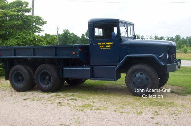

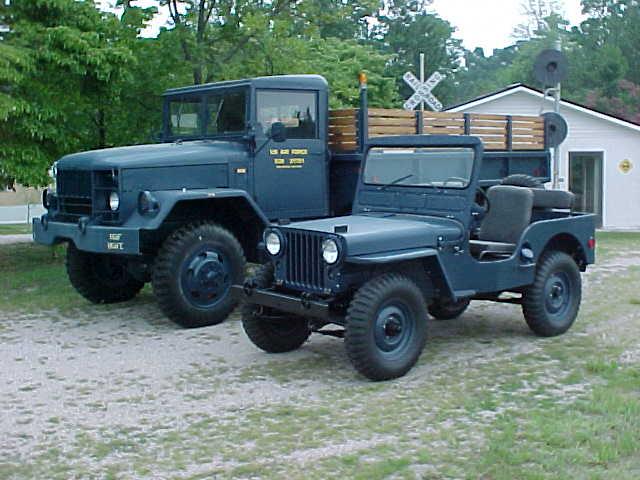

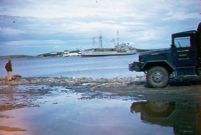

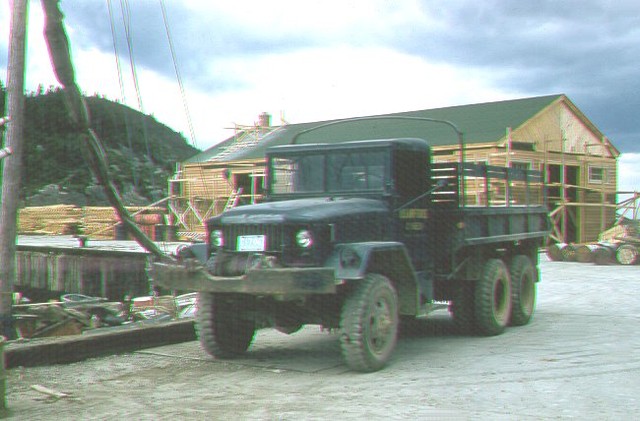

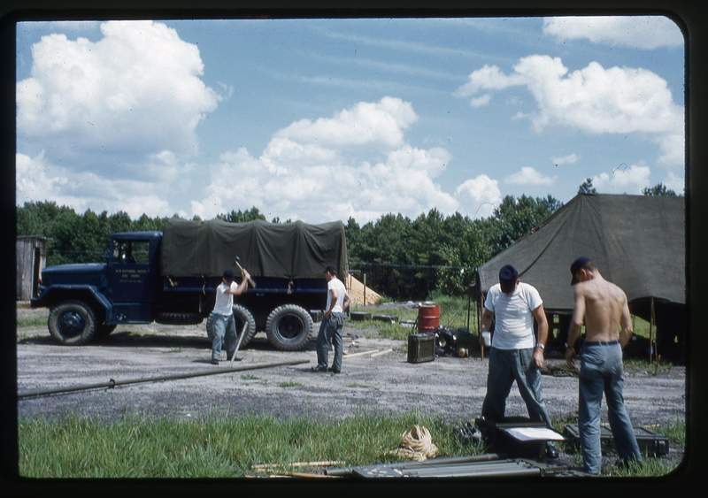

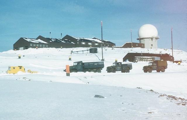

Are you going to do it in Strata Blue?
415454_307227406003133_1492674769_o.jpg306049_208114849247723_3336029_n.jpg10460501_700367590056499_449784268140112325_n.jpgM35_La_Scie_Labrador.sized.jpegM35_Fox_Harbour_1960.sized.jpeg1960_G.sized.jpeg
I do love me some Strata Blue G742 goodness.

While I would be whAt most people call a purist this truck will be 24087 od. My first mv was a strata blue m38 and my hauler is a f750 in AF blue. I just don't want a blue deuce. Who knows its a long time from paint.
