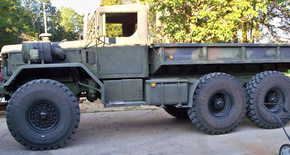

Im gonna fab a new fuel tank, i was thinking a sleeved drive shaft with splines. Im trying to be able to crest much better. Ofcourse these trucks hate hills but im gonna run 53" tires and maybe a 6bt cummins. Im extending the cab into an suv like the russian Trekol or Shaman. If any one has pics of a bobbed 2.5 or 5 ton post it please. (Even if their just two axled).

I just went back and checked out the pic of your truck from the towbar thread. It's got a drivers side tank. It's an M51 without bed or M52. It's got the same WB as the 818 I posted a pic of.

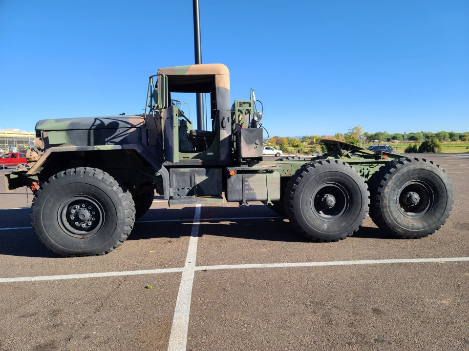

Another 818 with 53" tires. The truck tractor wheelbase makes a big difference.
This truck, with Detroit lockers in the rear and air locks in the front axle will be the best you can get in 5 ton. I'm not sure if the TC (1138) of the 818 can handle backing in low, but with 16.00 it will matter.
