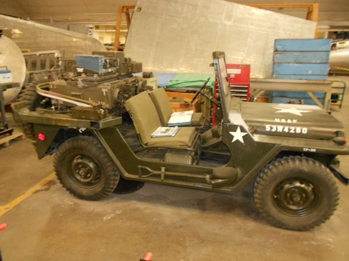

Well yesterday Doc and I had planned to go visit Brother Zout but that plan got squashed first thing in the morning so I told Doc we would make a surprise raid this morning instead.
So...about 07:30hrs this morning my storage lot manager called me and said he was sick. I'm sure he is because he has called in sick exactly 4 times in 20 years...= no trip to Zout's AO.:-(
Then...Doc, Tony, Carl and I had a nice breakfast and headed to the hooch to get the M151A2 purring...or so we thought. Charged up two heavy car batteries, checked fluids, made a temporary gas tank, made a general look around at stuff and decided to give her a whirl.:jumpin:
After cranking for awhile the fuel pump sucked up the fuel from the boat tank and we just knew we were close.:grin:
BUT NOOOOOOOOOOOOO!!! No joy for us...plus the carb was flooding like a mofo.:whistle:
THEN...we pulled the plugs to let the fuel evaporate...but the plugs were dry. Oh well...while we had the plugs out we dumped a little oil into the cylinders just to help the rings and maybe get some better compression...what could it hurt.
Put all the plugs back in but #1 and checked for spark...good to go.[thumbzup]
Tried cranking again with pretty much the same results. Put my hand over the carb air horn and noticed there was almost NO suction so I asked Tony to pull the carb for inspection.
The gasket between the carb and intake crumbled and was in sad condition.:sad: Doc, BabyBear, and I went to O'rielly's and bought an assorted gasket material packet and we were able to make two really pretty gaskets we needed, cleaned the carb inside and out included the needle/seat/pump...that seemed to fix the carb/suction/flooding problem.[thumbzup]
Still no joy.:x
Started messing with the distributor/igniter and was able to get some really neat backfires and even one small carb fire which was exciting for about 10 seconds.
Oh well...by this time it was nearly 16:00hrs and time for the fellers to go do husband stuff with the wives so we called it a day.
Oh yeah...before we left I asked Doc when was the last time he started/drove the jeep. He said..."Well, It wasn't long ago...remember when I helped Chris with that display at the church"?? After some discussion we sorta narrowed it down to either three...or four years ago.
Ya see...time is not the same for old fellers...it passes REALLY fast!:whistle:
Tony says he's gonna go fiddle with it a while tomorrow so we'll see what happens.:papabear:

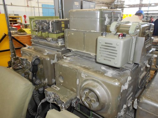

PB at the TACP at Benning in 64-65 we had a very nice 151. All the other units we had were M38A1s'. If you can find the radio gear for the back seat you could turn yours in to a like unit. Would go well with your AF M38A1. The MRC 108 radio gear made the 151s' a little top heavy.

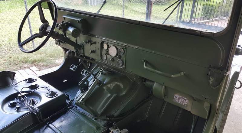

Just an update.
Doc had an extra distributor that he forgot he had until he stepped on it trying to get into his shed!! He brought it down to the "hooch" and Tony opened it up and looked around and pronounced it good to go.
So...we shoved the "new" distributor in and tapped the engine with the magic wand and that rascal fired up like a brand new one!!:jumpin:
Next step is to bleed the brakes and do an inch by inch inspection but so far all systems are a GO!!:D

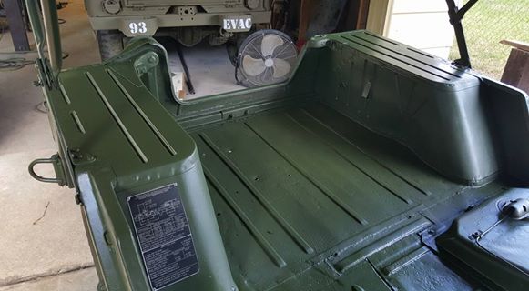

After some severe time lags I decided to update this thread and stop crowding in on Zout's thread about restoring Doc's M170 Ambulance with a quick update.
Seems like Commander Warp had too much time on his hands after researching, fabricating unobtainable parts, and waiting for stuff to be shipped in for he M170.
SO...he told me to bring him the M151A2 so he could prep it for the ride to the Georgia Military Vehicle Rally (GMVR)...and so I did.:-D
In his usual style. the Commander took care of some of the cosmetic deails (I ask him to leave most of them so I wouldn't be afraid to use it) and got it ready to paint with the BEHR 24087 paint.
Last Saturday the jeep had 4 coats of paint and looked better than any I remember seeing in the motor polls.

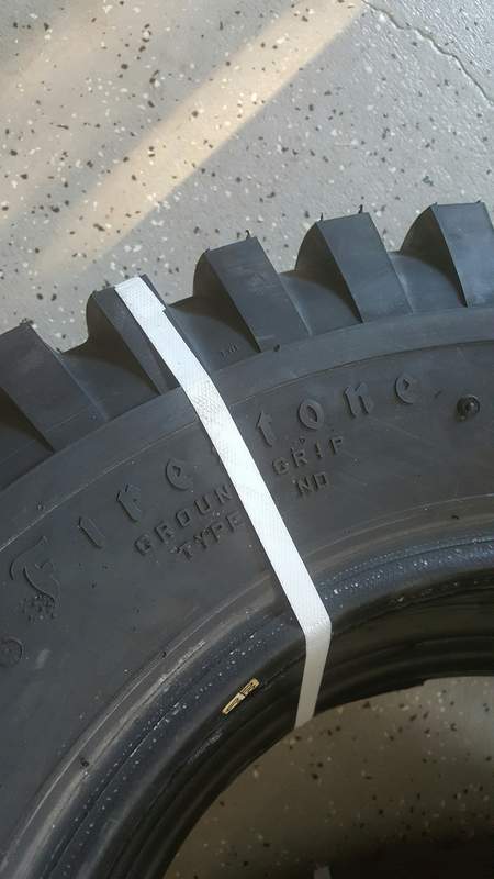

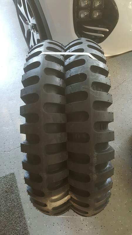

SO...while we were there, Tony whipped out his magic phone and ordered 4 new 7:00X16 tires...they came in today.:driver:
Looks like she will make the trip to the GMVR in a couple of weeks!:beer:
