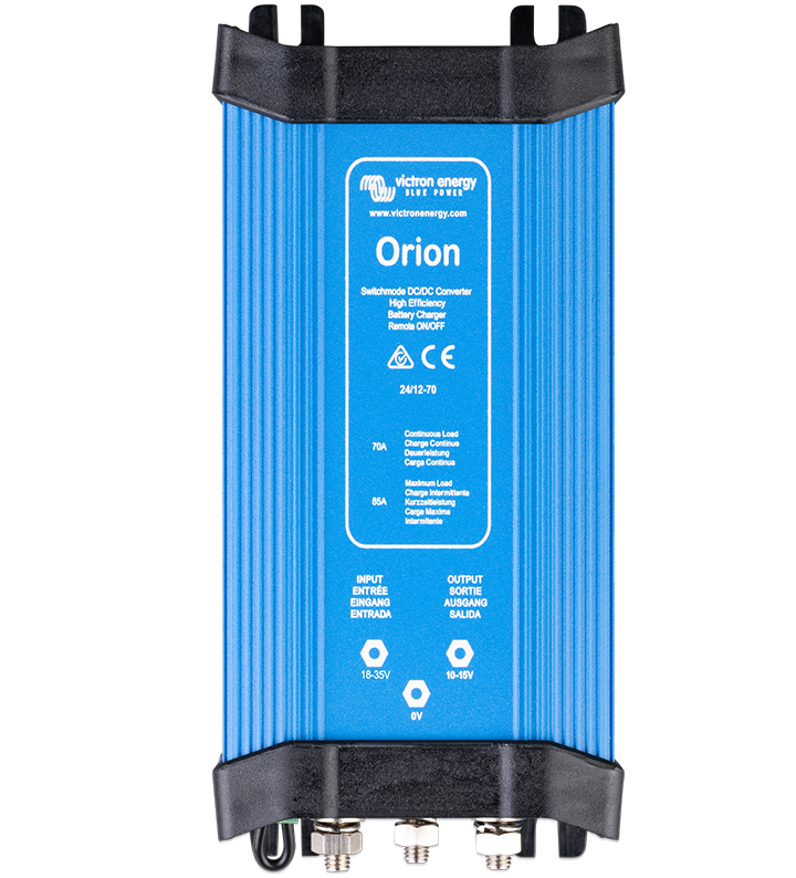

Voltage regulation is taken care of by the alternator.
Depending on what type of loads we're talking about, there are a couple different ways to balance them and have 12V out of them. Easiest way is a battery balancer plus a 24/12V converter.
Examples below
Balancer. This one places a slight load on the higher voltage of the two batteries to make sure they charge evenly.
Converter. This one has a built in relay, so it can be wired into the electrical system to come on and turn off with the run switch. It can also be set up in parallel up to 5 units if it isn't big enough (it's still more output than the 12V tap on the dual voltage regulators)
I used Victron stuff as examples because it's very high quality equipment and NOT manufactured in China. I recently spoke with the primary dealer for my area and he became a dealer because he works on firetrucks and other emergency response vehicles. For his job price isn't a factor; only quality, and he got tired of dealing with all the cheap electrical modules the manufacturers of the trucks were installing, so he went on a search for the best quality electronics he could find for the electrical in the firetrucks, and Victron was the answer.
I also deal with some off grid inverter systems and other stuff, as well as RV conversion with battery banks, and everyone with Victron seems to love it.
