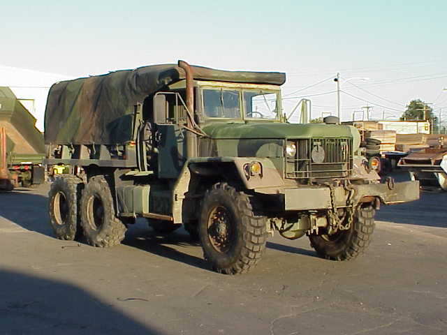

heres another (one or 2)
well my M5544A2 drives great steers good turning circle MUCH better. more mpg. less revs at higher cruise.
the "haglan as we nickname it is outstanding..motorway truck cruise lovely steer (one finger at standstill) comfy ride...same as tother one in respects. oh, and the wheels on the m44 are stock 5ton (fronts have centres relocated to widen stance. on 1400x20s. (the haglan is super singles on widened rims and 1600x20s.

Here's my 923A2. I miss that truck:cry: If I could find it I would try to buy it back from the guy. Dang...
Hopefully I'll have some of the 925A2 soon if I can actually get a day to go to Winslow's to pick up the tires and wheels so I can get the new tires put on :roll:
The 14R20 XL's ride very nice at 60 MPH. Much better traction than NDT's. Make sure your brakes are in good condition to stop all of that rotating mass.
