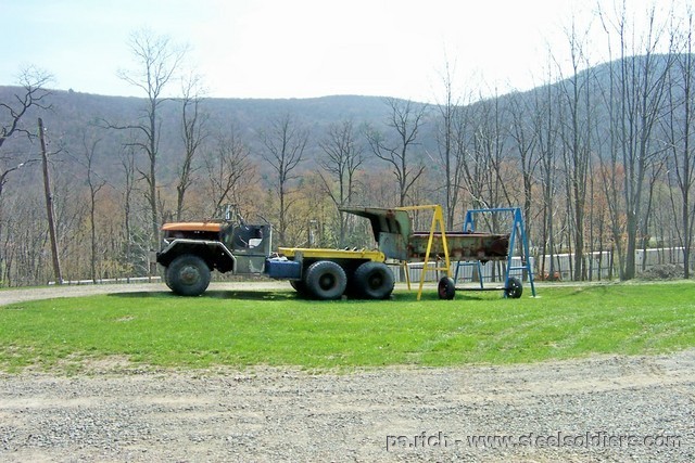

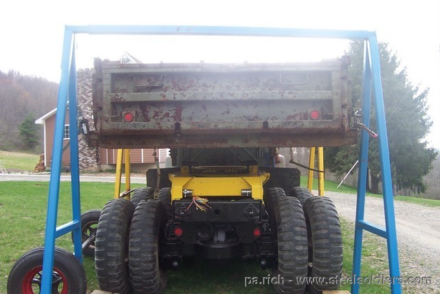

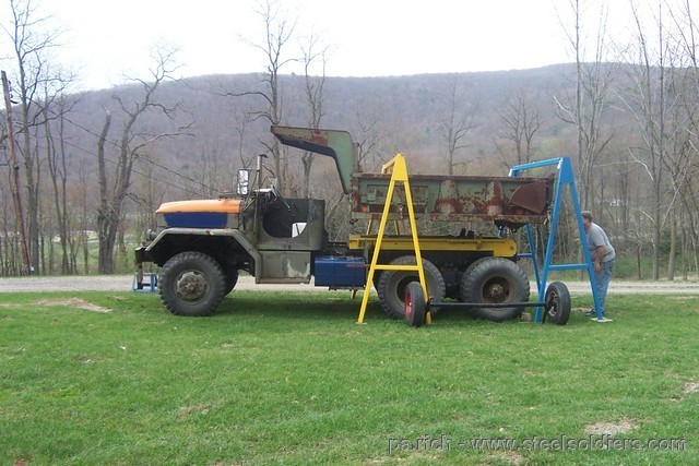

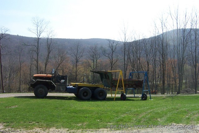

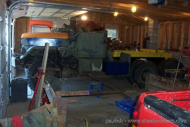

after sitting in the garage for a long time we moved the truck out and just about ready to attach the body. we are waiting for a pintle hook. then it is full speed ahead.

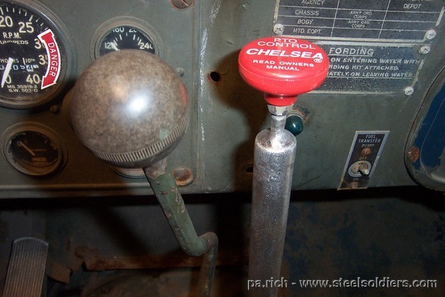

the brakes work!The handbrake is fixed also.I had purchased the pintle off a five ton, but it didnt fit. It was for the tractor type of 5 tonner. They are smaller. And I thought that was about 100 pounds. The dumper model is twice the size and has a huge cast iron backer plate shaped like an "A". I will have to jack it place. Another little snag was when I filled the hydraulics it started leaking fast out of the Rebuilt pto fom Memphis Equipmt. They left two bolts out of the unit on the front side. I had noticed it but didnt think they were all the way thru to the oil cavity. I put two short quarter inch screws in and its fine now. A little annoyed at them. The other thing they messed up on with this pto was they had installed the side cover with the bolts too long. One was jambed into the gears! I let them know about it. Had I not noticed that, I probalbly could have ruined the tranny and the pto. Well everything has worked out so far with much trial and tribulation. Heres some pictures.
