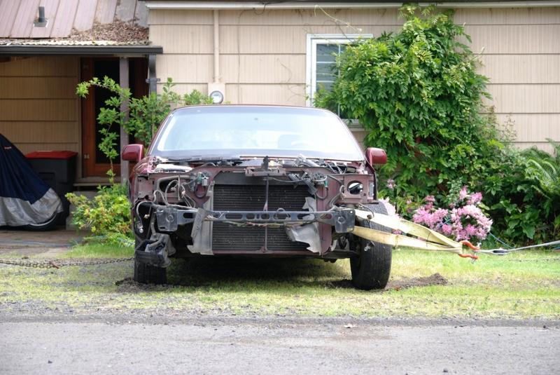

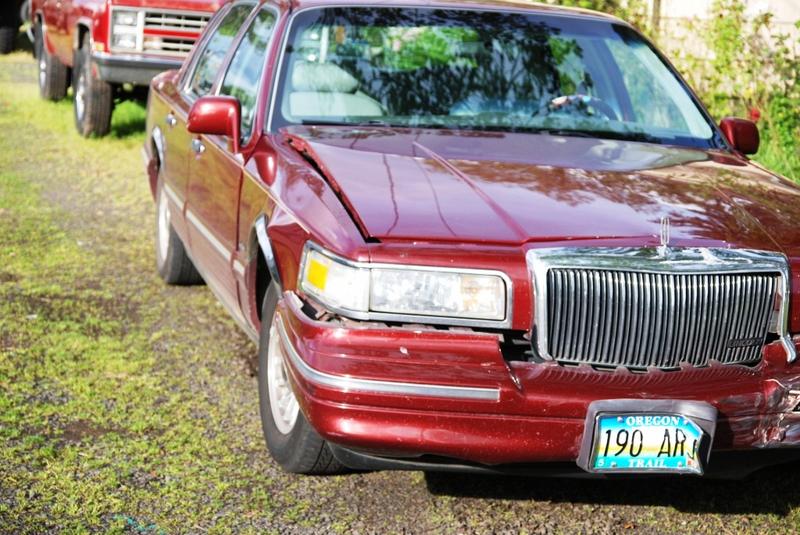

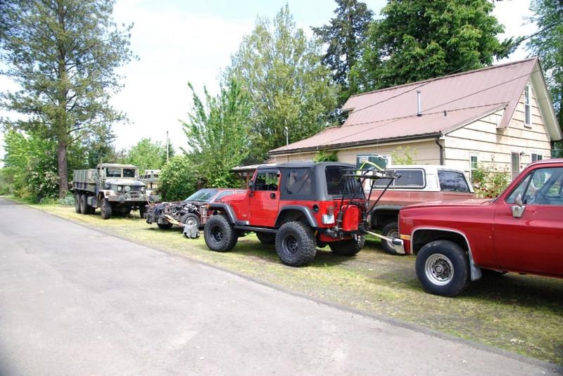

These are photos of a automotive frame pull we did on my son's car after an accident to straighten the Lincoln Town car after an accident clipped the nose and pushed the frontend over.

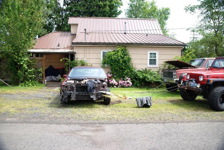

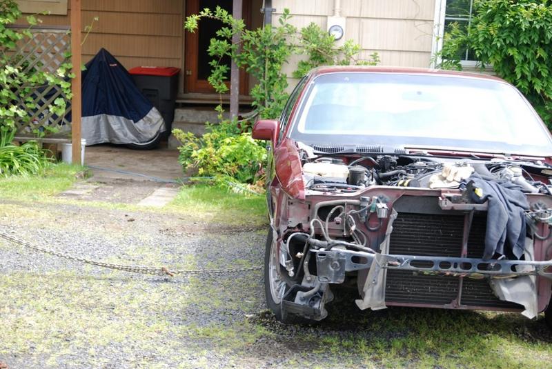

The vehilces involved were a Chevy Blazer to secure the rear, a Jeep and Suburban to anchor the front using the Duece with winch, and a snatch block attached to the cowl section of the frame. We had volenteers in the vehicles to hold the brakes while winching with the Duece tied to the large pine tree because it would just drag the truck untill the shear pin let go. We got the car pretty close allowing us to install a new PS pump pully and new belt for moving the car. a Body shop made everything right before we put it back together.
I wish we had taken a video of the pull as the Lincoln would completely lift off the ground as it was tethered between the cables.

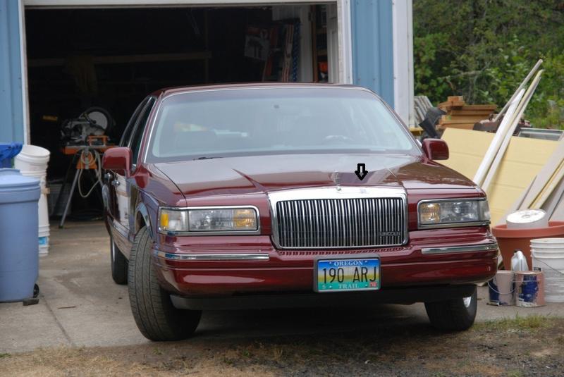

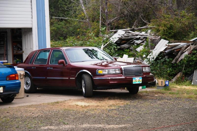

Sorry to think I would try and submit something like that, it is hard to see with the image size compression to get the images posted but the grill still has chipped chrome (we were not able to find a replacement). I will take this as a compliment because I do believe it turned out pretty darn good, even if you get close to it. Yes we fixed the license plate - that was easy just bent not torn or creased. You may notice that the chrome trim around the plate did not survive (man what a tough crowd).
I was a Certified mechanic and my Dad was a autobody repair man for 30+ years. The paint was applied by a friend of his on the Coast who has a body shop. All together the repairs cost $ 2,000.00 with my Dad & I doing most of the labor. Anything more expensive and the insurance would have totaled the car - this way my son gets to keep his first car.
