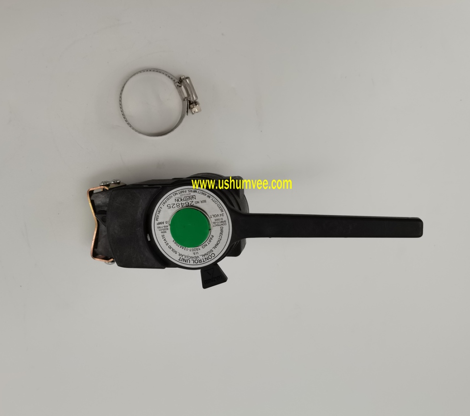

I'm having an issue with my turn signal. I noticed the pecker that engages the wheel ring was not centered. I removed the cover and saw this. I cannot figure out how this rotating lever centers itself...something has to be missing.

Yours like like it is the legit part.
The one I got was a POS, and I imagine it was a China POS. It did not have the same part numbers as yours.
On mine, I gave up. The spring I had was engaged in the two holes, but it was unable to bring the pointer back to the center - ever. I gave up on the POS.
If you look now on alibaba - the Chinese have put on a very good copy of the real military label.
The good ones are $700 to $over $1,000 each :eek: , while the Chinese ones that don't work worth a $hit are $160 to $300 and with the new label that looks ligit, they will be hard to spot for a major rip off.
And the replacement rings that some of vendors seem to sell now are just 3D printed POS that will break on first use.

I decided to waste some more $ on this topic. I scored a used turn signal switch off a surplus parts humvee so I knew it was genuine.
The problem now is that alibaba is selling cheap chinese crap which now have the markings of US manufactured (real) ones. I am sure the US based part houses will soon gobble up the chinese crap and sell for hundreds of $ each. So beware!
So here is a picture of the first one I tried of the original chinese crap without the US manufacturer markings - these are junk sold for hundreds of $ Don't be fooled and buy one unless you like filling landfills with hundred $ bills.
Here is a picture of an authentic US made one, with the proper markings, at the bargain price of only $795.31 (or more):
And here is the newest batch of the Chinese crap now with identical US markings but fake!
So how can you tell them apart? Here is the guide.
  • Ask for a picture of the unit with the green plastic lens cover pulled off. If there is a elastic "string" that prevents the lens over from being lost, it is genuine. If there is nothing holding the lens cover to the unit, it is the fake chinese crap.
  • With the lever in the middle position, check the tension of the return flapper lever. On the cheap chinese ones, they will not return to the middle position solidly. The USA ones do return back to the center reliably. Hard to check over the internet.
  • With the lever in either engaged position, the arm should have some spring and move slightly further so the pin does not jam and break off.
  • The US units lever will flip up and down very easily. Same for little arm when it needs to move the lever via the pin. The cheap chinese crap is much harder to flip - so they are guaranteed to snap the current 3D printed rings quick!
Now for the rings. The ones being sold seem to be 3d printed, and will break off pieces under normal use! I could not find any authentic ones. So what I did with the current 3D printed one at the bargain price of $30 to $50 each was as follows:
  • I applied JB weld to the gussets on each side of the four gussets that support the pins that move the arm. Be careful to not get any JB on the ends so the shape does not change. The gussets need more material or the pins will snap off fairly quickly.
  • Screw in a small sheet metal screw from the back side up into the center of both pins. Those pins are 3d printed and are hallow and have no strength at all. Just use a small screw. I added some jb weld to try to fill up the hallow pins and then the screw for additional strength.
  • Paint the ring your favorite color. I painted it green to match the steering wheel.
  • I also found a radiator stainless steel screw clamp and painted it to match the ring.
  • Apply this radiator screw clamp around the ring and tighten it nice and tight. If you don't the ring itself is likely to snap if you let the wheel fly back to center after a hard turn. Plus the screws do not seem to have enough material on the steering wheel to hold on reliably.
So far with the above modifications, it seems to be working as intended for me.
