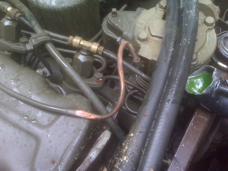

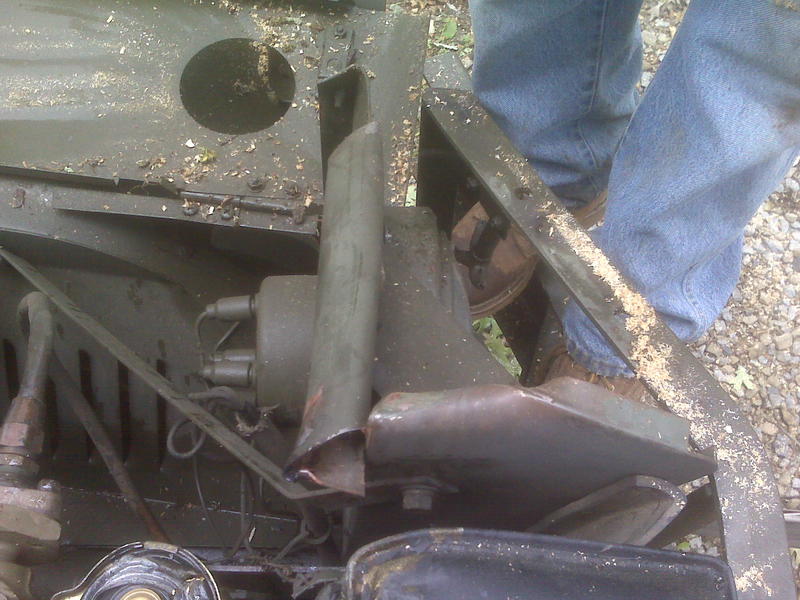

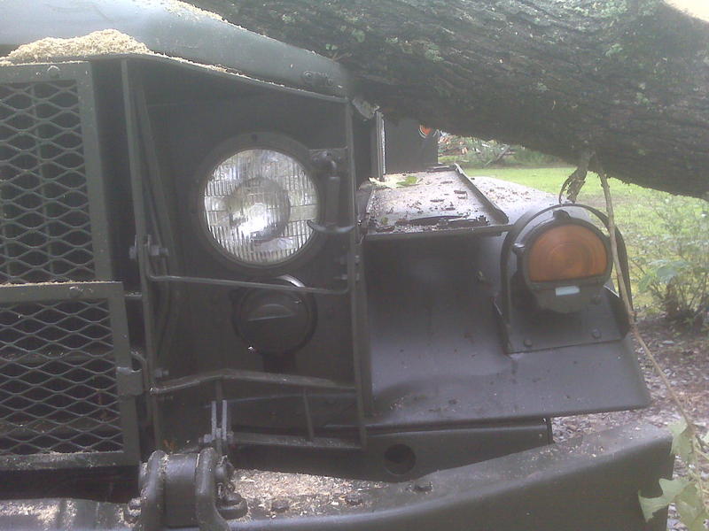

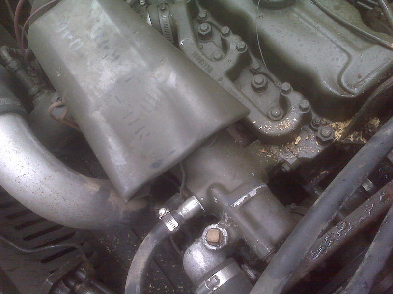

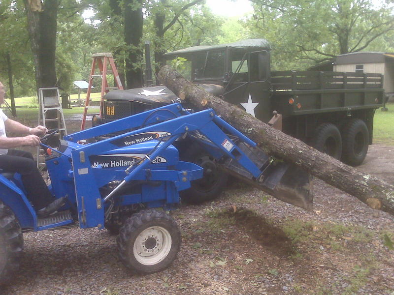

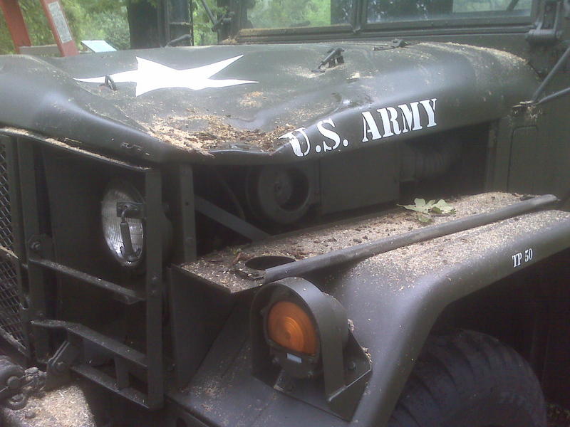

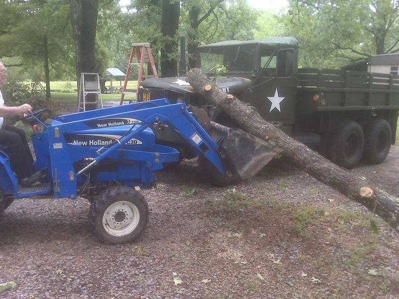

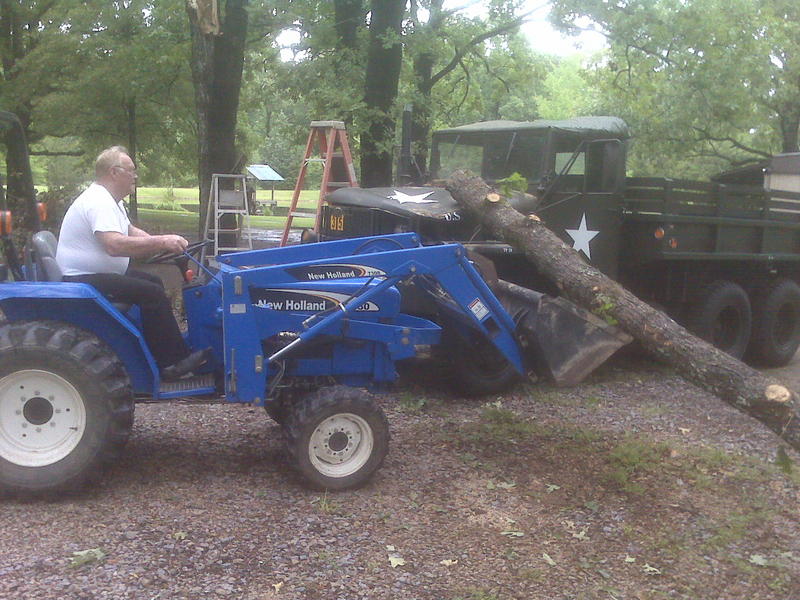

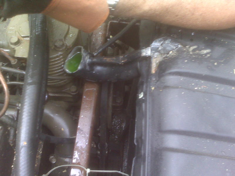

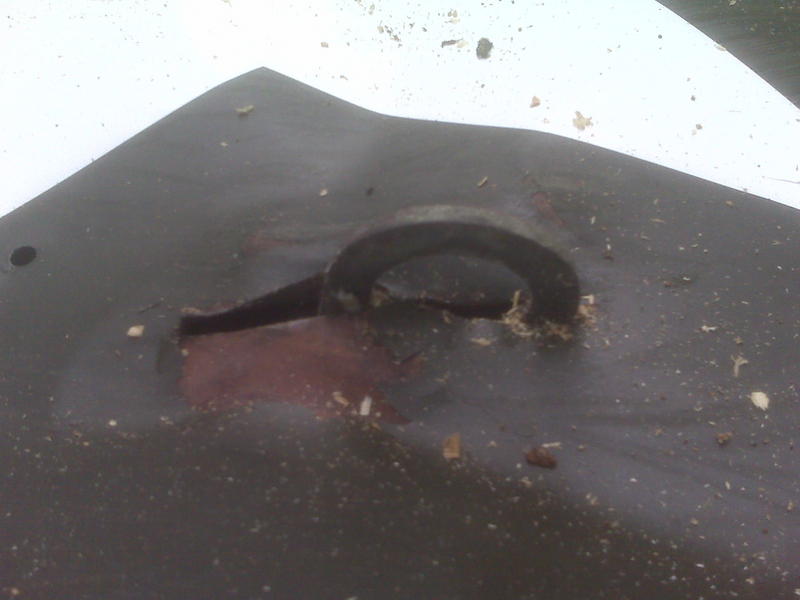

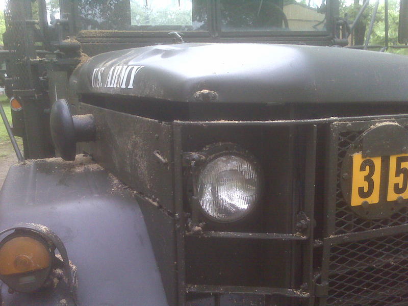

OK, here's the damage:
Line running to compressor across valve cover
Front V/C bent a little

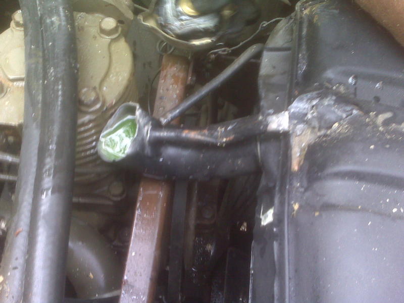

Radiator filler neck crushed and broken
Radiator cap crushed

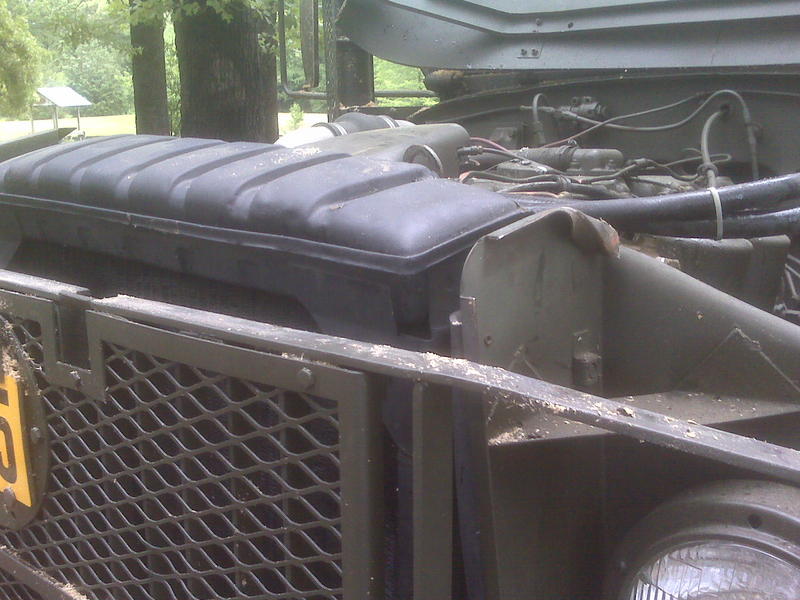

Driver side headlight mounting assembly/radiator support crushed

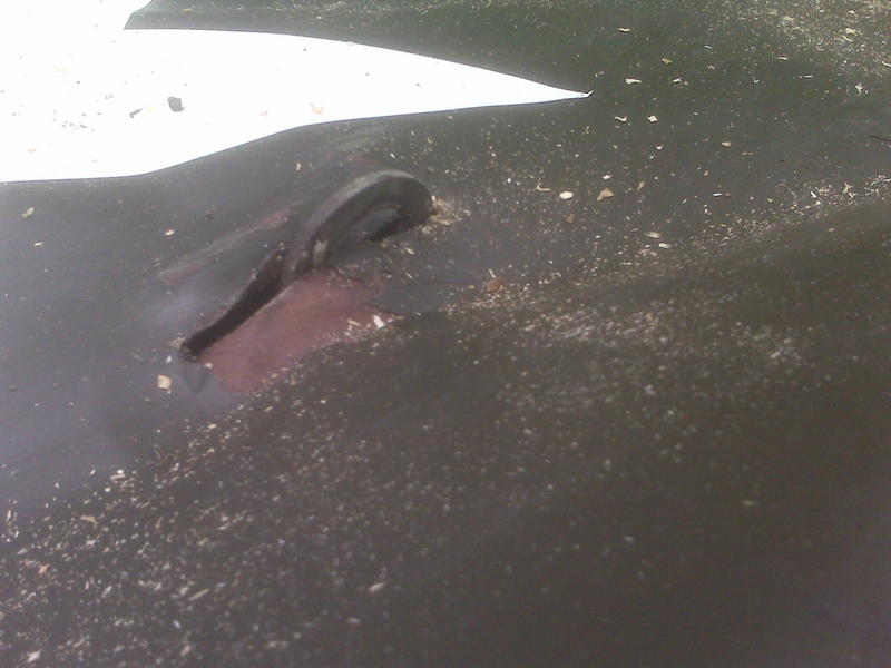

Hood crushed
Cover on pass. side for solenoid(?) crushed
Brush guard bent.
Now the good news.

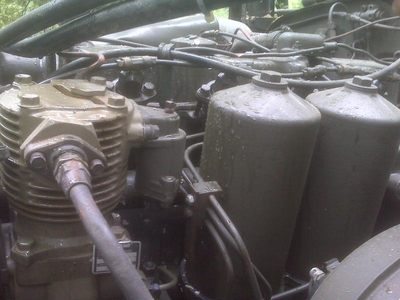

The oil filter housings and base appear to be ok. We won't know if there are any leaks until it's started.

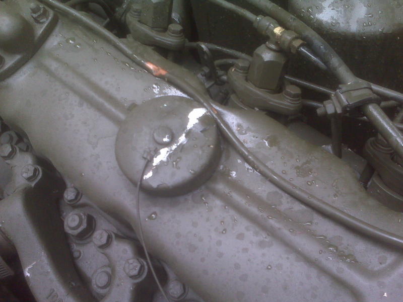

The front valve cover is only a small dent.
The air compressor is ok.
The solenoids under the cover are ok.
mechanically, the only thing keeping from starting and running right now is the radiator and air line!

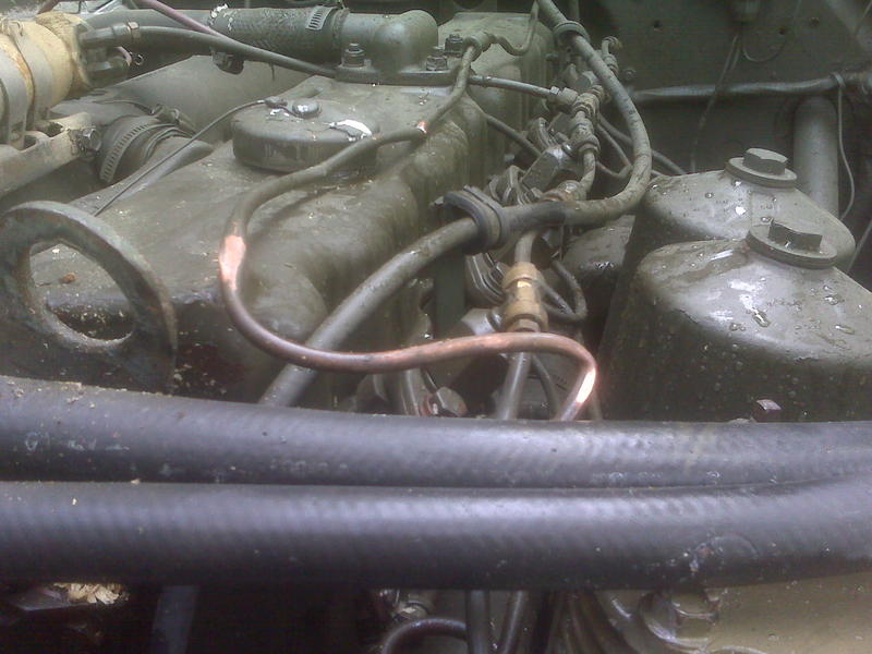

I just had the same airline crack on my deuce last week. Happened while running errands and near my local Lowe's store. I fixed it with a 5' length of ice maker hose. This is braided steel hose and it bolted right on to the fittings. I have the package and will post photo's if interested. It ran less then $10 and is a five minute install.

Just as long as it didn't get the cowl and firewall top you'll be fine. Even if it got those, it's still far from a loss.
Even dented it's a great lookin' truck!

I would be very careful about firing it up wit the dented valve cover.
I don't know about the clearances inside the valve cover with regards to the rocker arms. Other wise you could even run it for just a bit with the radiator neck broken off. 3 or 4 minutes won't build enough heat to affect the radiator as long as the water will circulate in the core and block. :|
