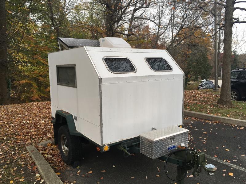

I have a M116A3 that is running civilian pickup truck wheels (16 inch steel rims with 31’s). I am interested in fabricating an under-trailer spare tire carrier using a pickup truck spare tire winch.
Has anyone with an M101 or M116 done this before, and if so, would you be willing to share some pictures? Did you locate the spare tire in front of the axle or behind? Thanks in advance for your responses so I don’t have to “reinvent the wheel.” :wink:

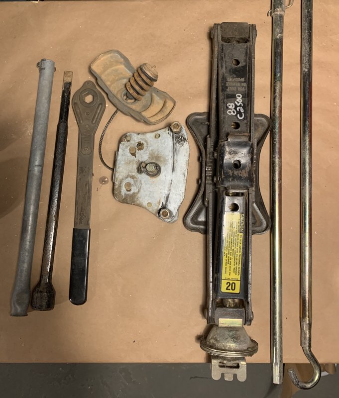

I’m finally getting around to making the spare tire winch a reality.
This is a carrier from a Chevy/GMC C/K 2500 from the late 1980’s/ early 90’s, same era as my trailer:
I also got the jack and the tools to wind the tire winch:
Looking forward to getting it installed.

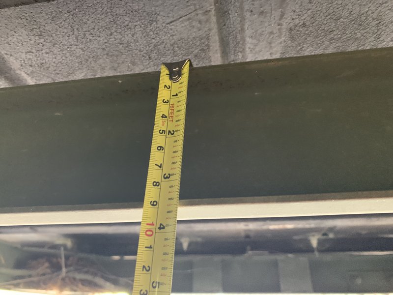

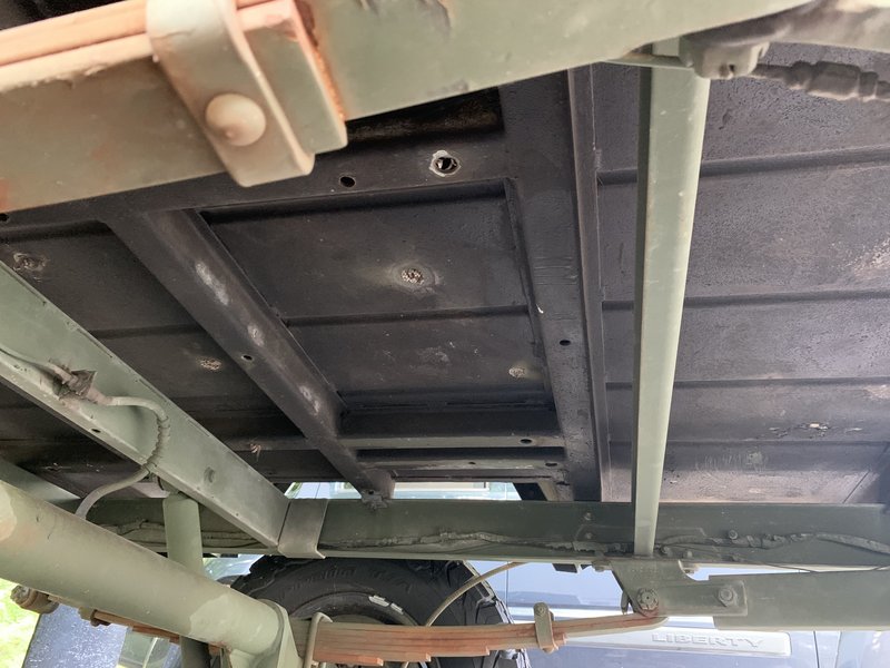

Here are some photos of where I'll be installing the GMC spare tire winch.
It's the beam in front of the axle, right side of this photo:
Which is the same as the left side of this photo:
The beam is beefy, so I am not worried about the weight.
The spare tire winch will be installed like this sketch:
The angle iron will be a place for the tire to rest against so that it doesn't wobble when on the road. The tube going to the winch will go through a hole in the angle iron to keep it stabilized as well.

When I look at the front of your trailer I see a big white wall and a tool box. Why not make a frame to hold the spare and put the box on top of it.
It looks like you are committed to under, but that front area looks easy to access and the spare is not too large.
lfhoward
65
40
Philadelphia, PA
Thanks for the suggestion, tobyS. My tool box is actually a battery box, so it already could be 150 lbs.
Having the tire on the tongue along with the battery box would increase the tongue weight even more and so I am wanting the tire to be back closer to the axle to mitigate that. I thought about putting the spare behind the axle but I would need to lose the rear stabilizer leg to do that and I am saving that space for a future water tank.
