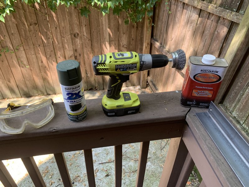

Tools for prepping and painting.
First I used the wire wheel to remove rust and scale that had built up on the surface. After that I wiped it down with mineral spirits to remove the steel dust, cutting oil, and any other residue.

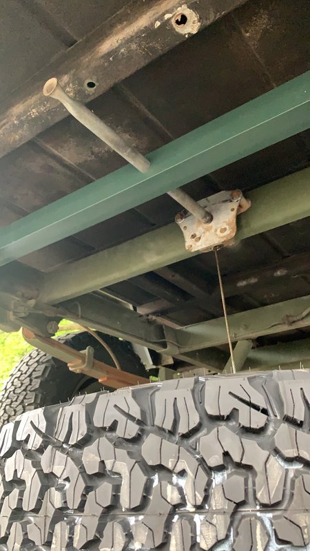

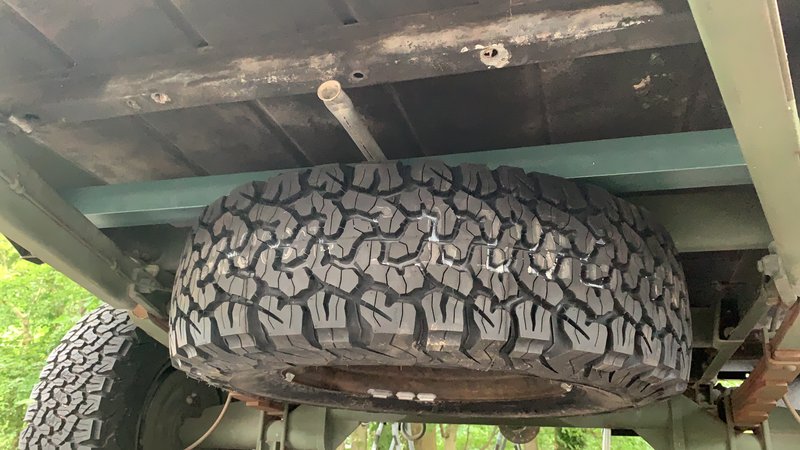

Spare tire winch update:
Today I got under the trailer and installed it. I measured carefully several times before drilling, so that each hole was right where it needed to be.
Getting started by bolting on the Chevy/GMC C/K 2500 spare tire winch.
Next came the new crossbeam I made with angle iron. The tube fit perfectly.
And crank it up.
There is not much loss of ground clearance. I'm very happy with how nicely the tire tucks up under the trailer.
And by doing this mod, I just got a whole lot of room back inside the cabin of my camper!

Looks very similar to mine. I put a ratchet strap on mine as well just in case the winch cable fails or something goes wrong.
Very nice job with the custom work!
lfhoward
65
42
Philadelphia, PA
Looks very similar to mine. I put a ratchet strap on mine as well just in case the winch cablel fails or something goes wrong.
Thank you!
The ratchet strap is a good idea. I will do that. The tire has a slight front to back wobble that I can make it do by hand. I could probably eliminate the wobble by putting another piece of steel angle behind the winch to match the one in front. I wondered whether the tire would shake and loosen itself on the highway. A ratchet strap is cheap insurance.
