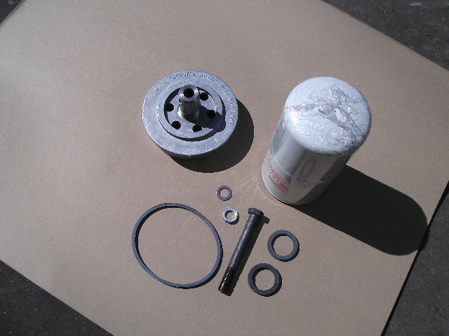

Here are the Wix numbers my local store came up with.
Fleetguard 3300923 s Does not cross to Wix
Fleetguard LF-670 Wix 51970 $25.29

I just went to my local store. They tried to cross the number given of 3300923 S. They came up with a cross for 3300922 s. It showed to be a filter adapter base for a 68-75 cummins engine. Does any one know if 3300922 s will also work for the 800 series five ton oil filter conversion? I was quoted $95 from my cummins dealer and $80 from my local store.
no. you have to use the # I used. the other is listed for our engines but it's not right, I tried it first and it does not fit. I got the parts from cummins if that helps.

Cummins showed the right number. You input helps. I will just have to pay the extra money to get the Fleetguard conversion. I think the filter number is right for both.

Jwaller I went to my Cummins dealer and they told me that your part number (3300923S)was for motors 68 and older and the other number(3300922S) was for motors 69 and newer? My 818 is a 1970 which one do I need?? and it wasn't available as a kit instead a base plus filter.
Help Please I have both on order now?

you will want this part.
you are right it's not a kit. you have to buy the base/oring and then the filter is seperate, as you can use any number of filters on it as others have pointed out.

FOUND my conversion filter for my 818 ;)
now to get filters, adapters, and all other upgrades for the cummins. ARG trucks getting costly rofl

My son forwarded your spin-on conversion post to me. We're going to install this kit on our M-816 engine. Thank you for sharing; your information and instructions were very helpful.

Are you telling me that this is the same kit that Eastern surplus is selling for $225.00. I just picked one of yours up as Cummins Friday but have not had the chance to open the box yet and I just had to ask one last time. Everything axcept the filter that I need is in that little box to put a spin on filter on my M813 or M820 5 Ton Cummins 250. It just sounds too simple and really curious why it is $225.00 at eastern surplus?

I sat up at my cummins dealer friday where i got my spin on oil filter adapters, and we came up with a new spin on fuel filter conversion. $40 for adapter and $8 filter. I will post up soon as its done and let know how the conversion goes. Finally spin on oil, and fuel filters

$225 for the conversion? Take Jwallers numbers up to your cummins dealer and get all your parts for about 1/4 that price. INCLUDING the fleetguard filter
