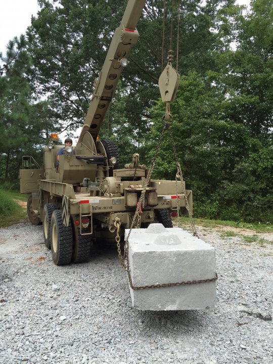

So the M62 Wrecker has a long History on Steel Soldiers. It has been owned by at least 3 different SS members and was the reason Ron and I met back over 10 years ago. I will be posting stories during voting this month and many other such as JoeM62 and Wreckerman can also chime in on the history of "Old Yeller"

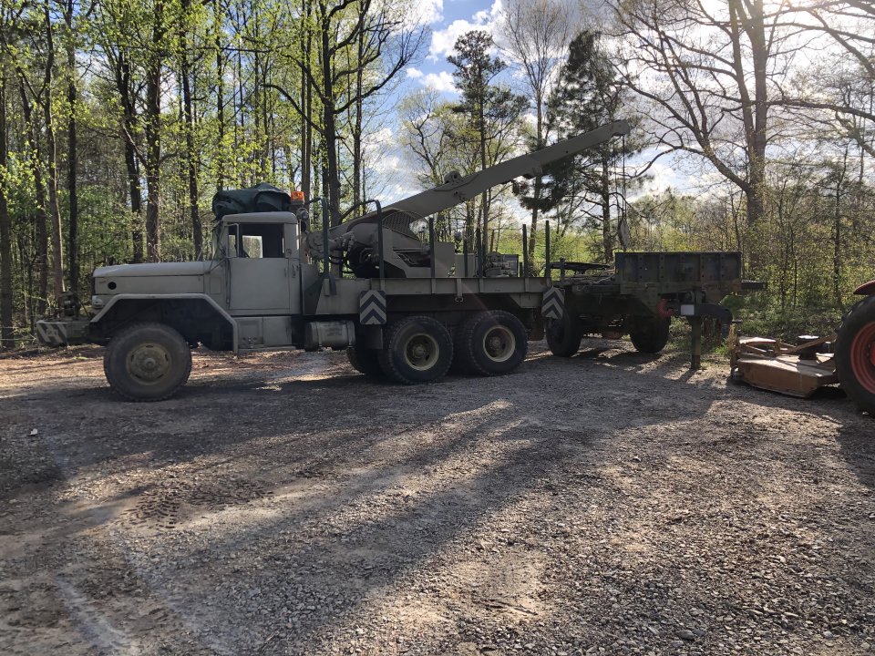

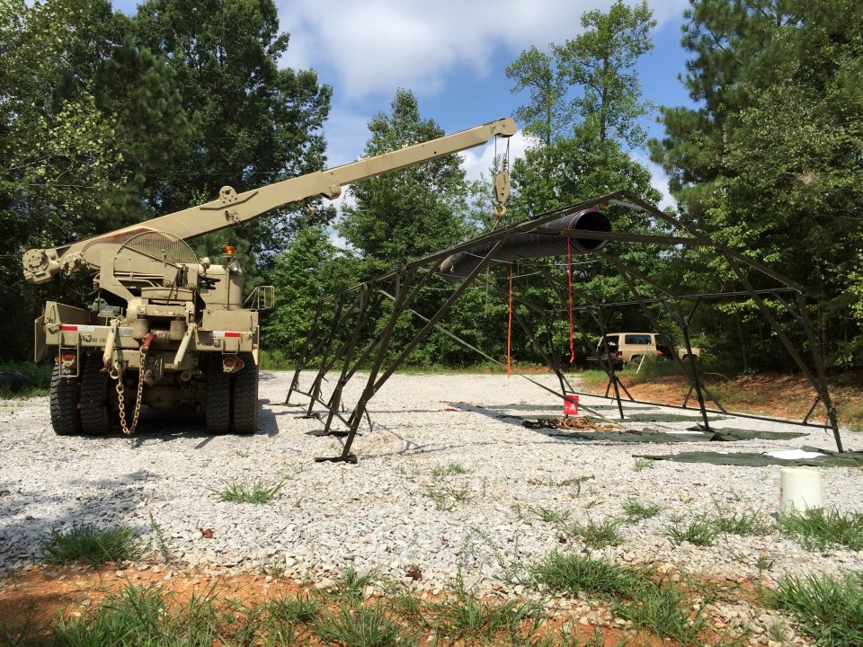

Been using this m62 wrecker for almost 10 years. It has contributed to almost everything on the farm. Went from a complete scrap pile to a restored workhorse. Everything from logging to building. This wrecker does it all. It has constructed 3 LME tents in its lifetime and moved tons of wood.

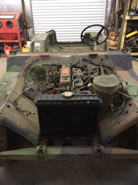

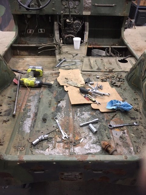

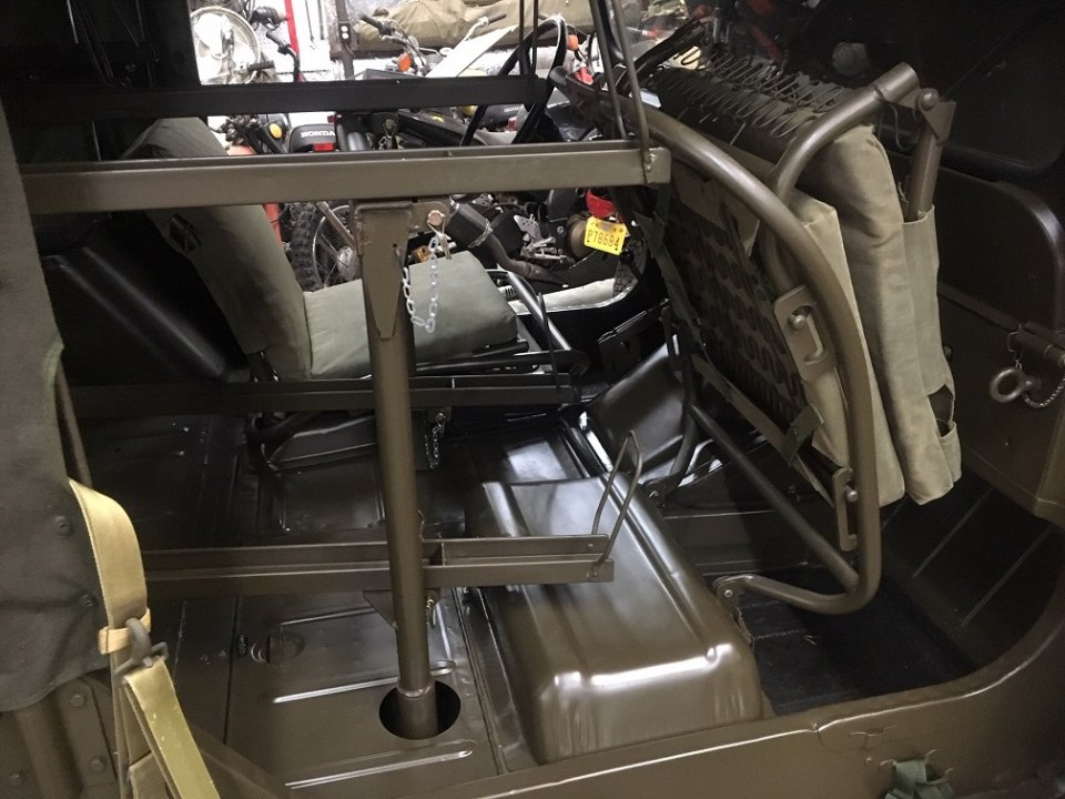

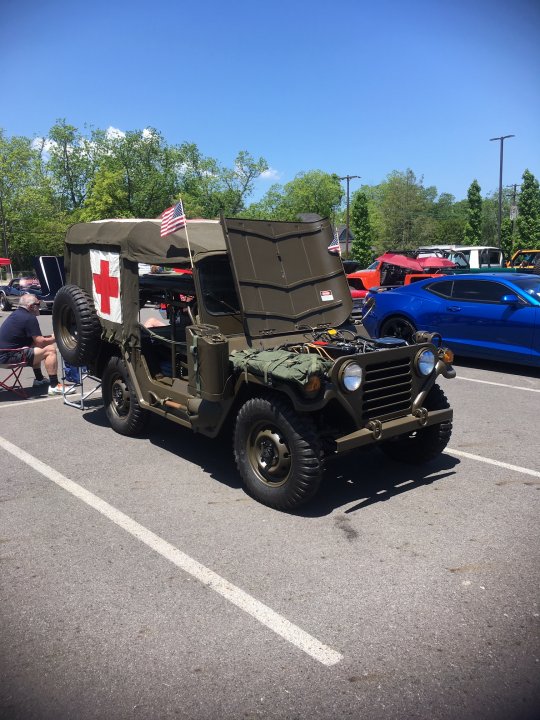

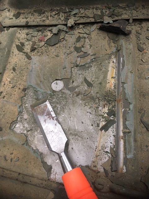

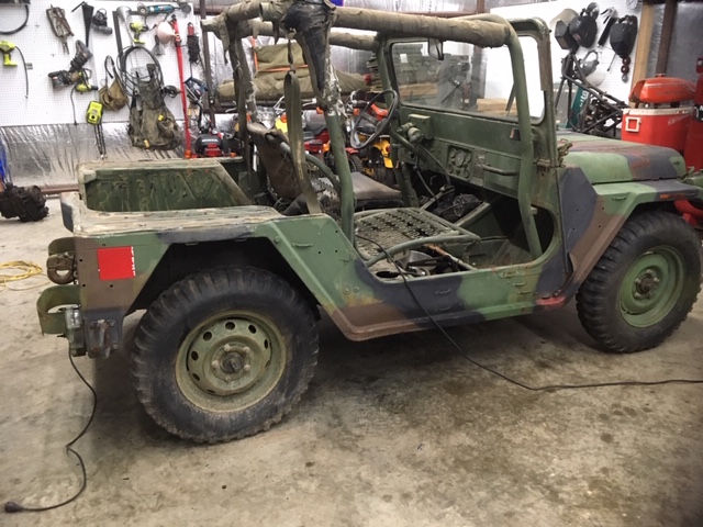

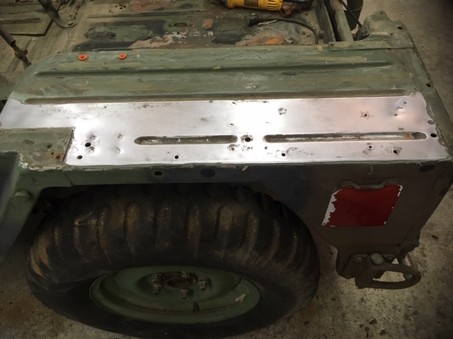

I have owned my ambulance for several years now, didn't want to start the project until I had all the original parts gathered up. That was 10 years in the making, after collecting most parts, I started this project 2 years ago. It was being used on a base as a runabout jeep, all the ambulance kit had been removed, hard top and front half of a ROPS kit had been installed. The good part was they installed the hard top with only a few machine screws, so didn't have a million plug welds to make. It had a thick layer of CARC paint that I removed with a wood chisel, many hours of scraping, had heard horror stories of removing CARC paint. Here are a few pics of the start of the project, more to follow.

So the teardown begins, rusty bolts, busted knuckles, cool beverages and a little swearing but if you put your mind to it, a one man show can accomplish more than expected and the blisters from the scraping hasn't even started.:LOL: If you look close, the jeep came with a couple of nice M38 rims.

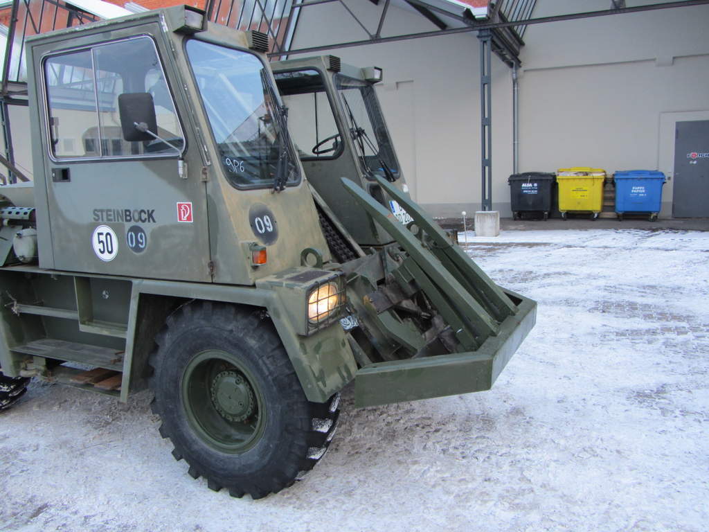

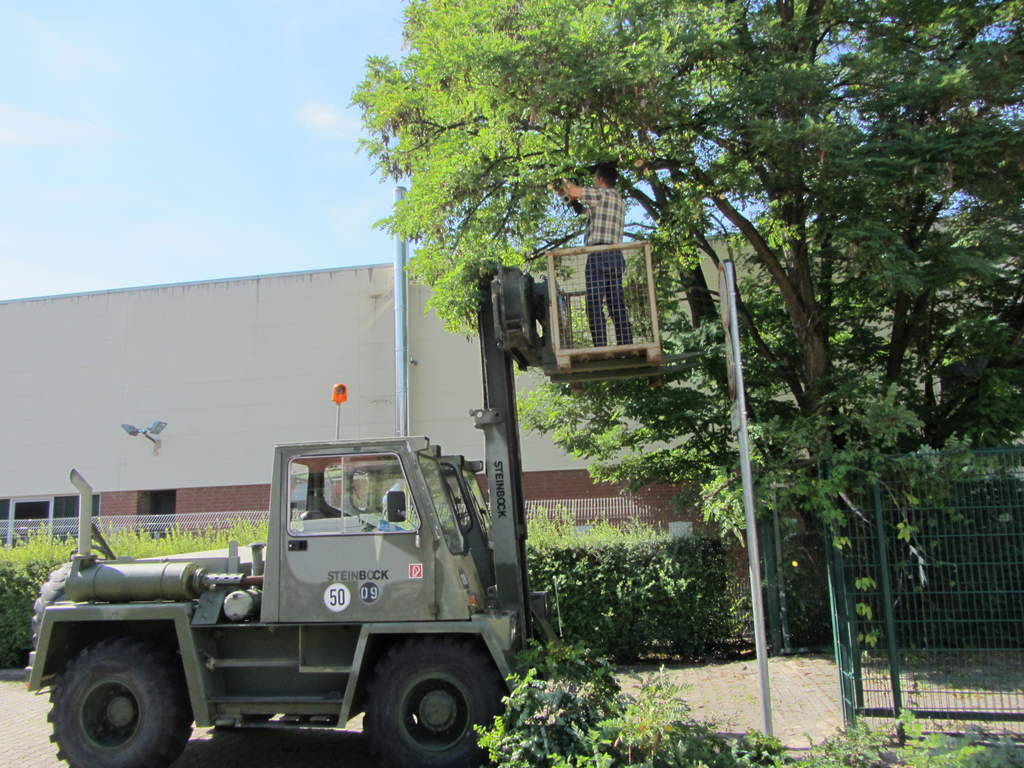

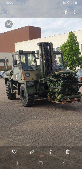

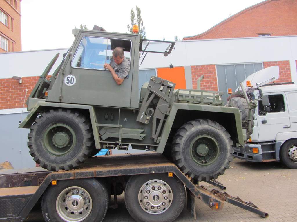

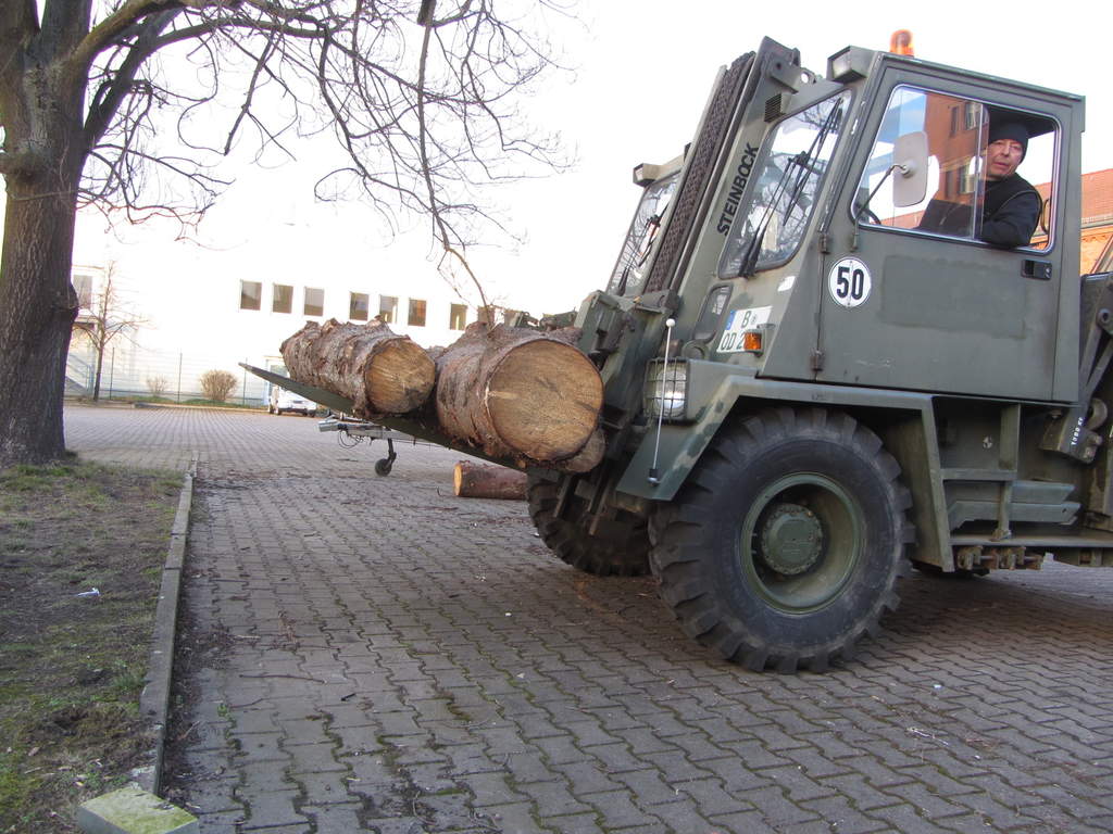

Hello to all your MV enthusiast. We campaign our " Feldumschlaggerät 2,5 t (FUG)". Its an all terrain forklift with 4 wheel drive and diff.locks. Driven by a Klöckner Humbold Deutz 6 cylinder aircooled engine direct injected 4 stroke diesel . 107 HP at 2300 rpm and 345nm torque at 1600rpm.
Trany is an automatik ZF 6speed foreward and 2 reverse with electric/hydraulic shifter. It is an all steel body with mostly up to .400 inch sheed metal which brings it up to 8,8 tons weight including all aditional on vehicle mounted stuff (exept the dozerblade). Since we get this heavy metal piece some years before we love it and we can´t imagine a life without him.

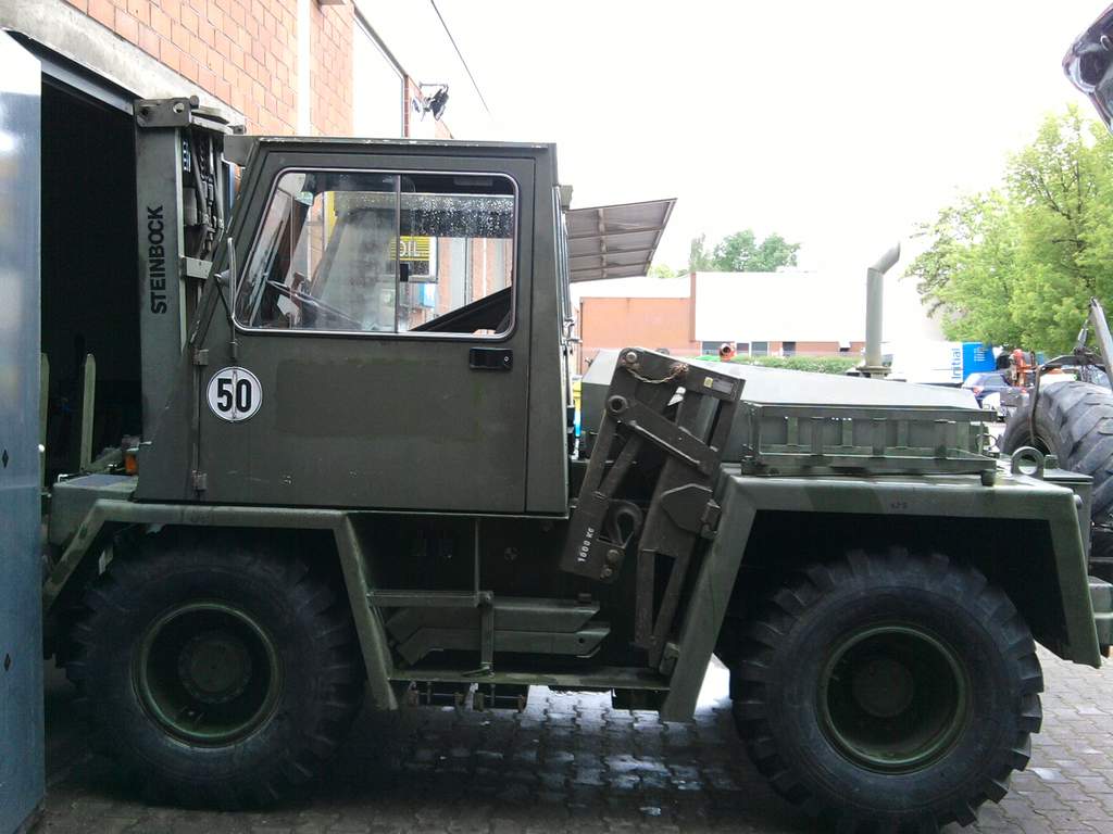

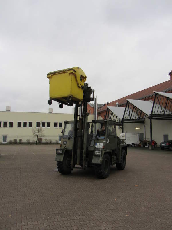

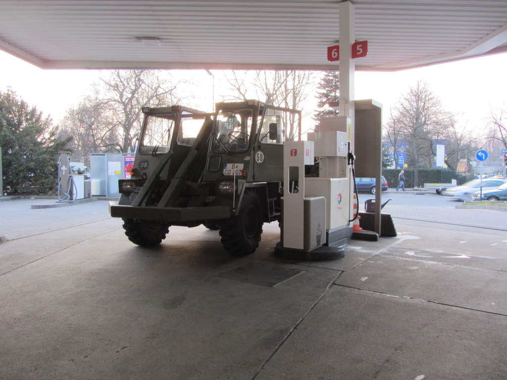

The Migginsbros Steinbock FUG 2,5 Y4 forklift fugbolzenstrasseverlaengerung 004.jpg fugbolzenstrasseverlaengerung 008.jpg was build to drive also in convoy. Due to the rule that every vehicle in the convoy must take two armed soldiers the special dual cap was develloped.FUGtanken 001.jpg
For street use it is nececary to tilt the mast totally back between the cabins. Then it is possible to install the onbord stored front bumper and drive street legal at 30 miles/hour in puplic traffic.FUGtanken 004.jpg
Anyway, driving this no suspension, rear axel steering, 8.8 ton heavy thing fast on the road requires plenty of attention and some courage.
Still it is an eyecatcher on patrol station.

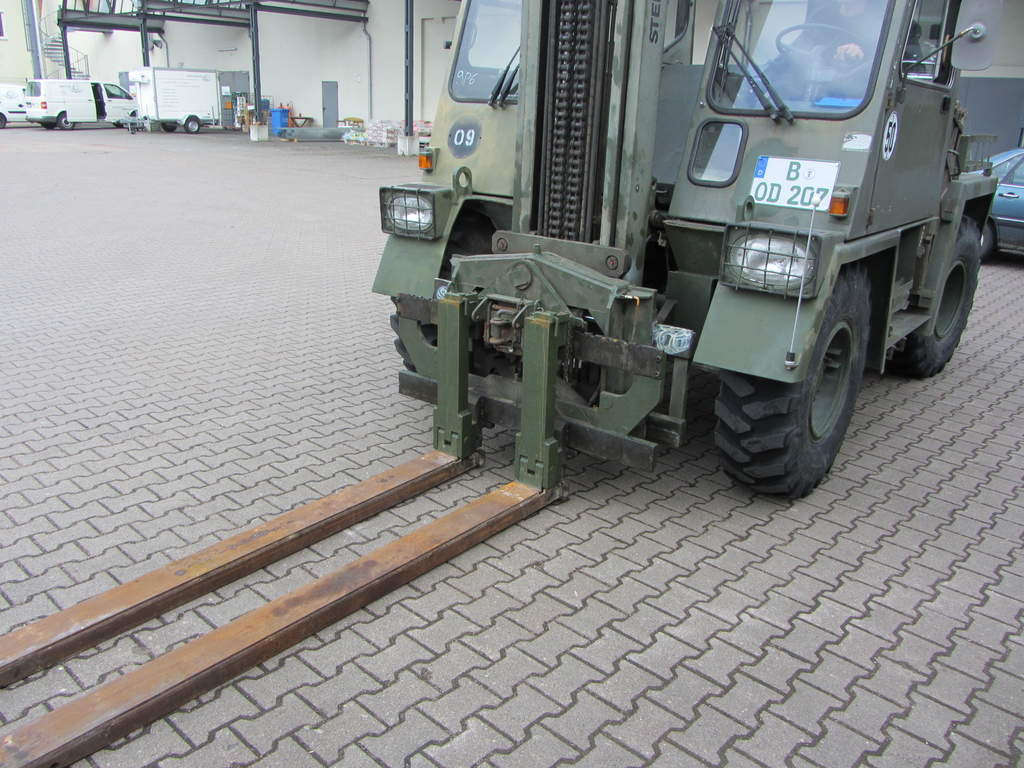

Even it is possible to ride it on the street you are better to piggyback it on a truck. alles ab winterhike2014 1386.jpgThis climbing task is performed by this MV very easy on its own.
Another feature is to slide the forks horizontal 6 inch each side and you can tilt the forks 15 degrees to level the load to the ground. fugebay5.jpg

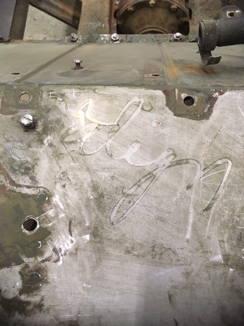

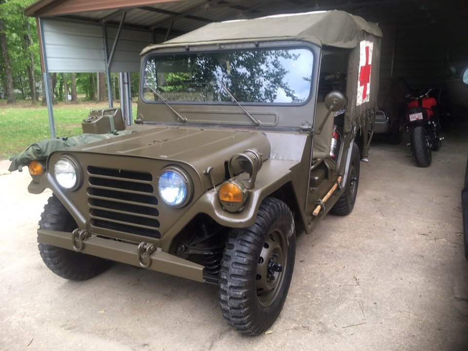

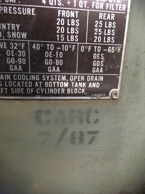

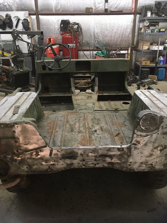

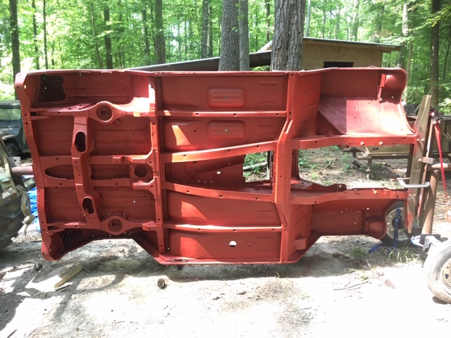

Thought I had more pics of the paint removal(the fun part), I hate CARC paint:LOL:, took it down to bare metal, primed each section as scraped it to prevent flash rust. I have a rotisserie that I made, I can hook it to the 3 point hitch on my tractor to move it in and out of the shop for sanding and painting. As you see I had an uncut rust free body to start with, only rust was surface rust, very rare to find a body in this condition.

All the way down to the frame! It's no wonder that she looks so good in the finished pictures... Really amazing work!

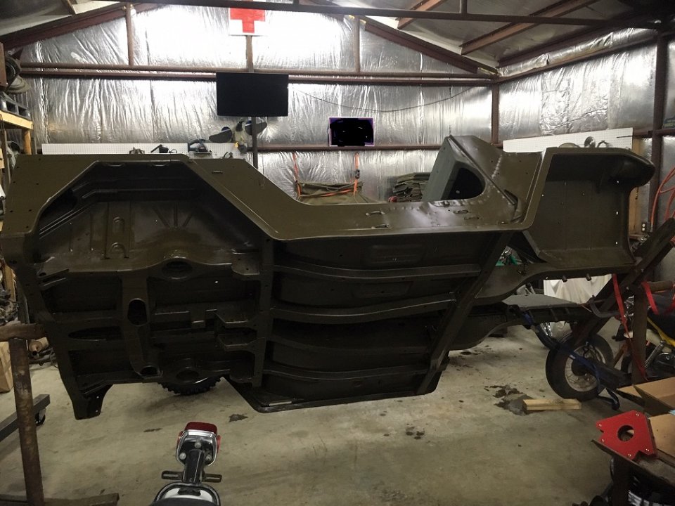

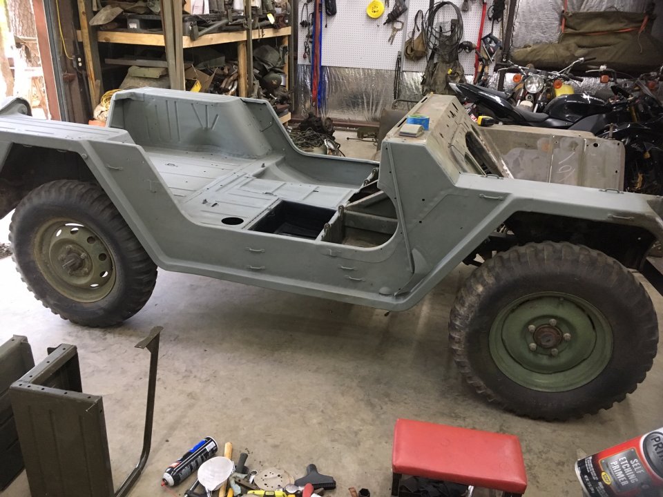

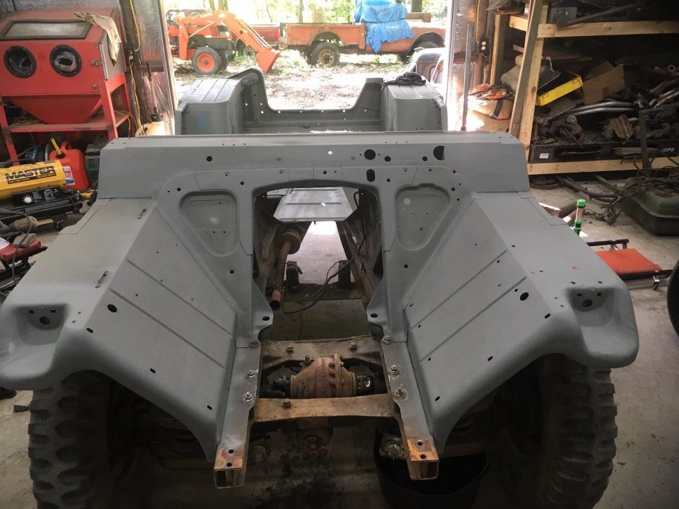

Time to head outside for a paint job, 3 coats of red oxide primer and 3 coats of Gillespie 24087, this was sprayed with a $15 Harbor Freight HVLP spray gun, being a backyard painter, I didn't know the difference. Think I sprayed it at 16psi at the gun, turned out better than expected, unlike the military, I was somehow lucky enough to avoid any runs. :LOL:
