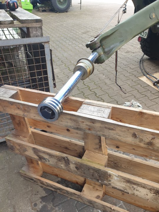

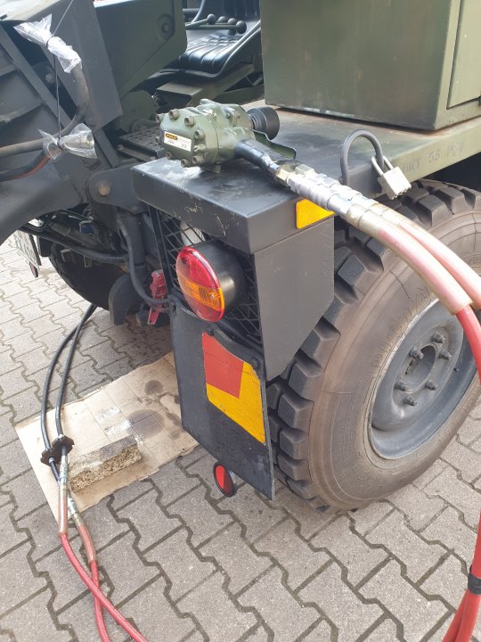

Last hours we get the stabilizer cylinder out . We do it this way cause the lower pin was seized.
We had to heat the piston bolt and use the hydr. impact. We will complete the work tomorrow with a new gasket pack.
