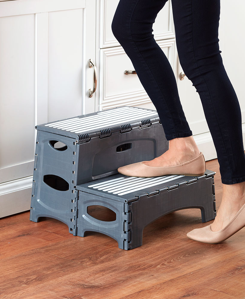

KISS.
Does not show in video.... but looks like it is the folding type step stool. Put a good way to tuck it away once inside so in an accident it is not a projectile.
Guruman
Not so new member
KISS.
While keeping it simple has definite merit, manually dragging the thing in and out each time and finding a place to store it is complicated. every.time.
I'm all for making a complicated investment so that it's simple in the longer term. But, this is basically what I'm doing now in the shop to get in an out all the time.
