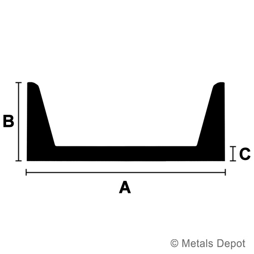

Where did you find C channel like that? I’ve only ever seen it with this profile:https://www.metalsdepot.com/assets/files/Catalog_Photos/MetalsDepot-channel.jpg

It's just a piece of regular 6" C channel like your drawing. I didn't have a tire carrier to measure from either; I looked at photos and just measured what I had and made it work.
