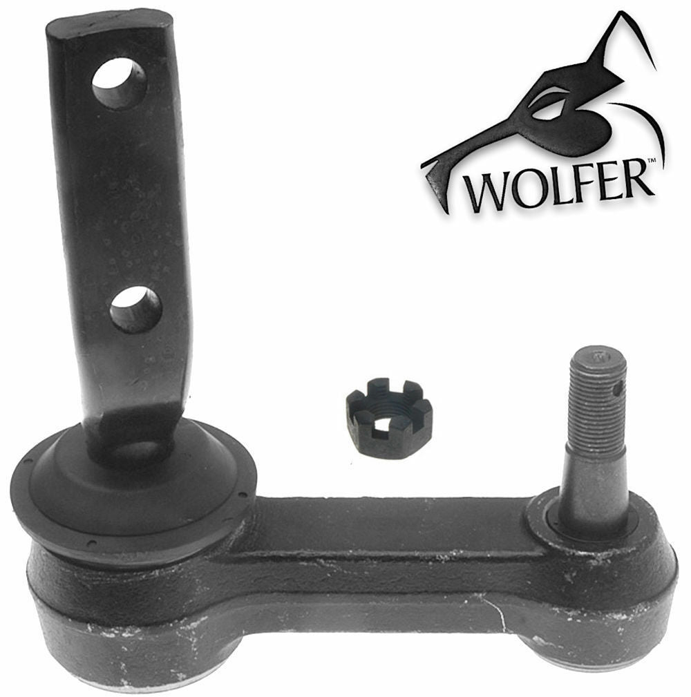

I was trail riding a few weeks ago and got a loud pop sound and the steering was sloppy
The idler arm that I bought from Flea bay had let go, not even 2k miles on it, where was it made ?
When it come to this buy the good stuff, I was able to get a moog problem solver, there is quite a difference in size and quality.

Wolfers is a known vendor/flipper with many china com knockoffs. Search here on ss for many reported issues
Just look up a h1 hummer if is the base early model m998. Oreilly sells moog or can order it in
