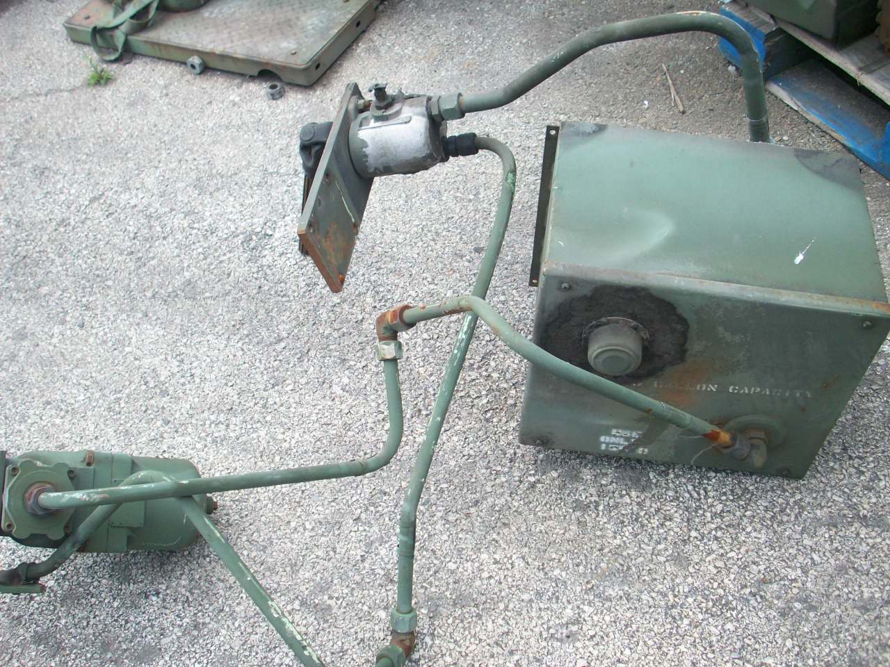

anyway, are there not hydraulic pumps that can run continuously and just recirculate the fluid then there is no demand? I know that might require a cooler but I see on eBay what are called "dumptruck" pumps. They look like this:
it appears there is a control rod that would go to the cab I assume to activate a recirc valve?

The rod is the spool control valve, it directs fluid flow " raising and lowering the bed". That type of pump has a built in relief valve. you just plumb the pressure line from pump to your dump cyl. and a return from your pump to your tank. along with a supply line from tank.

thanks for that info on the pumps. I really don't want one with that spool myself as I plan to run alot more hydraulics off the same pump but do need one that has a relief that will allow the fluid to recirc when I am driving. Either that or I need a pto with a clutch which is also a possibility but just would require more controls to be set up in the cab.
right now I plan to have hydraulic lines running forward to the plow, up to tugger winches on a rack above the cab, to the dump and a wet kit on the very back end. I am also seriously considering converting from the PTO winch to a hydraulic winch. Anyone ever convert a 20k# Garwood to hyd. drive?

You don't want your pump running all the time. They don't make a pump with some sort of "relief" that allows the pump to run all the time. To run the pump all the time you'd really need a closed center system (high dollar and overly complicated for what you're doing).
There are a bunch of things to consider when installing hyd on a truck. What all are you planning on running and what are the GPM and PSI requirements?
Do you understand how a open center hyd system works?
