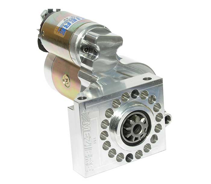

Hey all, it's me again... I've spent the last week's free time working down the issues list and I ended up stuck on my starter, then skipped to the transfer case but thats a different story.
Back to the starter, it died last august and I had it replaced with one of those smaller ones because it was before I started learning to fix my own stuff and thats what the mechanic told me to do. 600 bucks later my wallet was sad and the truck started instantly. The warm temps certainly helped but it was an incredible change from the old 8 second crank. Then as time marched on it slowly started to start slower not dramatically but definitely slower I put this down to the cooler weather. The unsettling thing was it didn't go back to nearly instant even on relatively hot 60+ days still I didn't mind much as its a diesel in cool weather and I'm in no hurry.
The real trouble started about a month ago the starter would engage the flywheel and crank normally for a second then spin free. This would repeat 3 or more times until I'd get a grumbly smoky start and then I'm home free. After some research and watching a few videos I was confident it was the bendix and it was just dirty so I dropped the starter cleaned everything I could reach and reattached it. Same deal engage, disengage and spin. At this point I'm stumped and any help would be very much appreciated.
Now the transfer case, ah the tales it could tell plowing snow in 4low jumping puddles in 4high and various other bits of hard labor plus whatever the army did with it. About a week ago I tried to get down into 4low and It started grinding when I tried to pass neutral, then when I gave up and tried to go back it ground again. After some slight panic and images of my eternity stuck in neutral I started screwing around and eventually found I could shift the transmission to park then drive then park again and that would free the case to come back to the light side aka 4high from there on everything works unless I try 4low again.
Few bits of additional information, first some images of the starter - attached.

Chinese Carquest trash. Most of the starters for sale are similarly absolute trash. If you have your original they can be rebuilt. Also check all your battery terminal connections and wire lugs, etc.
If you want the starter to end all starters (I haven't tried one out on my CUCV but have used them on other SBC and BBC applications) - this is your ticket. I would call them and make sure it would fit but I don't see why not.

Does your new starter have the starter support bracket for that starter? If not, don’t start it again until you do.
Here is a video I did about the starters and brackets:
