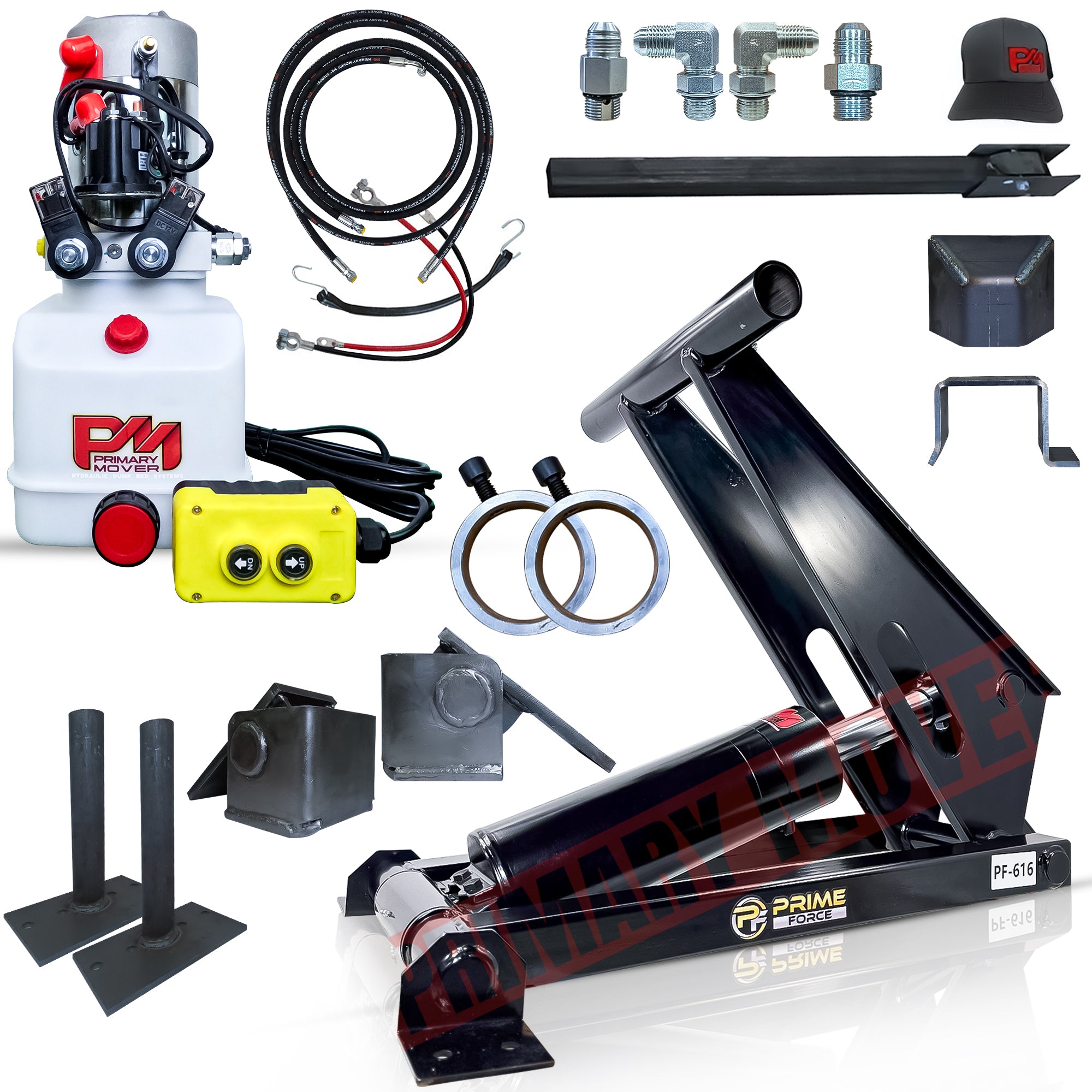

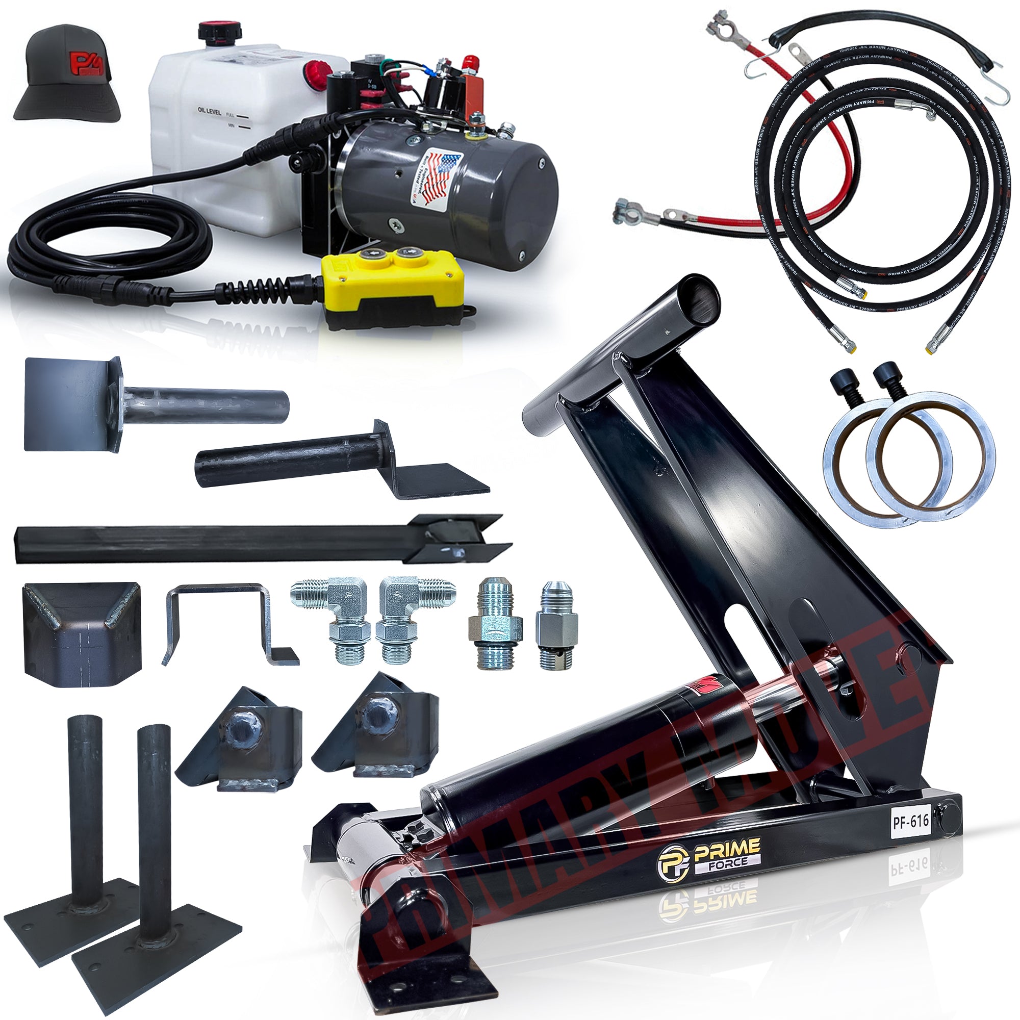

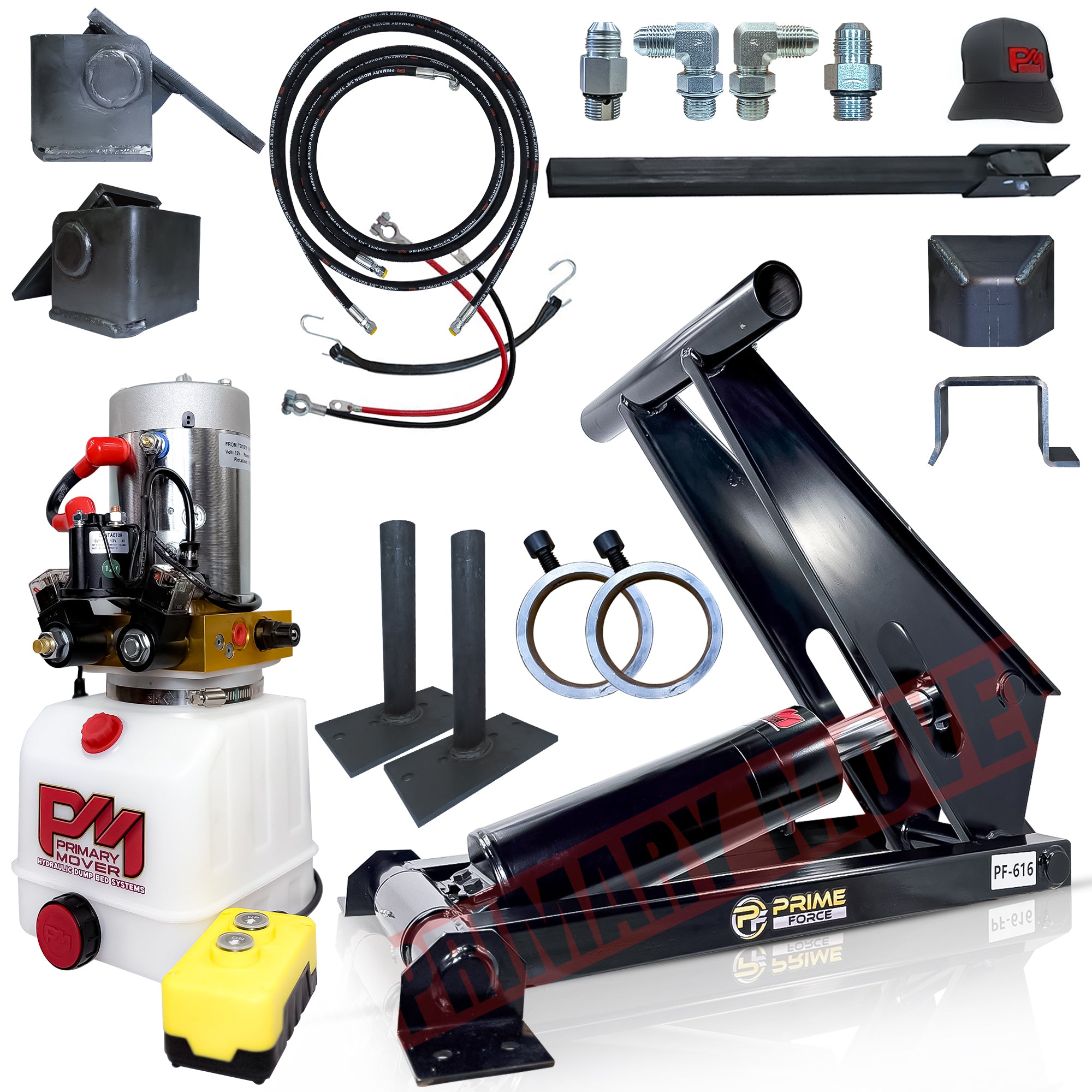

Grab you a ph616-6 hoist kit and these hinges because IMO they are better quality and higher strength. That is what I am running on my m931a2 with a lmtv bed on it. I am running a pto and winch kit instead of the hydraulic pump but the electric pump should do fine. https://bushtec.com/products/dump-hinge-welded

any issues with hoist fitment ? See Midwest military said there’s a little more to do with the 11 ton versus the 8 ton

the ph616-6 is the same size generally as the smaller units. I have a tractor and had to move the air dryer and notch the center frame support just a hair but other than that it is the largest hoist you can reasonably fit
