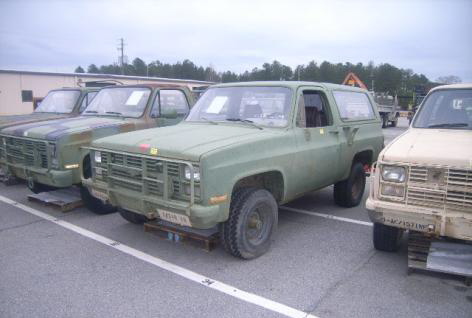

No, it was the green one beside the tan one at WR. It had a little better body and about 40,000 less miles than the tan one. The tan one sold for for $1350 and I paid $1505 for this one. I had been looking at them in Atlanta on lots and owned by individuals for a while now, and rough ones seem to start at about $3000, so I feel I did good on it. Its missing the mirrors and it looks like the rear window crank is gone, but John McGhee at GL said it ran well, so I took a chance on it. Even if it had engine troubles, I've got a '91 6.2 with Banks set-up in my shop out of a wrecked Suburban. Here's a few pics of it.

Excellent. Was wondering cause I contacted the motorpool guy for the tan one and they actually turned in two that looked basically identical. He said one was decent but the other had a bad injector pump. Thought I'd see if the one bought was the hanger queen he told me about or the decent one. I just never got there to check them out.
