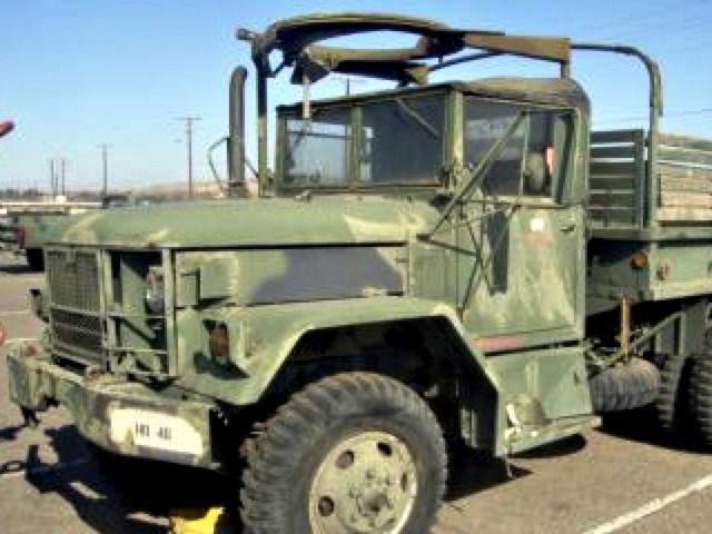

1973 AM General M35A2 Cargo Truck, no winch, with M66 ring
a. 386591616153
b. unknown (certificate number is SF97-S5127-L8109)
c. 2320000771616
d. eBay auction from Government Liquidation, LLC of Scottsdale AZ
who bought it from DRMS, Battle Creek, MI on 5/25/2010
e. 312 COS HQR 506
--Fuzzy
Update: heard back from Steve C., and the current bumper numbers are fiction (they came from another truck).
So all I have is the VIN and manufacturer date.
The right bumper seems to read "HQ 11", but the before photos are very low res. I also know that it wasn't originally tan.
--Fuzzy
