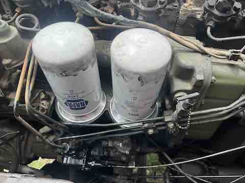

Fixed the fuel shutoff; the plunger was bent so it would not slide within the nut, and the handle in the cab was missing.
I installed a set of oil filter adaptors to accept spin-on-style filters. This seems like a significant improvement.

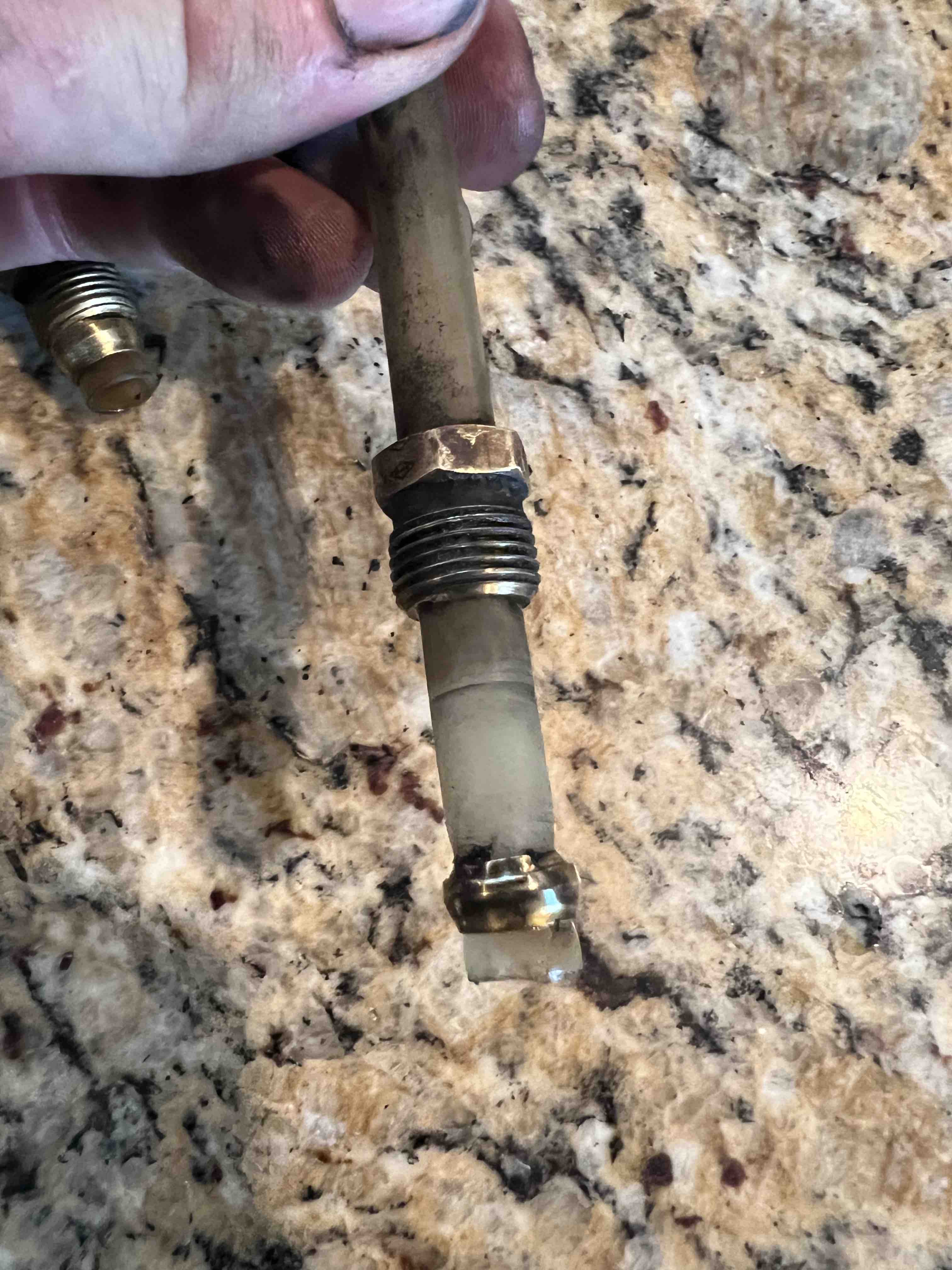

Identified the fuel leak in the line running from the side of the injection pump to the rear of the fuel filter

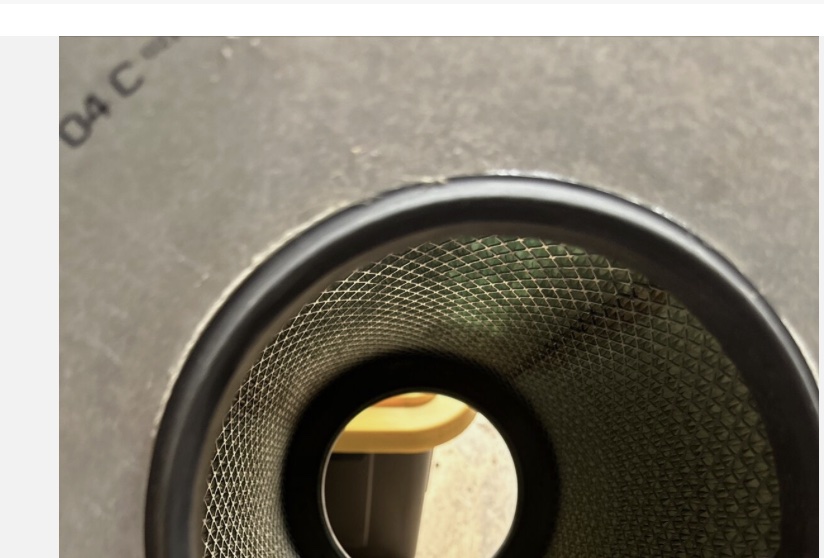

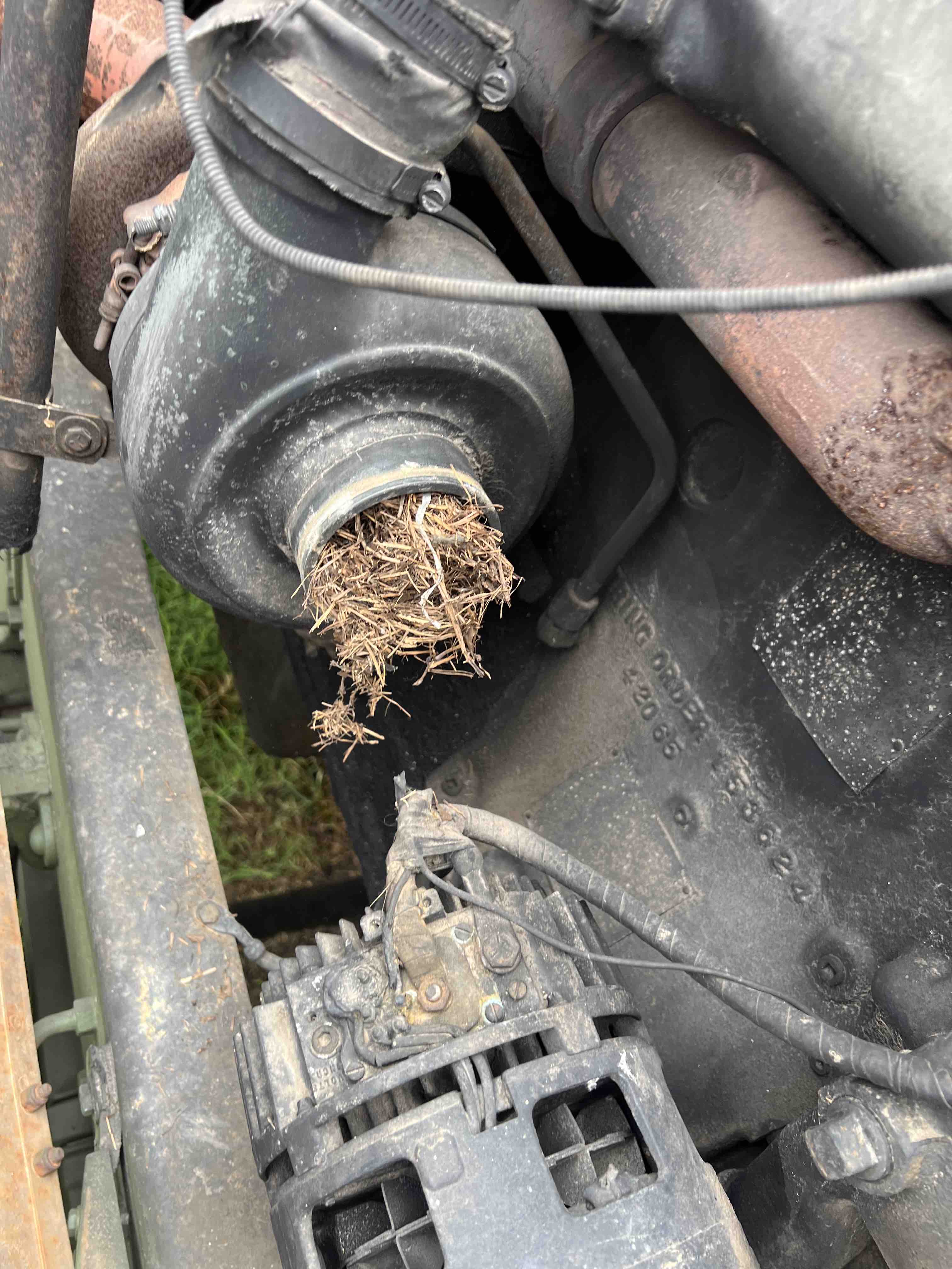

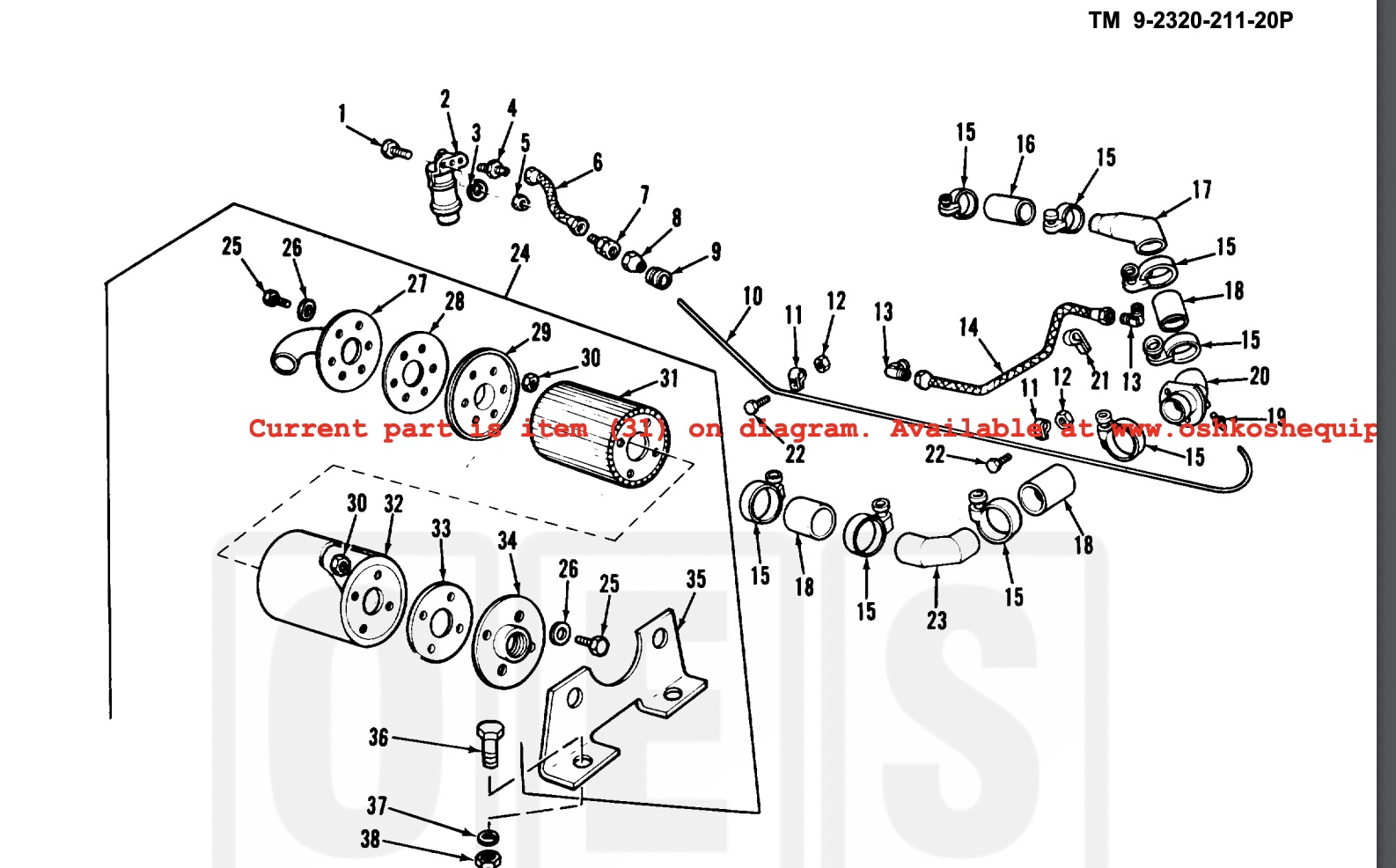

I discovered a missing air filter. Hopefully, the cylinder walls are not trashed from grit.
