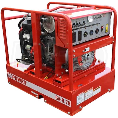

Example, same cost as the Honda, but open frame, 8400 watts rated continuous, Honda Industrial engine. Basically an industrial/commercial generator design. Multiquip is a brand that you see for a lot of rental generators and industrial sites, not so much consumer. Downside is it's made to order, and non-engine parts aren't as easily available is the main downside.

That one you linked looks pretty great! Shame its made to order. I could build a pretty nice enclosure around that!
