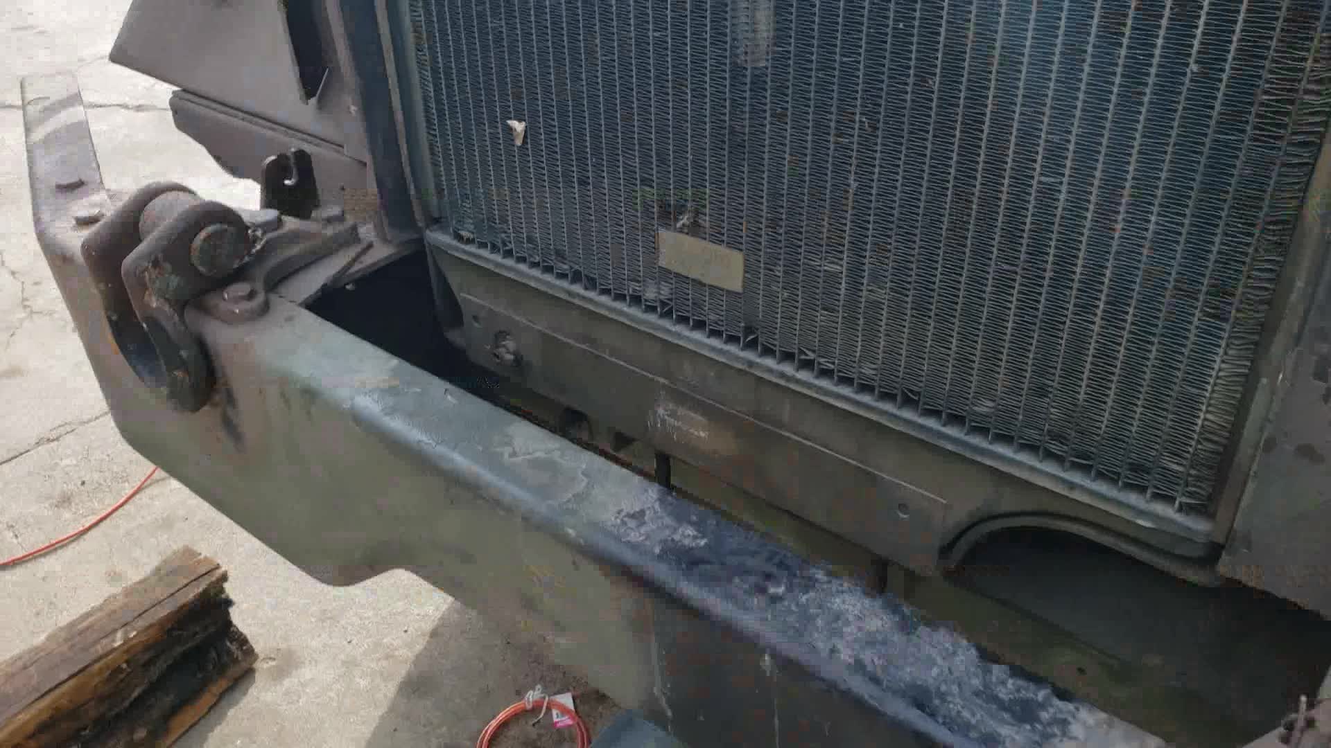

Cylinder Liner broken pieces in oil pan
martinv
50
58
Glyndon MN
The cylinder liner at the front of the engine broke up and also took out the piston oil jet tube thing.
Has anyone here done this repair and how did it go?
Part 1: The noise it makes (I believe this is after most or all of the liner broke up):

Very sorry to hear that... From what I remember, seems most agree that it's better to just replace the engine, as little bits may have been pumped through the oil and can find their way into other components, as well as the unknown mechanical stresses that other components may have been exposed to during the failure.

You can get a piston and liner and do it in frame, pulling head and oil pan.
Before buying any parts I'd open the engine up and see what's what. There is a risk of metal having gone elsewhere and clearly you'd take a good look at the mains with the pan off and any other carnage you can find. I'd probably check the turbo and blow the oil lines out with shop air.
The oil pickup has a screen and the oil filters do their part...may be worth rolling the dice if everything else looks ok.
At the bare minimum, piston and liner can be had for $150 a hole. Oil squirter maybe $50, dunno. Headgasket is about $90, other gaskets and assorted stuff..maybe another $200. That's assuming nothing else needs fixing and you don't decide to do more just because you have it open
How much can you get a good running takeout engine for? What's your time worth? How lucky do you feel?
P.S check the classifieds for a long block that was running, for less than a piston and liner cost...

The first step is to disassemble as far as necessary to find out what all is damaged. Then depending on the damage, decide how involved you want to get with repairs.
I had a damaged piston and liner in mine. I just replaced them with a used take-out piston and liner from a member here. That was maybe 1,000 miles ago, and so far so good.

Thanks for the replies and good info. Disassembly is in progress. My plan is to do some inspection and figure out if any more damage exists. So far i'm leaning toward repairing it. I ran a tiny camera into the injector port and could see some chunks on top of the piston also as expected. I will pull the head off and inspect closer. Short video clip compilation here:

Fairly consistent, but louder than normal, followed by inconsistent banging, clanging. The noise seems to agree with the liner issue for 1 piston. My guess is the liner was damaged partially at first but still mostly in place. After idling a couple minutes it slid down and broke up completely causing the sudden change in sound to a more inconsistent metal clanging sound as it broke up. After this sequence happened twice, I restarted the vehicle so I could move it to my driveway for repair and it seemed odd at the time that the sound was no longer the loud clanging although it was louder than a normal engine sound (shown in the video).
If I recall correctly the sequence was:
1. Startup, seemed OK,
2. After about 1-2 minutes, sudden clanging, banging started.
3. Quickly shut off vehicle.
4. Think for a few minutes. Contemplating if repairing the vehicle will be as enjoyable as driving it for the summer.
5. Start vehicle to see if noise is still present and noise at first was surprisingly closer to normal.
6. Louder noise came back.
7. Shut off vehicle.
8. Decide to risk driving the vehicle onto my driveway for inspection repair.
9. While driving the noise didn't seem as horrible. This may be because the entire liner had already completed its journey to the oil pan.

UPDATE 4-10-2021: I got a NOS cylinder liner kit that included a piston, piston pin, rings pre-installed, and even the piston cooling nozzle oil jet assembly.
