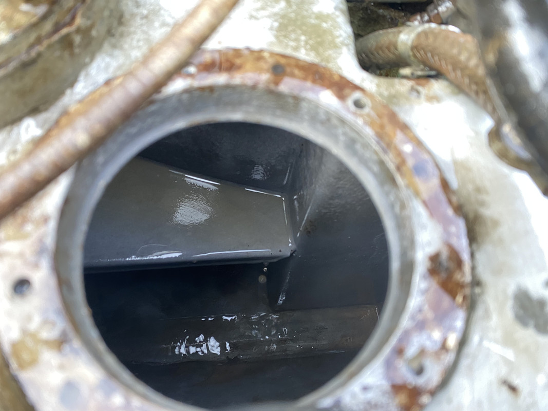

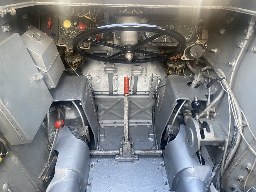

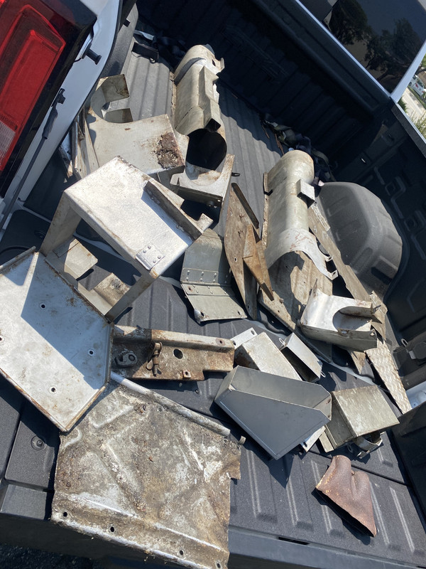

Finished the partial interior cleaning - stripped all the tin work and blasted/painted. The color isn’t a good match which is a bummer…hopefully when it gets dirty it’ll blend in more. I scraped at least 40 pounds of oil sludge from the fighting compartment.

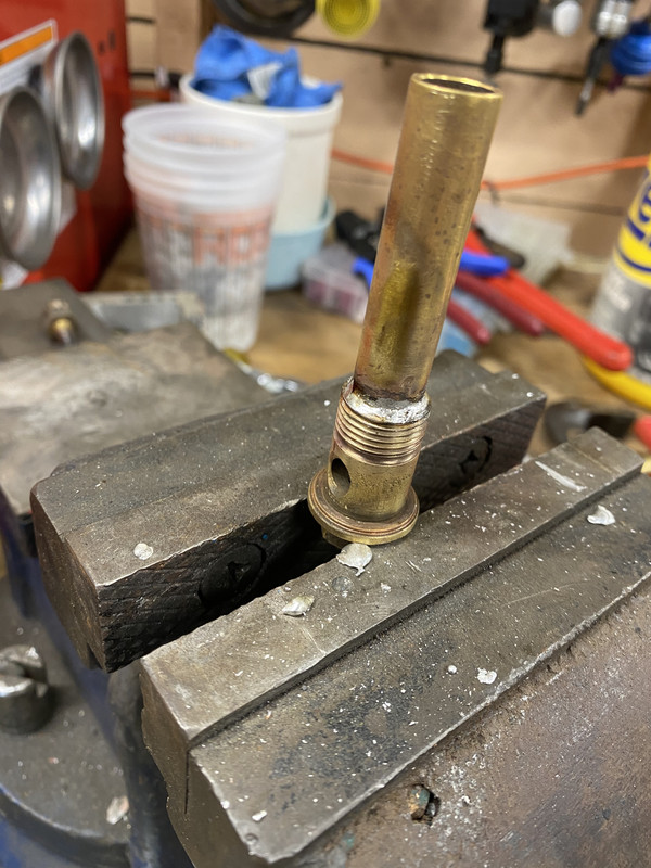

-cleaned fuel tank with vinegar and did the REME mod to the fittings. It was a big step to have her run off her own tank! Was originally bypassed and running off a gas can. I trimmed the tube down a bit from the length pictured. Banjo fitting was completely plugged when removed.
