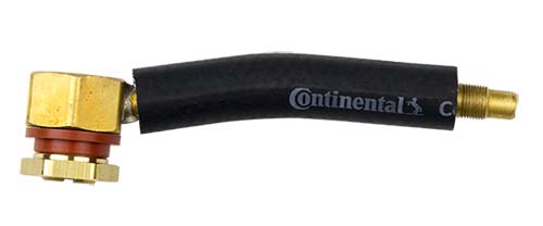

OK....... actual solution for when:
. you want to remove citis valves off of M1082 trailer to use on truck......
. if you get ctis leak issue (valve, kneeling elbow, hose leak etc.)
. Truck's wheel wheel ctis leak is so bad your engine compressor is going NUTS trying to compensate for the fast air loss. (this scenario will need a solid bolt to replace banjo bolt..... keep one on hand. It is a fine thread 5/8-18 X 1 1/2. There is suppose to be one in your spare tire.
. You are putting FMTV wheels on another axle that does NOT have CTIS
Basics-
. block axle so it cant drop as tire deflates (optional but smart)
. deflate tire by removing valve core from ctis valve. Protect core from flying away.. you are going to re-use it.
. remove valves, hoses etc. from wheel.
. use a Standard valve core in the ctis tube (rob it from ctis valve)
. Put solid bolt replacing OEM banjo bolt. bolt should be in your spare tire.... it is 5/8-18 X 1 1/2 (fine thread) (not needed on trailer delete)
. use a PLASTIC valve stem extender as your means to fit a standard air chuck for airing up/down
Details-This is what I have done successfully now on a trailer. YMMV
On tire(s) dealing with today.. TW0 of my Wheel's metal air tube; aka Schrader Valve stems (one from a 1078 truck... one from a M1082 trailer) both are ones that look same as picture linked below, both no external threads first 3/8? inch. Also on both; the standard automotive Valve core screwed in tightly but was not deep like Acela said. Difference may be manufacture of the Schrader Valve . The Hutchinson version (who makes the wheel both aluminum and steel) Im guessing is the one with deeper into the tubes valve core threads found on some FMTV wheels . Guessing this is the Schrader Valve stem Oshkosh sells. Must have been what is on the trucks the Acela employee came across often. That is who told me about the deep recessed valve cores. Maybe mine are a Haltec tube and theirs Oskosh?
Haltec version
As others noted though...... Now an air chuck wont fit.. unless you get a special one (Haltec chuck mentioned in earlier post) BUT--
TADA: FOUND INEXPENSIVE SOLUTION that makes standard chuck fit without need for uncommon chuck and it only cost two bucks.
take one of the above and "TEMPORARILY" force fit / screw it on. It's soft-ish plastic so it threads a little in place. Doubt it would stay with driving as I can pull it off without too much effort. Yet... it still goes on just enough to work for filling the tire with a standard air chuck. AND...... was able to unscrew and screw it back on several times and it still stayed on enough to fill the tire with air. The chuck also will stay on the extender as you go about what every you have to do (put up tools??) that is of course if it is a clampish on-ish type chuck.
PROBLEM SOLVED.....

ok... so now..... since the valve core on the two I've done do NOT end up deep in the tube.... but actually the push pin for fill/release air is slightly exposed....
Thus...... need a cover to prevent unintentional pin push ..... yet a standard "metal" Schrader valve cap does not fit..... so what to do....
1. it has been "reported"...(sic) a plastic schrader valve stem cap can sorta be forced to fit similar to my valve extension hack ( eeekkkk "reported" has screwed me many times though; as the follies of this thread expose, sooooo try at your own risk)
2. thread 'with a tap, the end of the stem that does not have threads to match a common to find acorn nut. (the diameter of the tube is different OD as used for a valve stem cap is my understanding.... otherwise id say thread it for that.... but hey......... try it and report back in here!!!
3. using spacers..... take the citis valve mount plate and its nuts you removed.... along with home brewed spacers; put plate on necessary beadlock ring bolts to cover the thing. Would be a PITA to remove it to release/fill air....... but it can't accidentally get pin pushed and air released either. Maybe drill an access hole?
