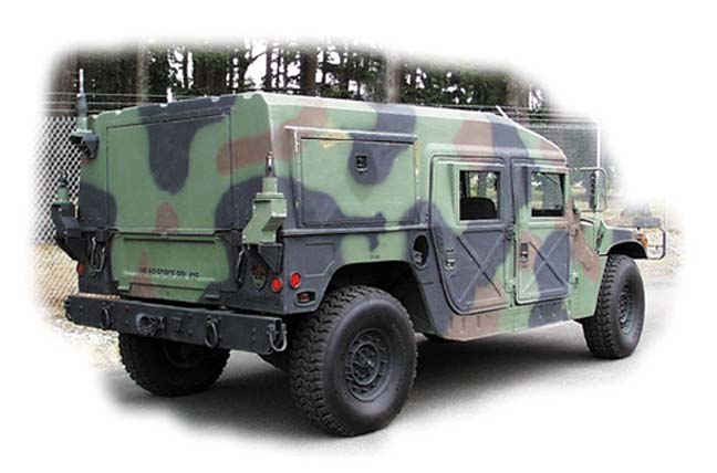

How hard is it to install a helmet top on a ragtop m1123. Does it just bolt right on or do you have to switch out windshield frames etc
will bolt right on.
I don't think you have to remove the channel for the soft top at the front of the frame, but it's been a few years so don't remember exactly.

You’ll need to remove the soft top channel from the windshield and the C pillar.
Installation instructions, for the Amtech tops, is the whole way at the bottom of the page here:

Make sure the rear side and rear "lips" are tight against the rear of the body, you may have to put a ratchet strap across the back to pull the bottom of the helmet top together so it fits tight against the body before drilling the holes for the rear mounts.

I just installed one. It's relatively easy. Just make sure everything is aligned before you drill any mounting holes.
