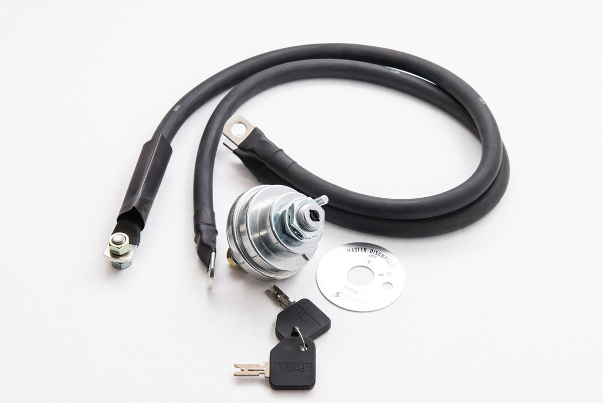

Does anyone have recommendations for a reliable keyed battery disconnect?
This is the one I installed. Have it installed right above the transmission diagnostic port.
For a little less, they have one for the passenger side mounting, but can't reach it from driver's side.

Doesn't someone make a keyed switch that looks just like (and I believe replaces) the standard large ignition switch?
That would keep a stock appearance.
