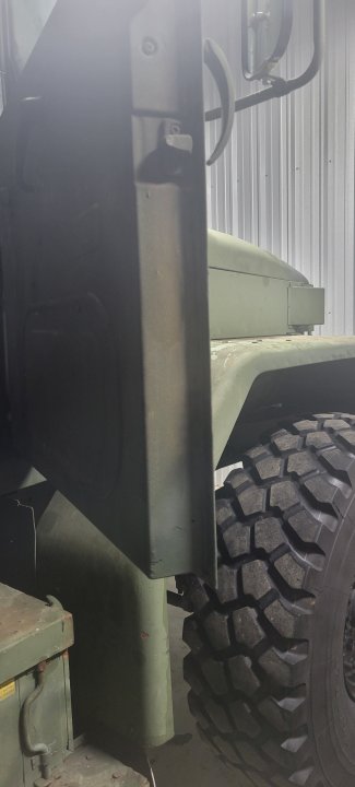

How well do the windows mate up with it?
Not that great if close the door with the windows up already. If I close the windows while the door is shut the seal in the corners are much better. I figured that was to be expected. I'm just gonna put some additional weather stripping to block the gaps

The hard top on my M813 like yours doesn't fit all that good either. Rolling up the windows to seal? Nope they don't seal so well. So what, lol. Not a deal breaker at all for me. The only way I could consider this "seal" to bet better would be to spend a serious amount of time to make a frame for the door that the window rolls up into and that frame then seals to the top.

Yup I'm not too worried about it. I'm gonna use some seam sealer to get it all sealed up. I was thinking about making what you described for the windows but I'm not sure when I'll get to it. I'm just happy to have a hard top!

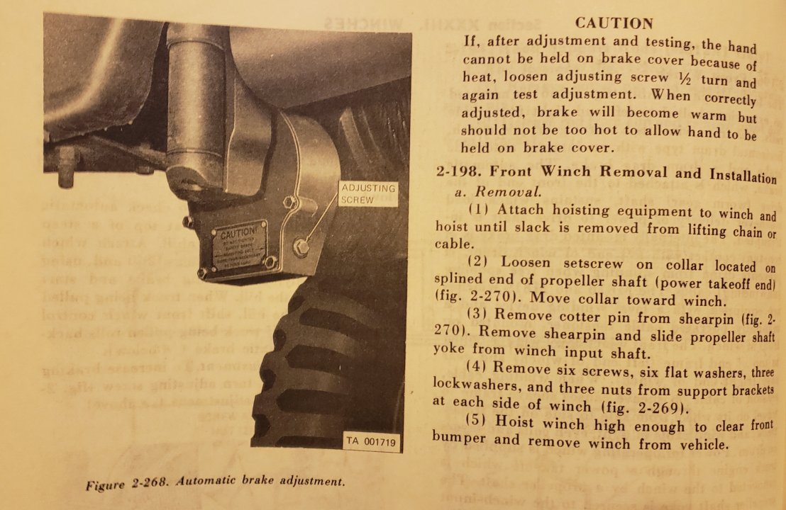

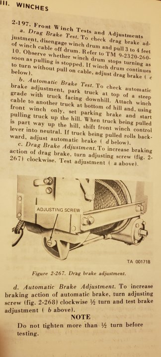

The winch operation on the truck is definitely interesting. Impossible to push the clutch lever on the winch back to the disengaged position when you're pulling something I figured out. And I'm not so sure my brake for my drum is working either as it still rotates when I rotate it by hand.

I am still short on funds to get my winch set up finished. Still need the driveshaft, linkages, cable, cable chain loop, and frame extensions. I'll ask my friend who has a lot of winch experience with these on your thoughts of the operation as a brake is very important when using a winch. I was not aware that there was no brake function, but... the PTO is amazing to be able to pull all day and not have to worry about batteries melting. All my electric WARN winches I have used had an excellent brake. If these units don't have anything like it I may consider selling my winch with the level wind and PTO and start hunting for a 18K Warn electric or 20K or 30K hydraulic.

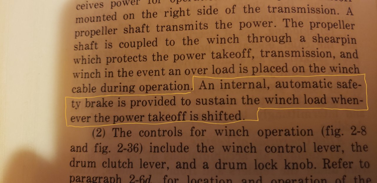

Maybe I'm confused as to what the brake should do as I have no winch experience. The winch when unwinding does brake itself if I pull the cable out too fast it seems. What I meant is when the winch is not in use I've accidentally stepped on the drum and spun it which I thought the brake would prevent?

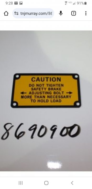

Also my winch was added on to my truck hence it being red so I have no data plates sadly.

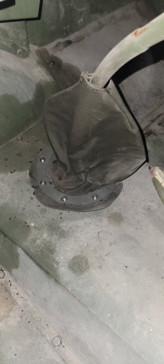

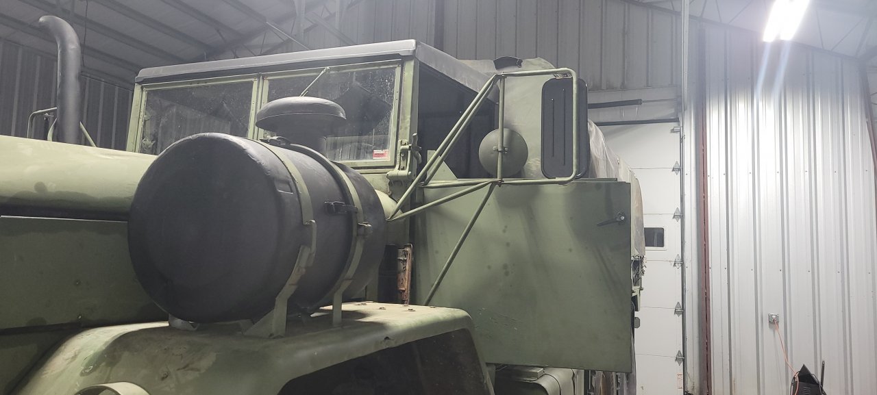

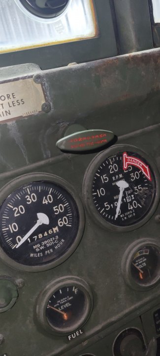

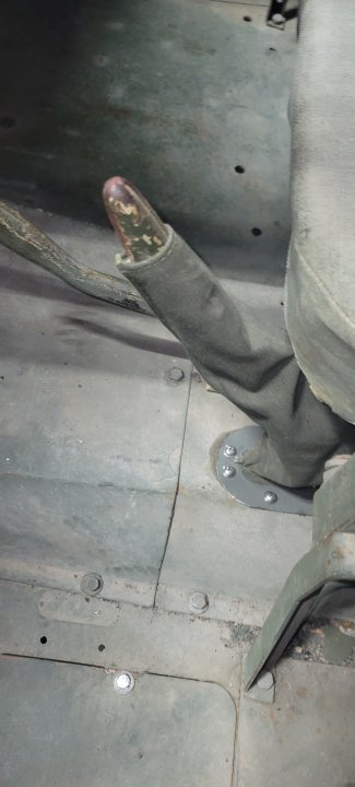

Here's some pictures of what I've accomplished over the past few weeks. I installed the artic boot kits, painted my air box black, got the black mirrors installed, and installed the emergency engine stop (mine was missing)
Edit- I also painted the exhaust stack black

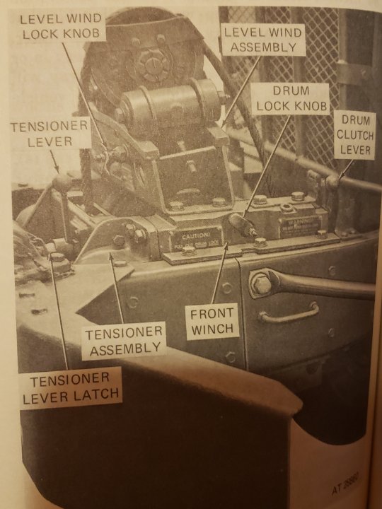

To keep the drum from freely spinning the drum lock knob on the driver side has to engaged. It has a pin that protrudes into one of many slots in the drum side flange.
The brake holds the load when the clutch is depressed and cuts out the PTO power.

I would suggest reading up on the winch functionality in TM-9-2320-260-10 found in the TM download section - it's good reading!
And check with Eastern Surplus or TNJ Murray for the missing data plates.

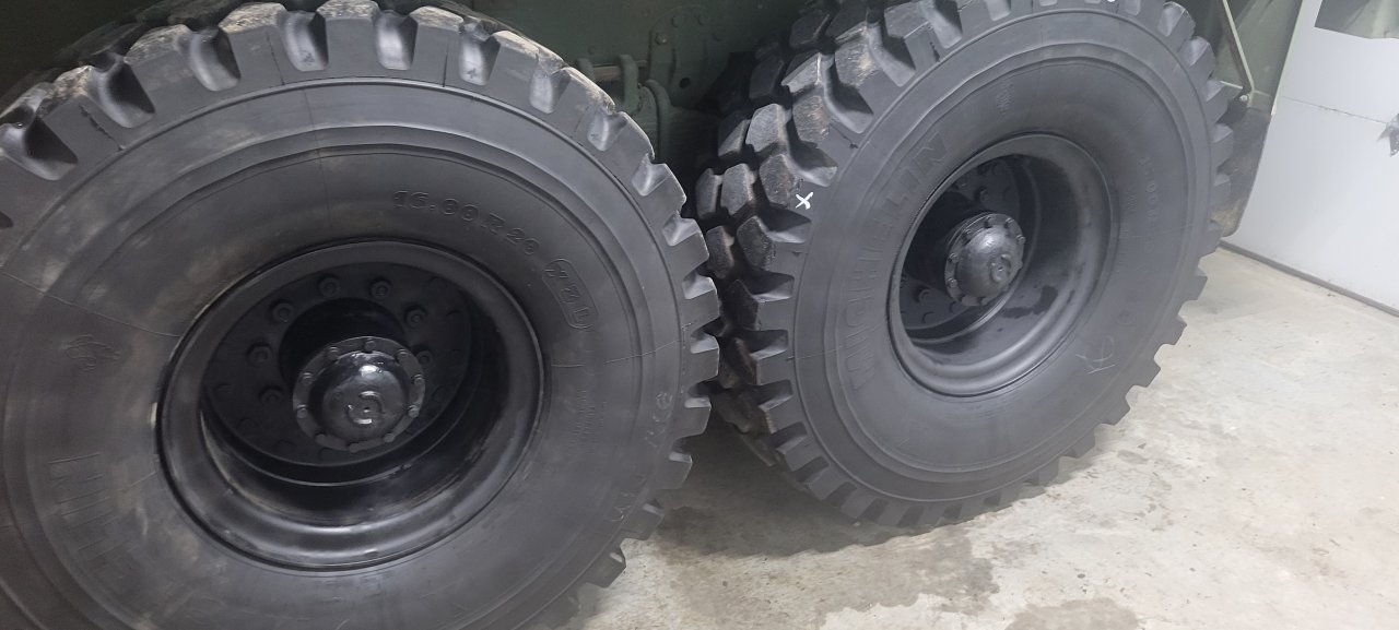

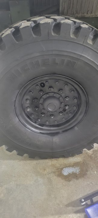

I got all the wheels painted black and cleaned the grime off the tires and got them tire shined black as well. I also got all the door weather stripping off and the rust sanded down and painted. Probably am not going to reuse the metal tabs and screws to hold down the new weather stripping as most of them all falling apart. I'll just use adhesive. I also installed big Mike's brake reservoir too.
