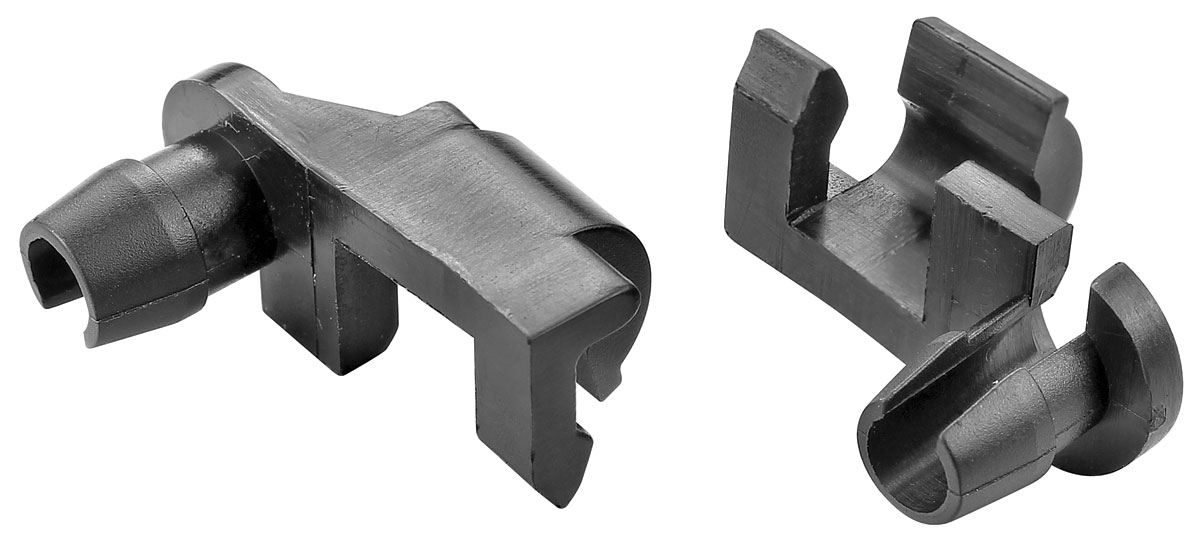

One other problem is: I don’t know how or where to attach the Insulator Rod on the drivers side. I don’t know where it goes or how exactly to attach it. *Pics below

The rod will clip into a plastic retainer and should stay in place.
Dorman Door Lock Rod Clip 75451
Clips, Door Lock Rod, 64-72 A-Body @ OPGI.com
Something similar to these. Use oil and grease on the crank driver and regulator and clean the sash roller guides and grease them. Getting everything shiny clean and greased is key to keeping the rear window happy and operational. Spray lubes are worthless for this application and IMHO most applications. Good old oil and grease work best on the old vehicles that have lots of metal parts moving against each other. Good Luck and report back on your progress. I have a trim Lock material I use in the side guides. You can see my tailgate rebuilding in my Terminus M1009 thread. Take Care.

"One other problem is: I don’t know how or where to attach the Insulator Rod on the drivers side. I don’t know where it goes or how exactly to attach it. *Pics below"
That rod is for the latch release and snaps into a retainer like CUCVUS showed on the backside of the inner handle, the clip is probably broken and laying in the bottom of the gate.

Amazon.com: Dorman 75450 Door Lock Rod Clip Assortment for Select Models: Automotive
This will get you an assortment of clips. I have a window to work on in the next few days. Of course I will post pictures. They will be in my CUCVRUS repair projects thread. Take care. Look in behind the inside release handle there will be an eccentric that pulls inward when you are pulling the inside handle. I will post pictures if you don't find it. Good Luck.
Hello Again CCCVRUS! Thank you for all of this information and the link. I’m going to order them now. If you are able to please take any photos I would greatly appreciate it. I’m still getting familiar with where everything goes.
I just received the box of assorted clips. I’m going to take a look in the tailgate, hopefully in the morning. I hope I can figure out how to hook the rod into the clip. I’ll send an update soon.
