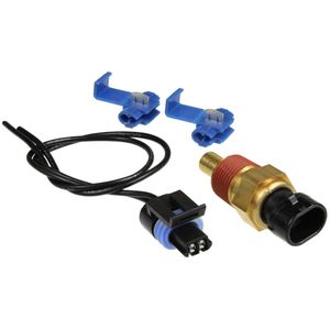

M1009 temp sensor
Looking for a replacement temp sensor for the glow plugs on my M1009. I can find the new style with the replacement pig tail, but have not found the original style. Any help would be great.
cucvrus
11,475
10,455
Jonestown Pennsylvania
Just use the new style. Is there a reason you don't want the new style? I have a couple old style used. No new ones like it. I know they worked but could not warrant them.
Warthog
13,774
236
OKC, OK
I've posted the replacement part number for the old style many times. Can't remember if it is in the stickies or not.
MAZ537
166
23
EU
This is the old style CoolantTempSensor
Part Number: ECH TS4032
$19.49
Part Number: MPE TS4032SB -- This is also available at ebay --
$13.99
Both seems out of stock at NAPA...
Found one here :
http://www.2040-parts.com/echlin-ignition-parts-ech-ts4032-coolant-temp-sensor-i1107277/
