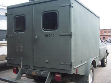

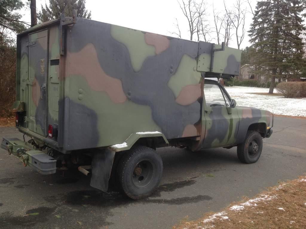

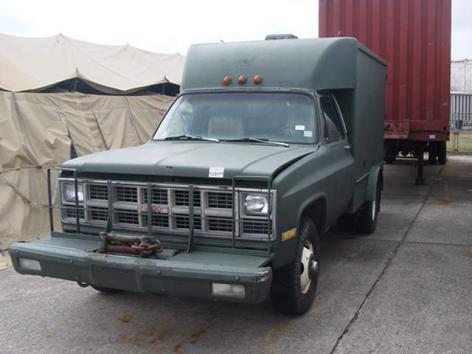

I'm assuming this is the truck, from ECR CUCV.
These fiberglass shelters are very cool, that's the only one I've seen still on a truck. I've seen 3 others but they were removed from the trucks before being sold. 2 of them were sold from Camp Johnson in Colchester, VT probably 6-8 years ago and another was at a surplus dealer in Colchester. I owned 2 of those 3 but never did anything with them. According to ECR CUCV your truck was from VT as well.
m715
237
western ma.
That is the truck,not home yet will try to post photos with help. I type two slow says to refresh page. The truck needs a starter and flex plate, then find the cause of no fuel to injectors.

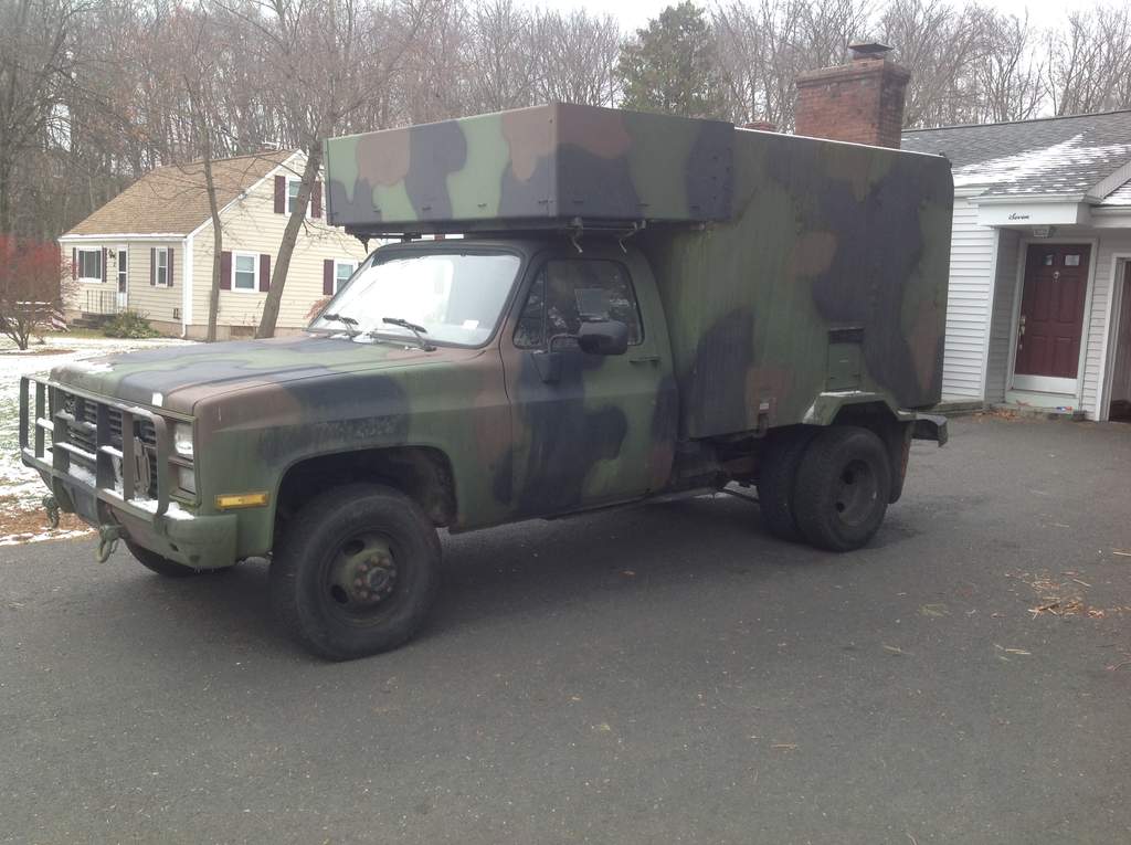

I got the truck home and had a chance to look it over . I had my daughter take photos of the truck and the tags we hope to post them shortly. I cleared a bunch of scrap lumber from the box and finely got to go inside it.
m715
237
western ma.
I was able to partly remove the starter and see the flex plate teeth. I found the starter brace was missing. I was unable to remove the inspection cover, The bolts would not budge, they may have been Loctite. The teeth that I can see don't look bad but I need to turn the engine over.
