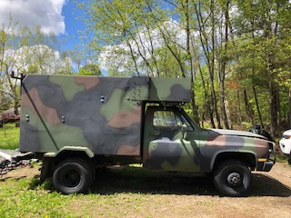

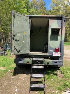

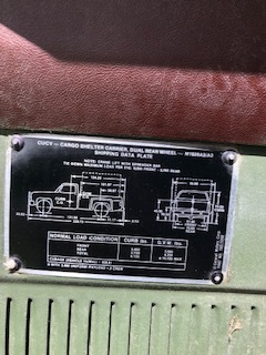

I got the truck home and had a chance to look it over . I had my daughter take photos of the truck and the tags we hope to post them shortly. I cleared a bunch of scrap lumber from the box and finely got to go inside it.

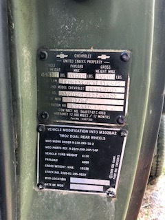

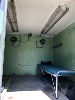

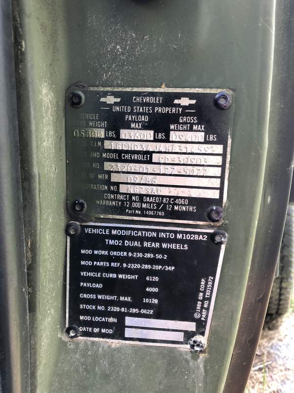

This truck has a np208 transfer case, per tag on case. I want to install camper windows on box, but dont know how thick the walls are on the fiberglass box.
